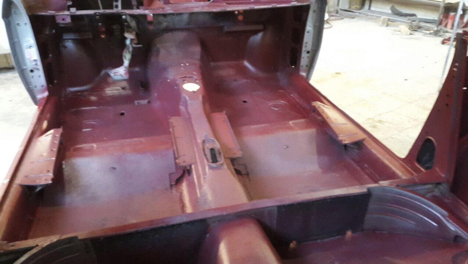

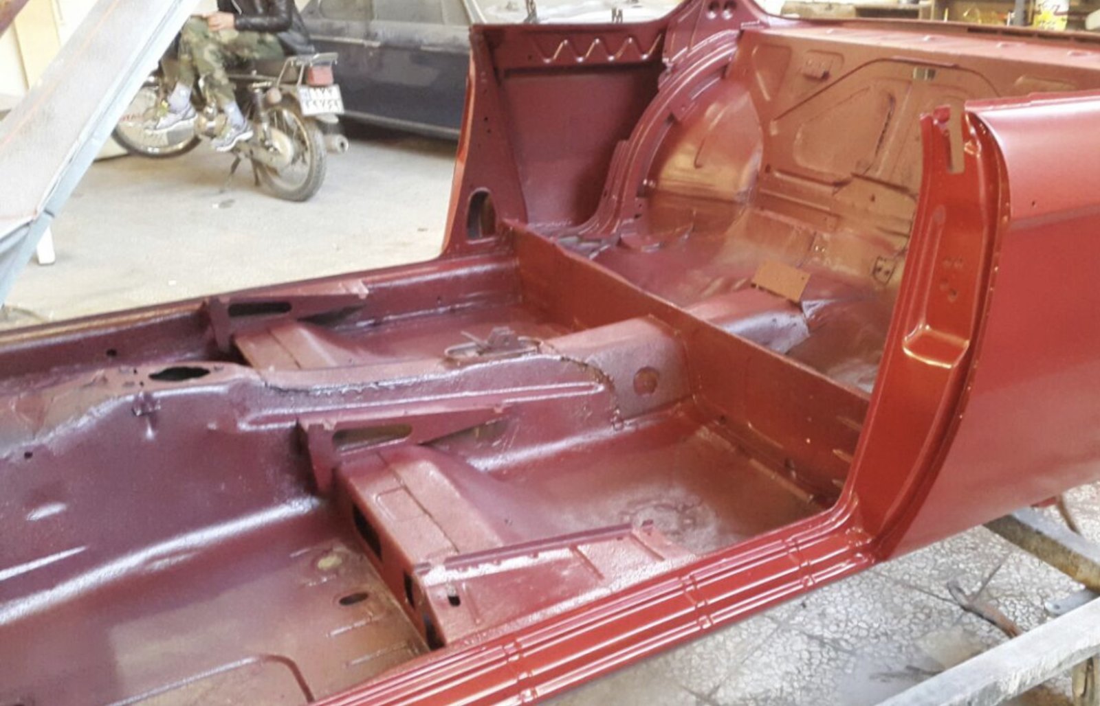

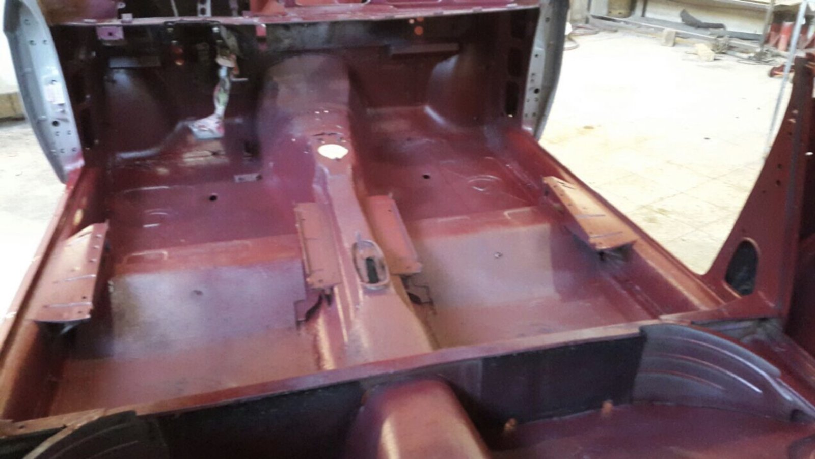

I am planning to go from my aftermarket Flo-Fit seats back to stock. My floor, from what I can see, looks like the mechanism in the floor has been modified in order for the aftermarket seat tracks to be put in. I still have the release lever.

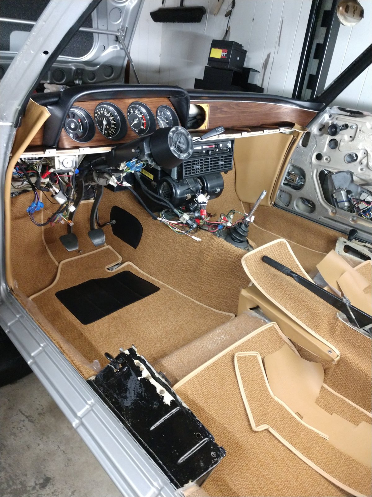

Does anyone have a photo of what their seat base/ floor looks like when the seats are out?
My car is in the shop and I will post pics of what it looks like ASAP
Best Wishes

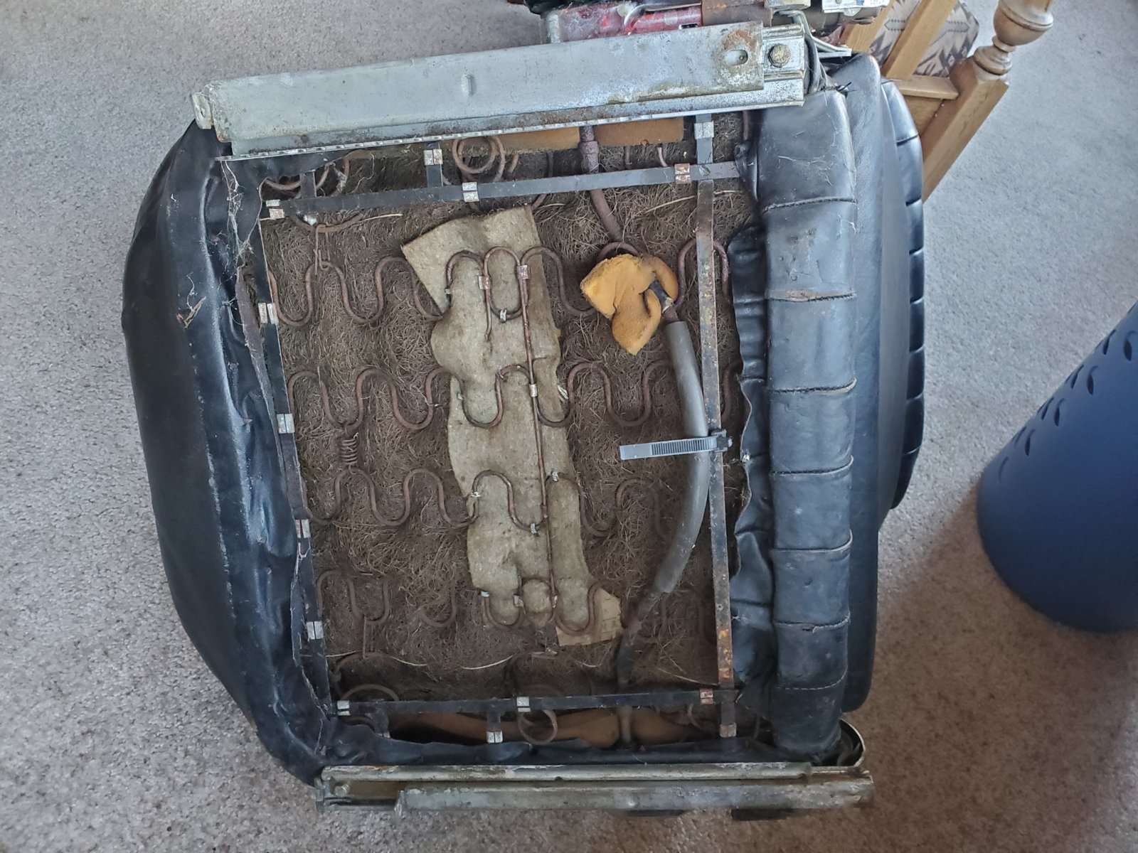

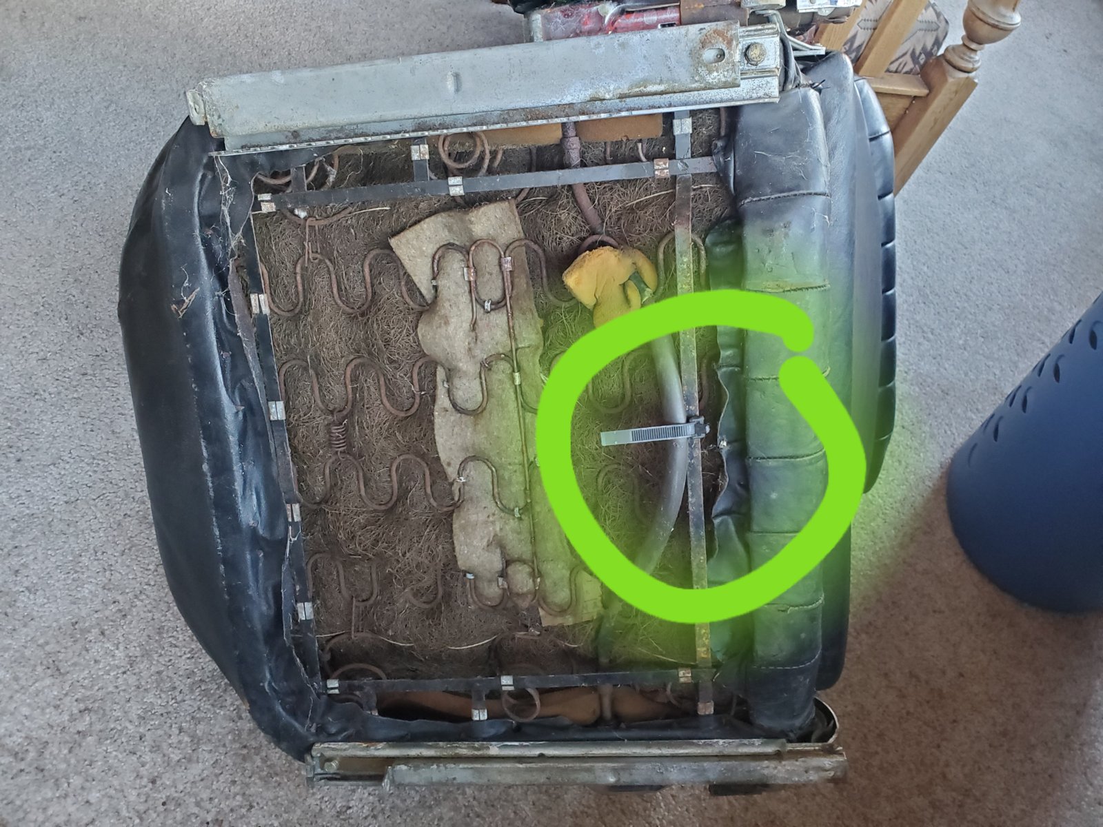

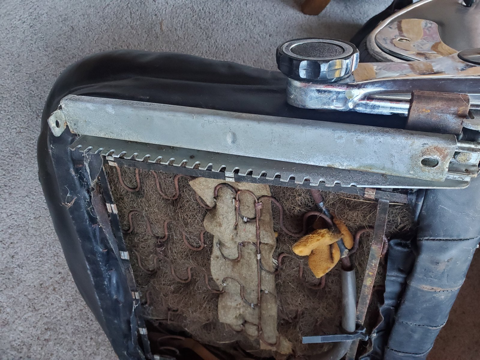

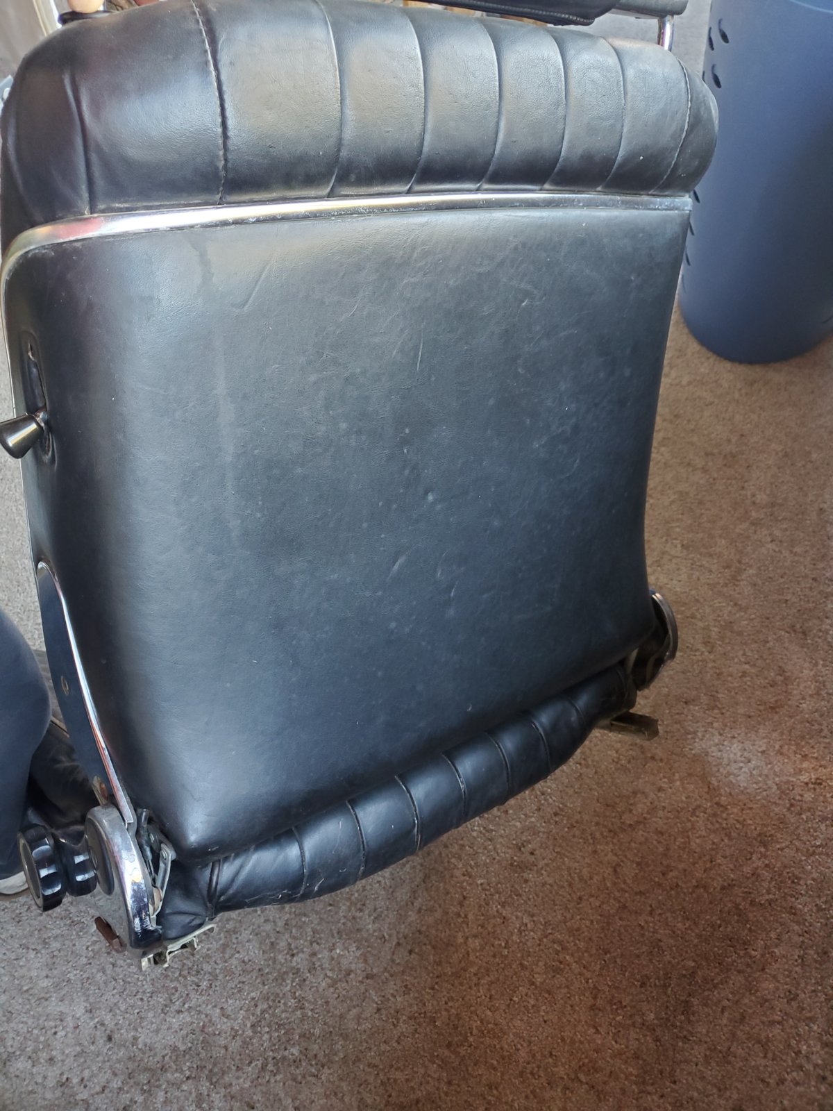

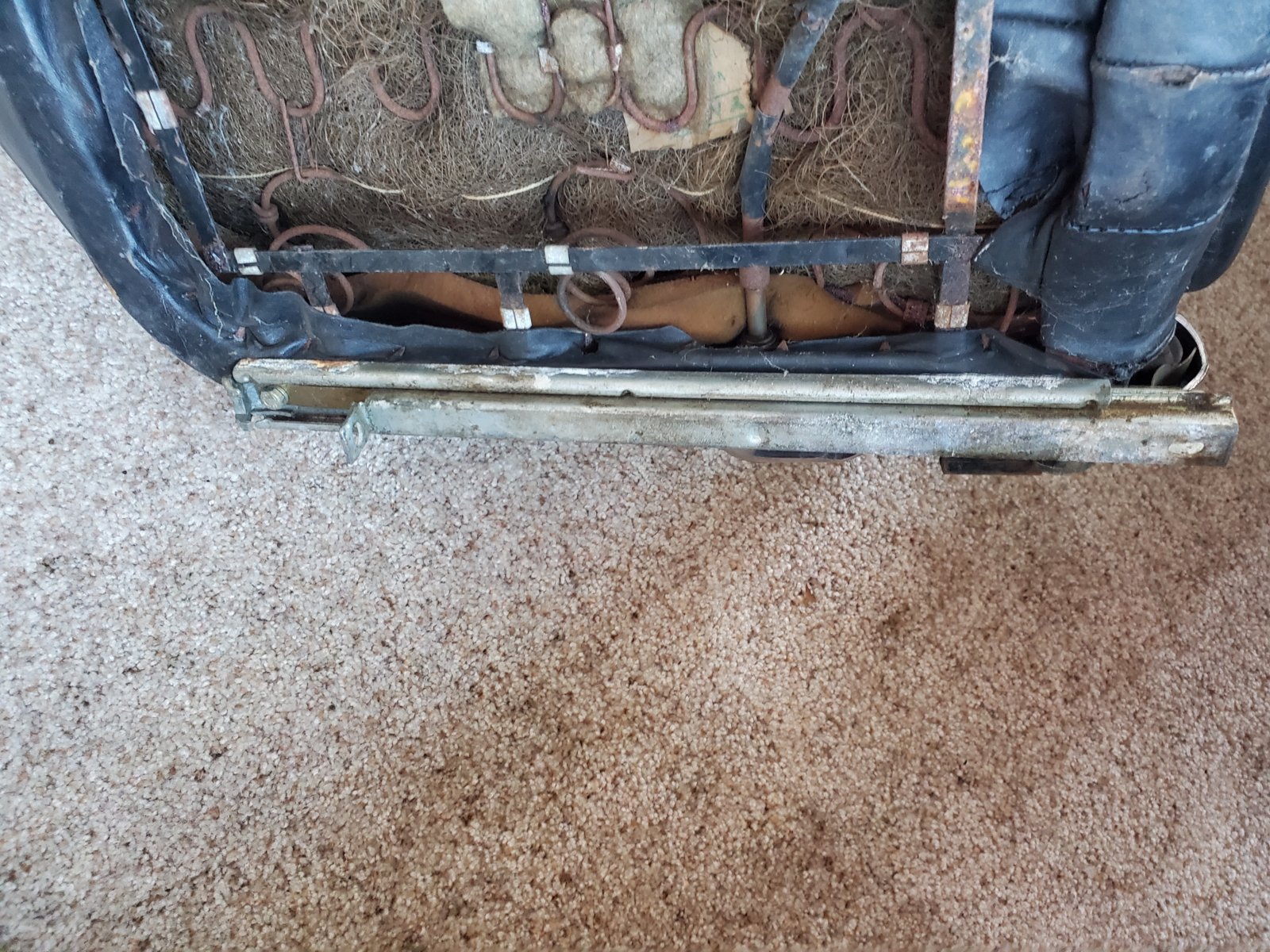

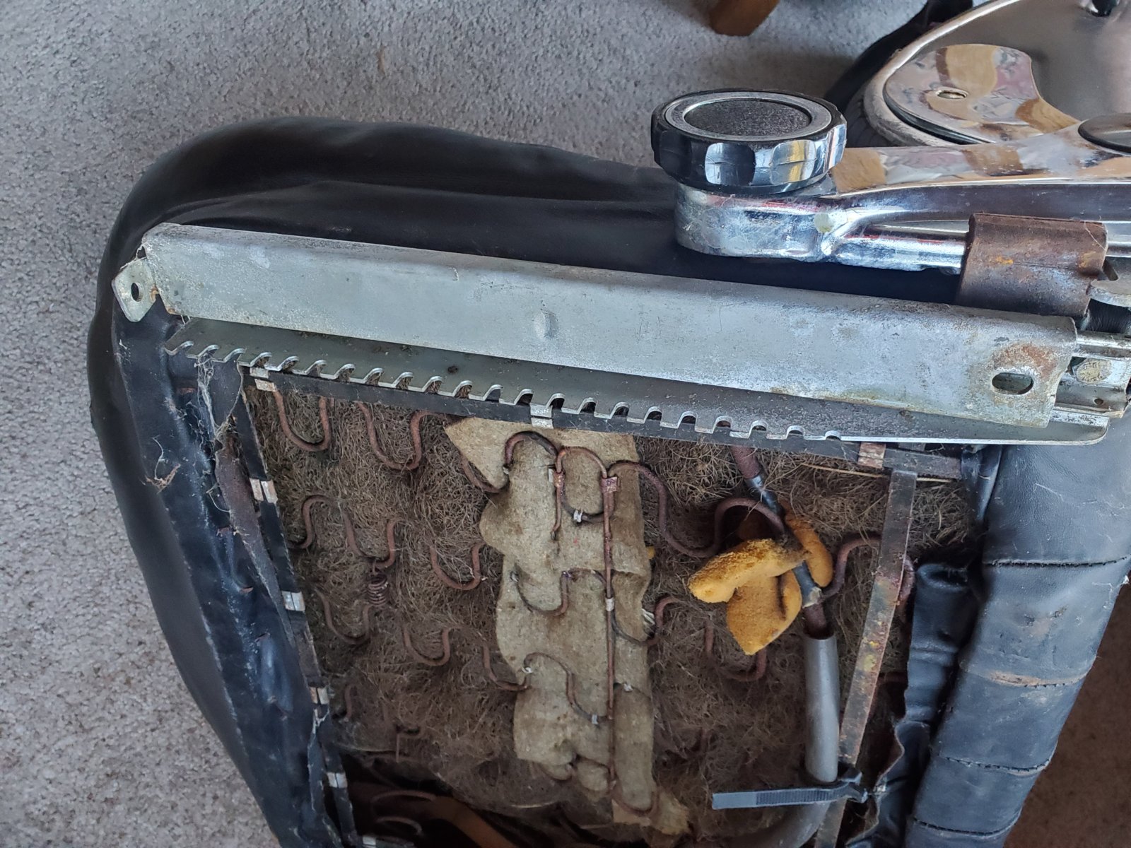

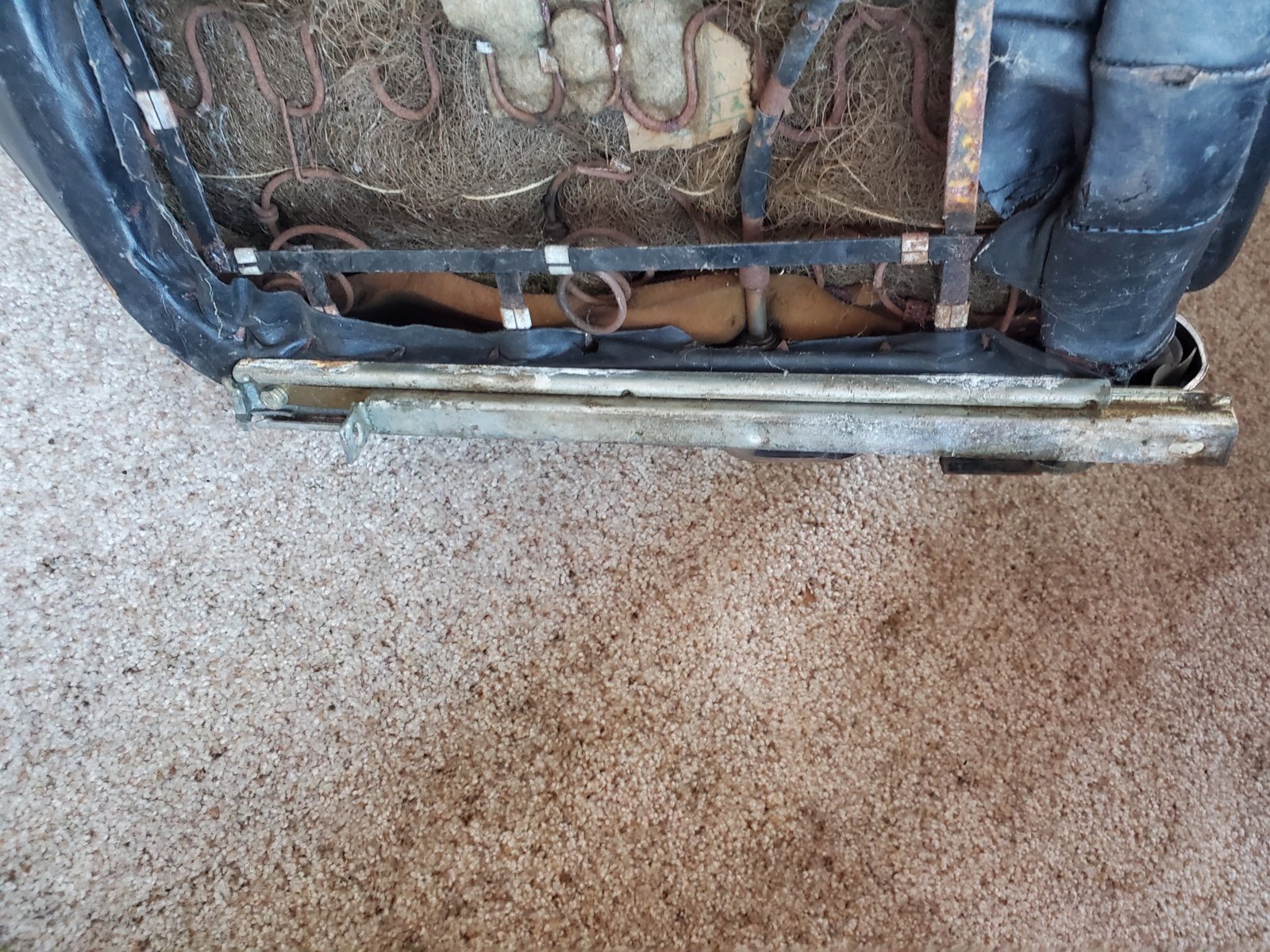

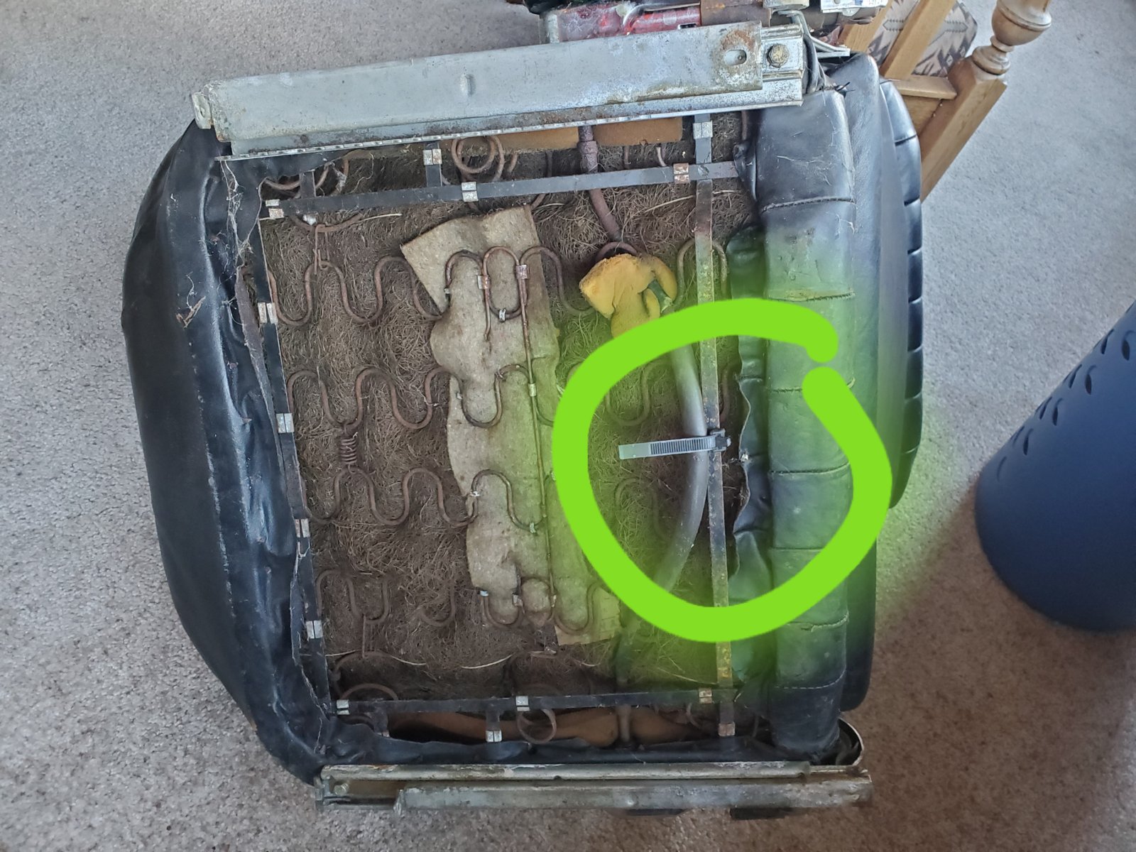

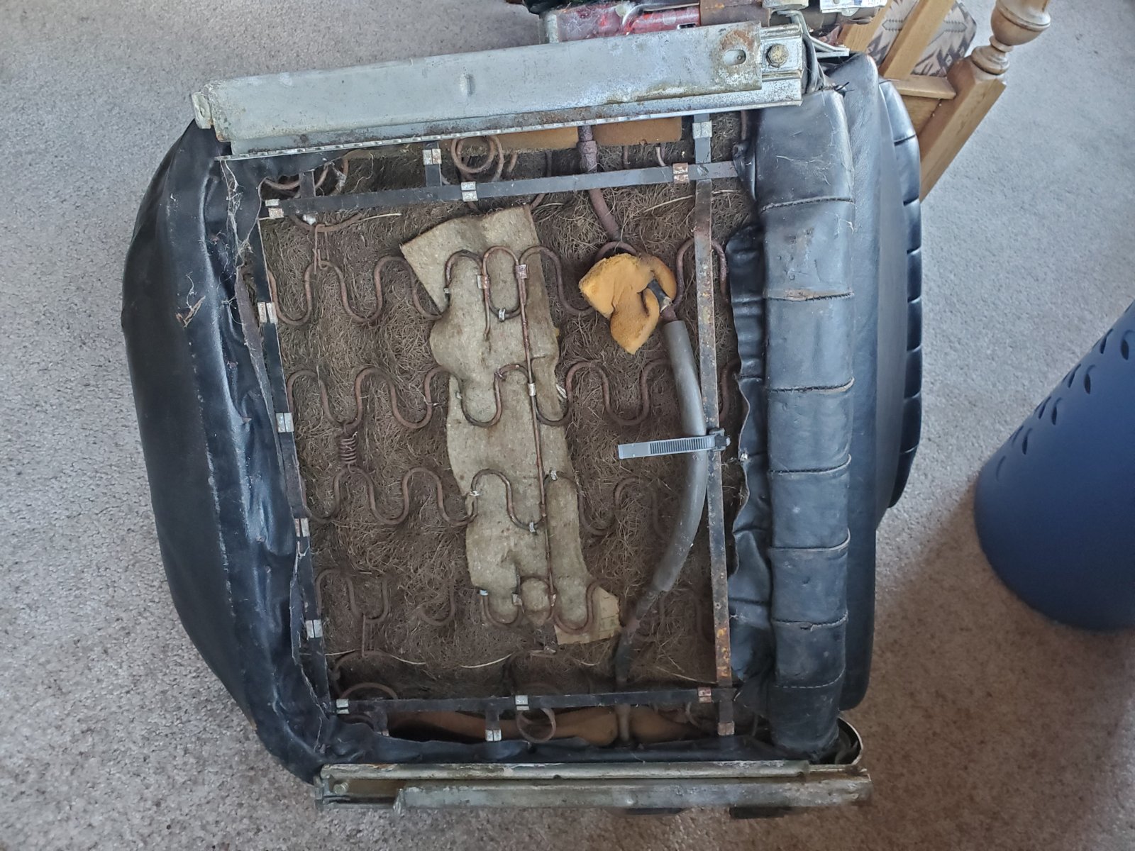

Thanks for the photos. Here is a photo of the bottom of my stock seats. Do they look complete? I don't see how the seat track connects with the base, regarding the movement back and forth of the seat?

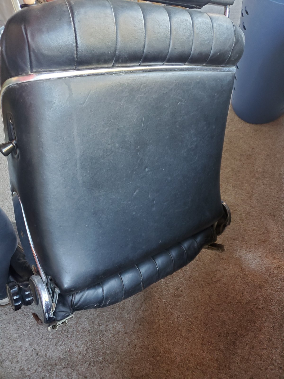

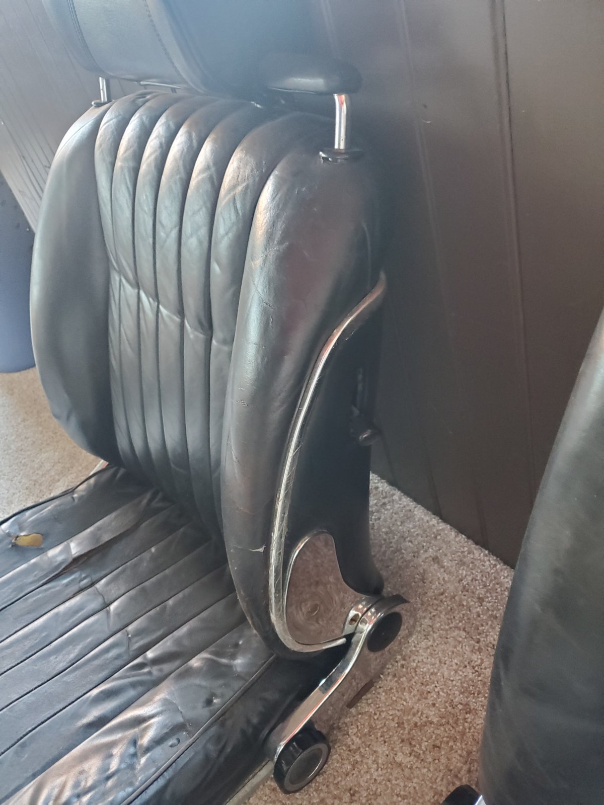

come by and pick up your sunroof seals today and you can look at 10 cars and 20 seats!
I’ll be there from 10:00 - 1:00
Also,

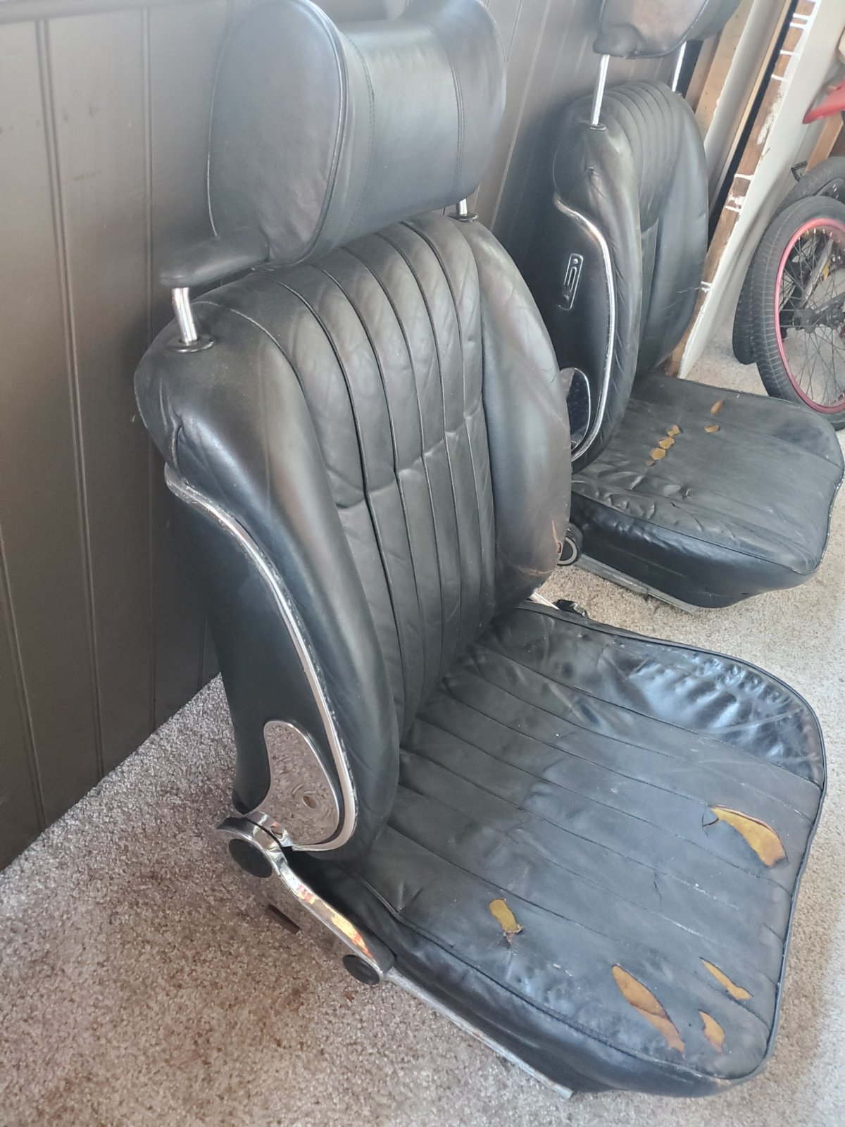

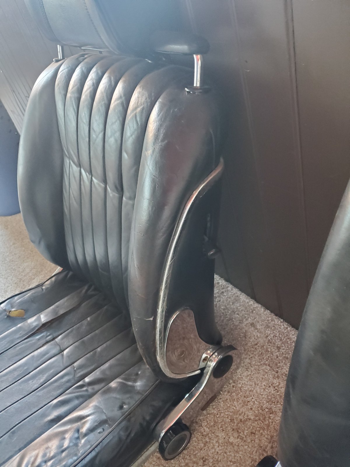

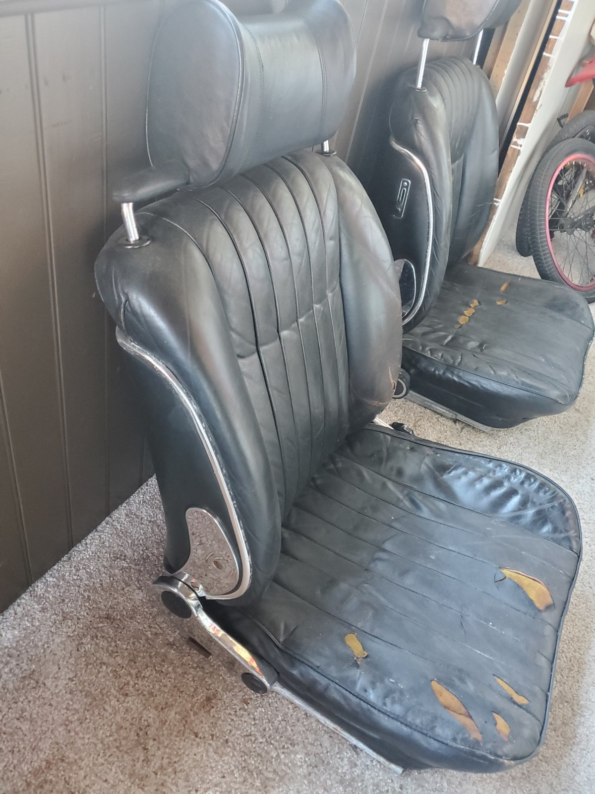

Are these correct 1972 E9 seats?

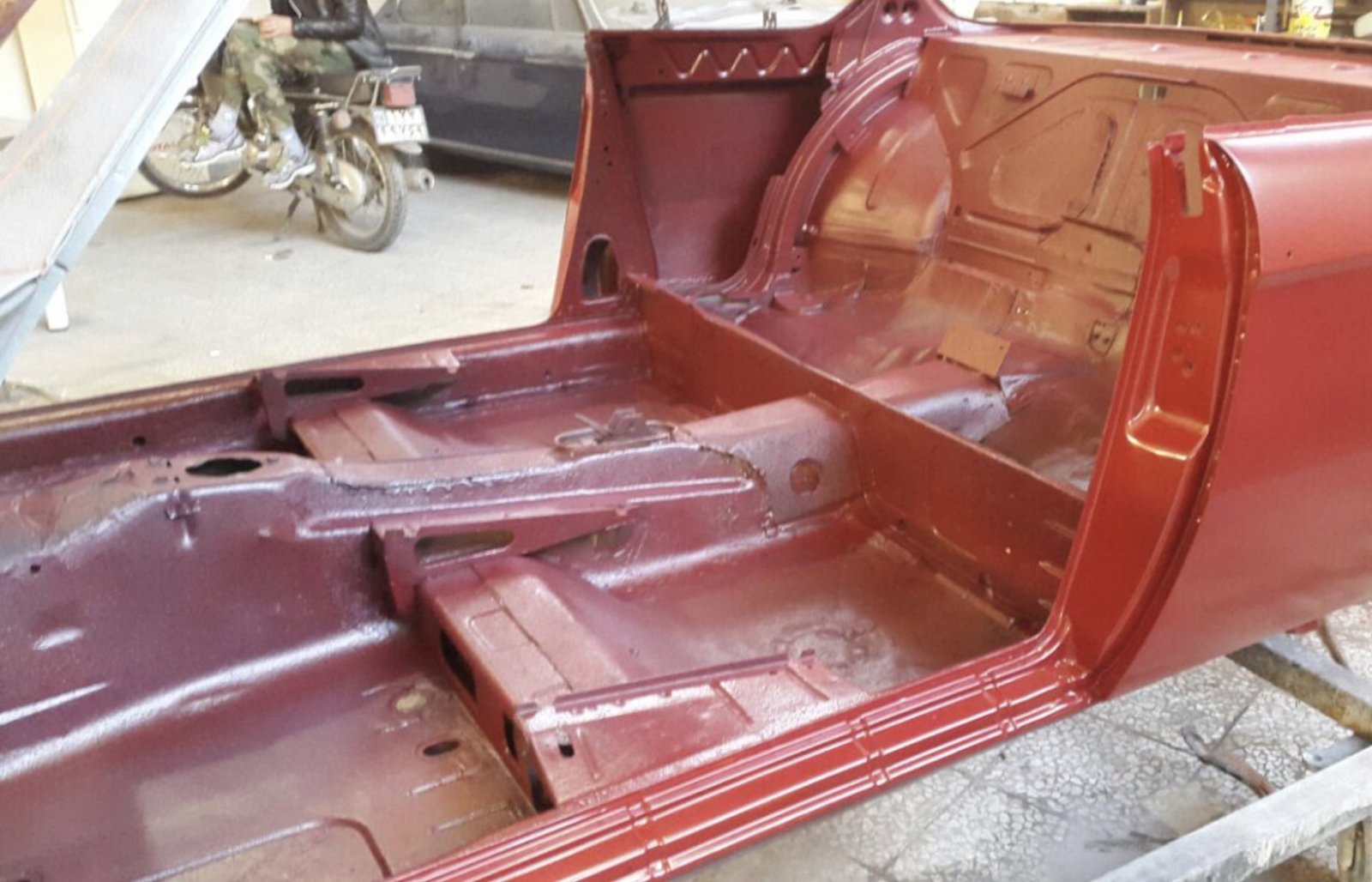

Seat rails are complete. Front part is mounted to the floor vertically and rear horizontally, that's why e9 floor under front seats have such shape (look at Merdad photos).
Genuine release mechanism is mounted directly in floor only on one side/rail of each seat (driver-left; passenger-right), that's why you can see teeth on wider rail.
