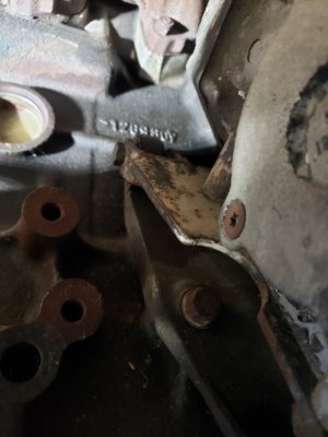

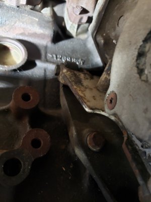

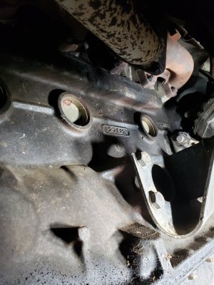

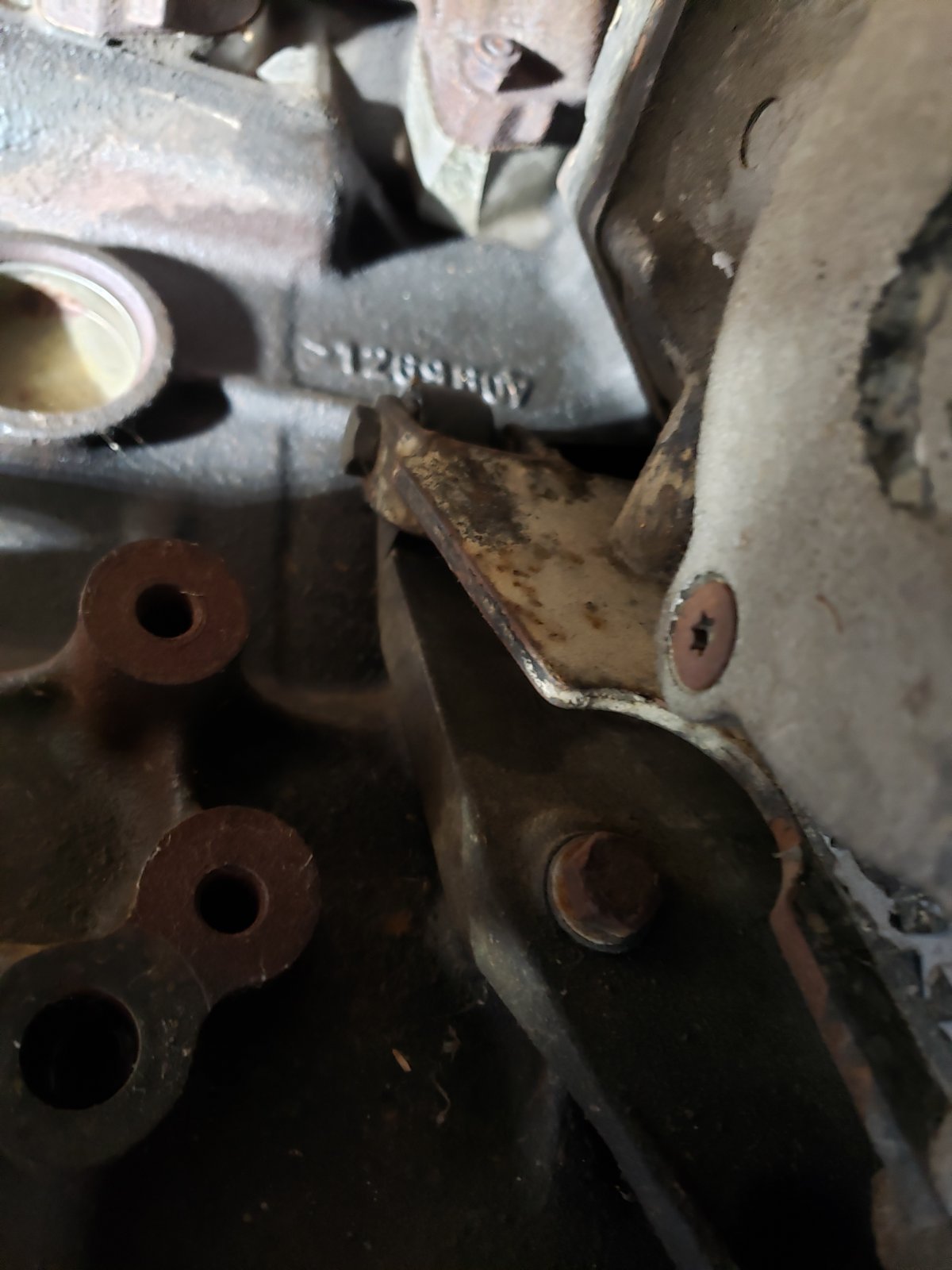

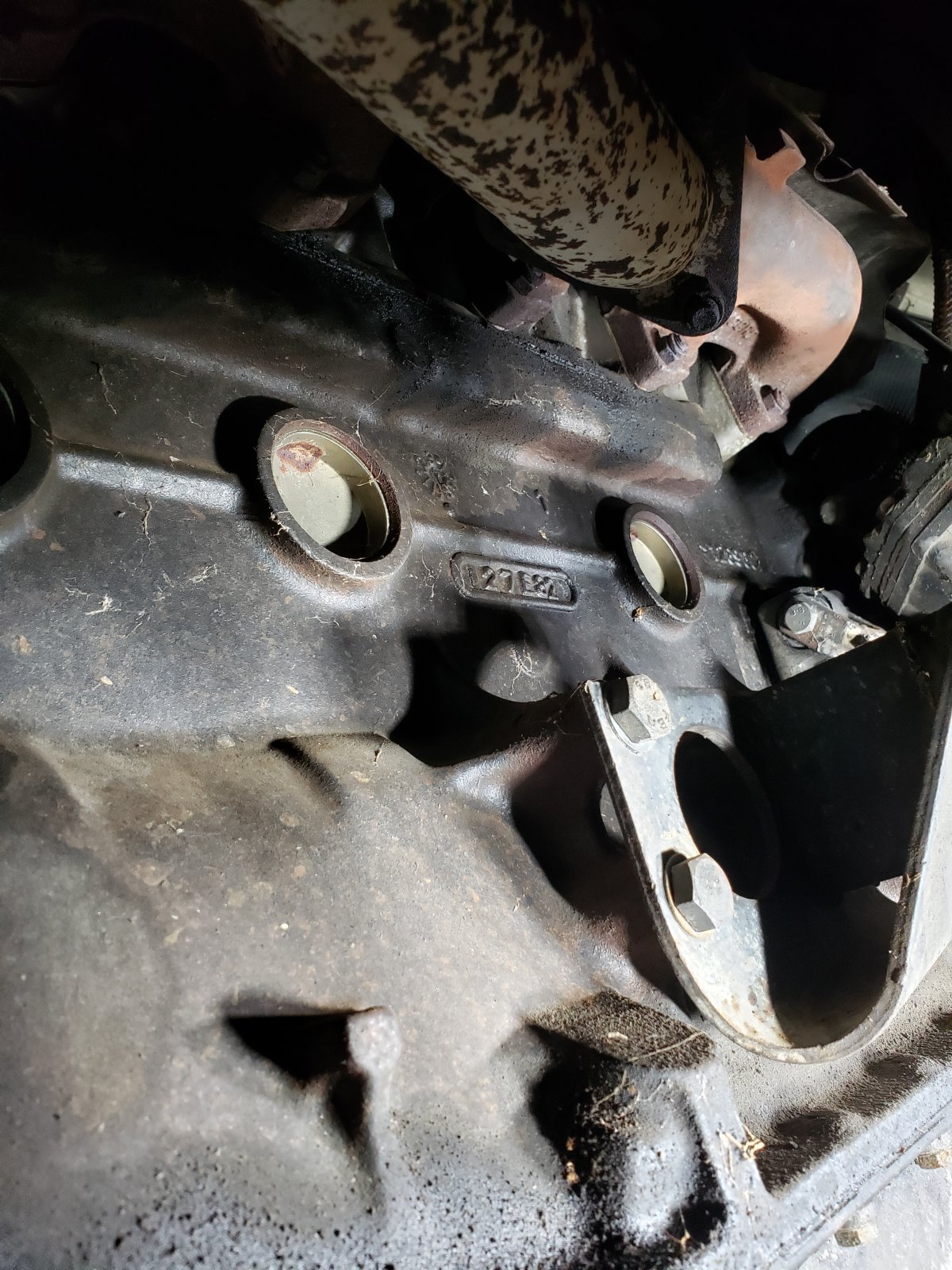

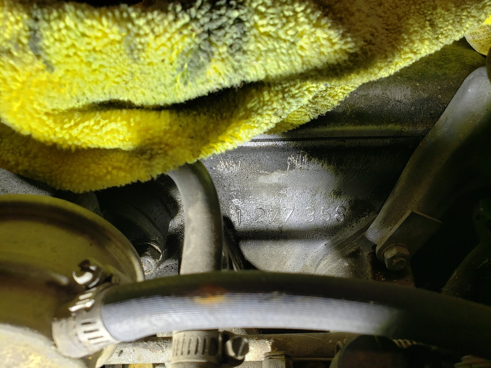

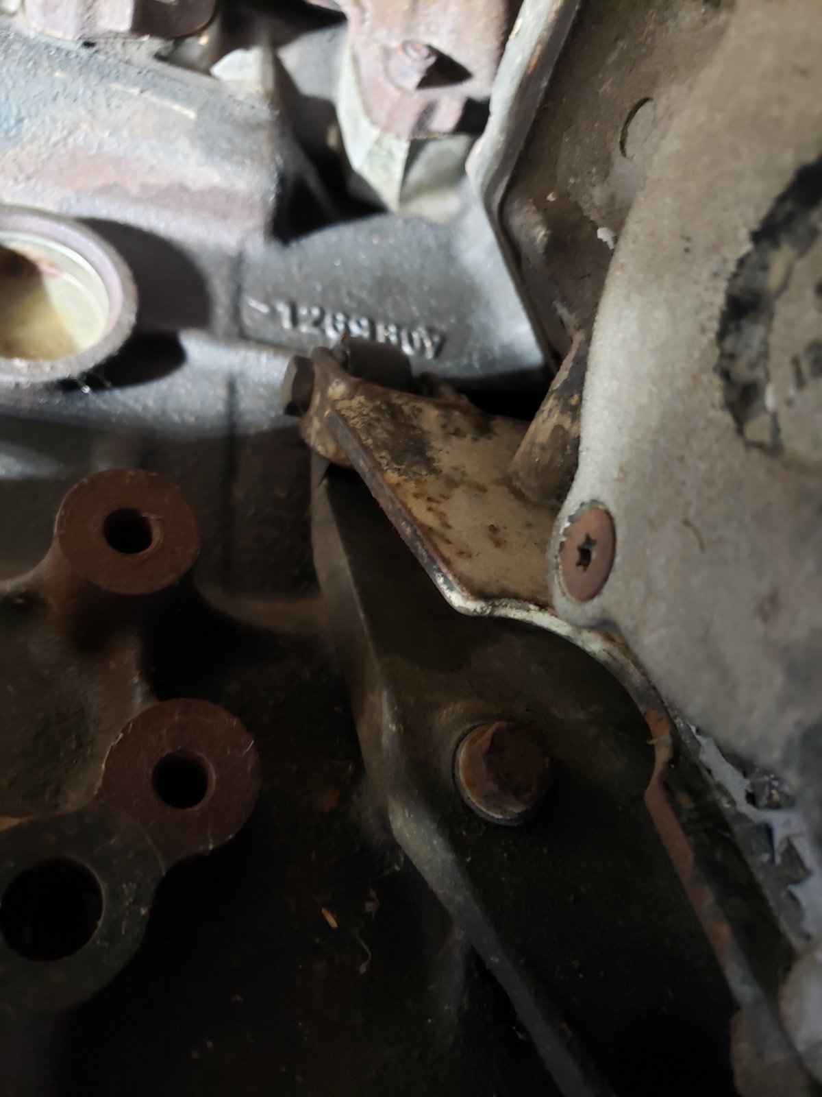

I have an issue with trying to identify what M30 engine I have in my 1973 3.0CS Vin 2240909 . I have read all these treads but still can't figure out what I have ? There is no numbers on the block above the starter that I can find. I have wired brushed it , used a magnifying glass and super bright light but can't find anything stamped. The head has an 82 stamp and a 5 to the right of it . towards the back the head has 1 277 358. The block be below has 3.0 / 3.3 stamped. on the exhaust side there is 27 E82 and towards the front of the block is 126980Y. Any ideas or help greatly appreciated.
I had a good idea its an 1982 engine , would like to know what it is if these pice help. Thanks

I would start a new thread yes. Looking at the pictures is confusing, particularly since the code on the head of your engine is the same as the code posted by Bboy in post number 8 in April of 2020.
The numbers on our engine don't correspond to any of the reference materials I have.
