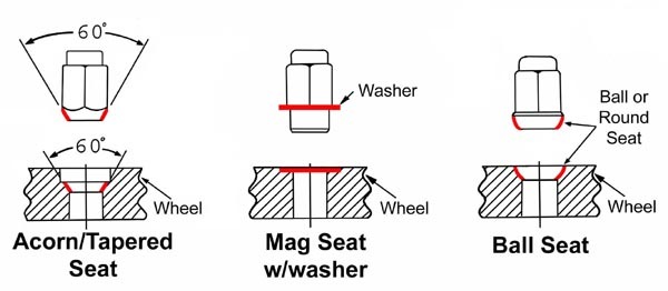

Careful here, my BBS Mahles use a round base lug nut also known as a Mercedes style, not the tapered/conical lug nut common on coupes. Find out first what you need. With those longer studs hope you don‘t need open end lug nuts.
Can you speak to how I would use a set of wheels using the round base lug nut?
I have a set of BBS RA222 Mahle wheels 16x7 et22 and they came with lug nuts with the washer and I was wondering if there is some sort of standard socket head bolt or similar that might allow me to mount these to later car with a full length lug bolt....
I guess if the wheel centers on the hub, the bolt is just there to hold it to the hub, I just wasn't sure if it may cause vibrations since there are not 5x bolts to centering the wheel on the hub also.
Actually looking at these wheels for an E12 based E24, I was hoping to avoid having to run studs in general, though I could add if needed, but I'd like the option to switch between wheels still as I have a few other sets.
