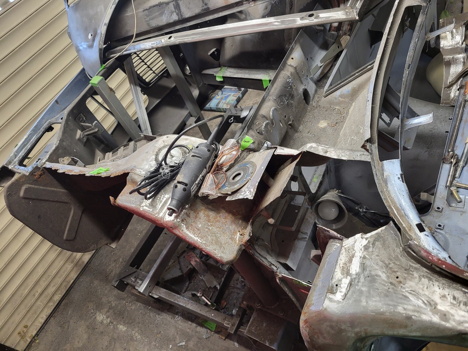

I think you've just realized that you have yourself one of the more difficult cars to restore. But also one of the most beautifull ones luckily!
As you can see in the picture, I'm in for the same!

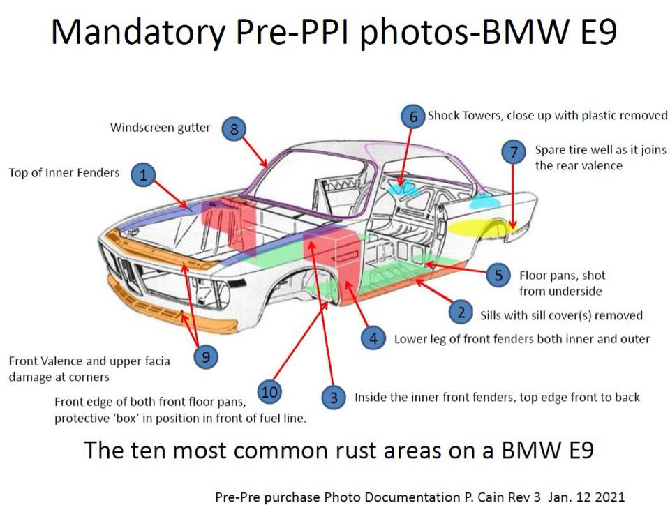

As many have said, welcome to the forum Jeff. Here you will find the best and brightest E9 minds in the country to answer your questions and help make your journey as smooth and informed as possible. Someone sent me this E9 diagram showing where all the typical rust spots are. I have attached it here for you to help familiarize yourself with where and what to look for. And yeah, there are a few really great threads from folks who provided a monthly update with the progress and pics of their restorations. Great morning and bed time reading! Good luck!!
