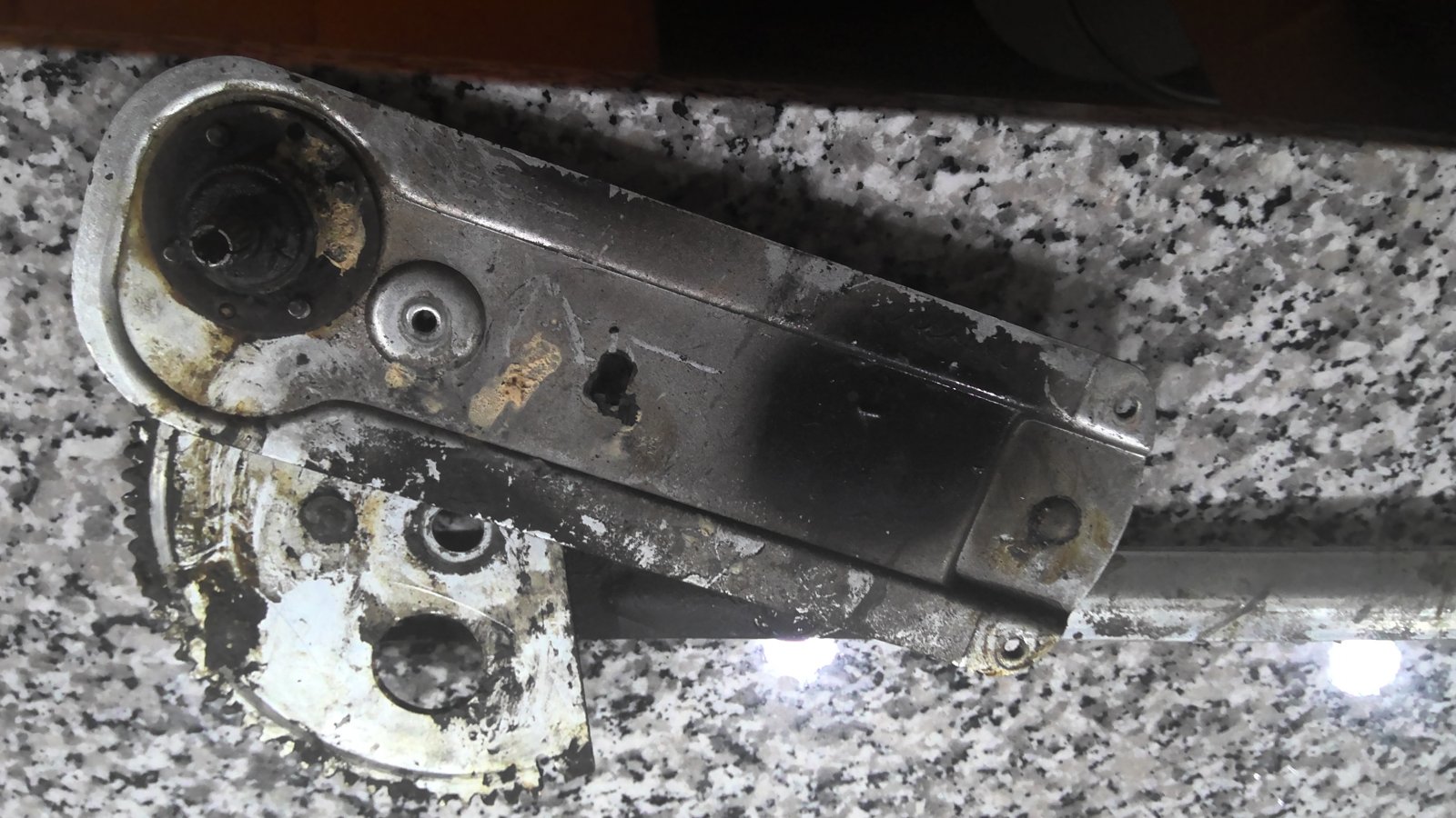

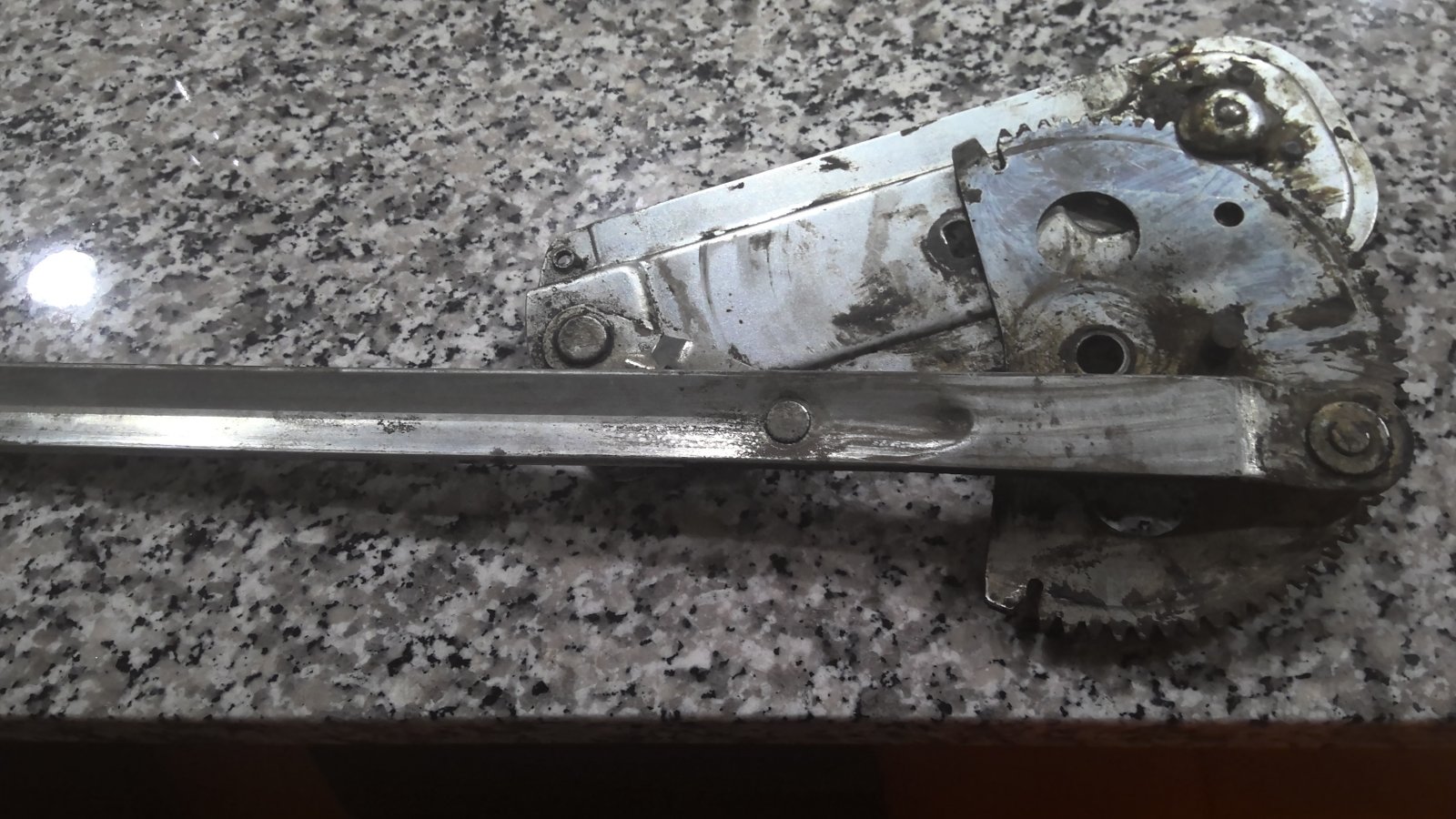

I am trying to repair this E9 manual window regulator but don't know what's missing?

Harry, bring it to me when you are in town, you have some broken bits. I think you know the coil spring is also missing since I saw you inquired about one for sale.
Harry, as was said - middle rotating pin & spring is missing.
Pay attention, if i remember correctly - springs from rear window mechanism are not interchangeable with springs from door window mechanism (different clock position).
