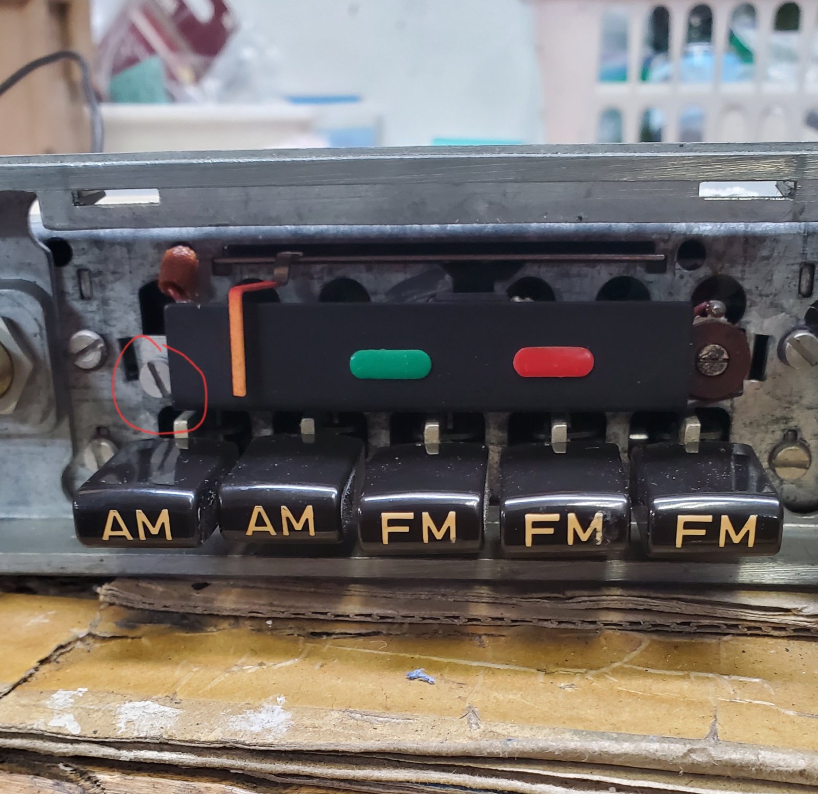

Hi guys - I picked up a 75 Becker Europa II Stereo and one of the lights behind the dial is out. I've read multiple sites and downloaded the manual.
The issue is the black indicator light holder wont pop out to change the bulbs. Did everything per instructions and manual and the plate still won't come out after loosening the screw on the left ( circled)
Anyone have any tricks?

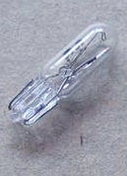

Unfortunately, those bulbs have a base. The bulbs in the indicator light are wedge style. Heres a pic
Thanks - found similar on Amazon after some wordsmithing on the search terms... I'll update if they work or not!
