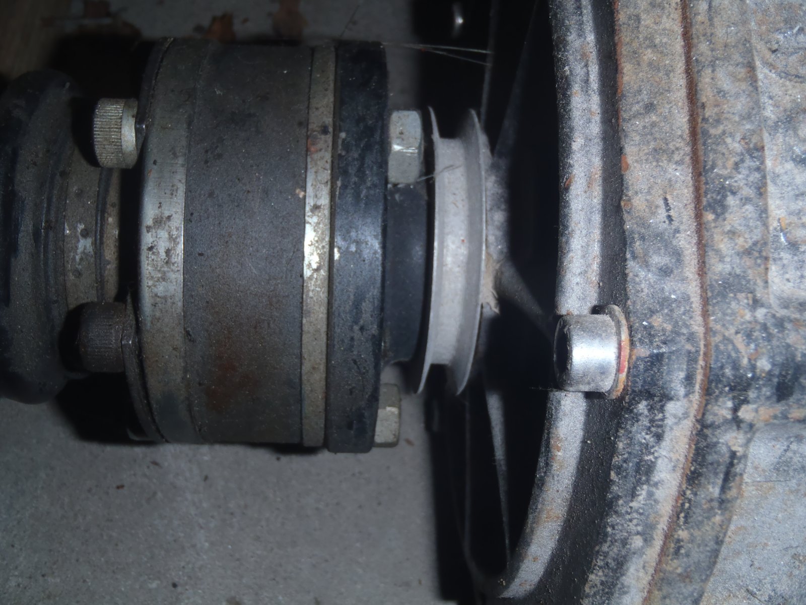

Looking for some insight as to what was used on the driveshaft for a pulley for the pump. Adding the pulley would lengthen the driveshaft so Im curious as to how this was accomplished on the early Alpina E9 race cars. Thanks!

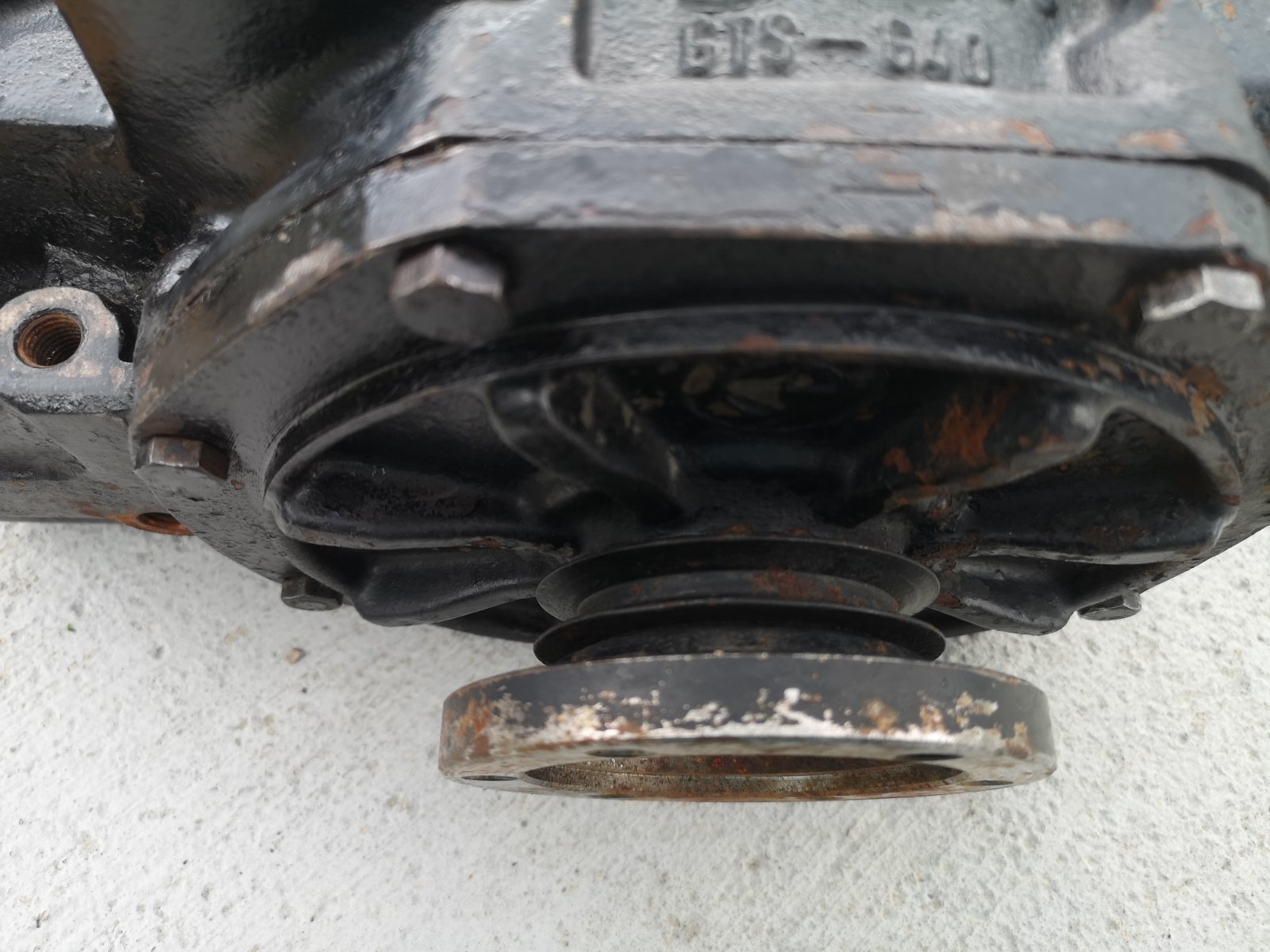

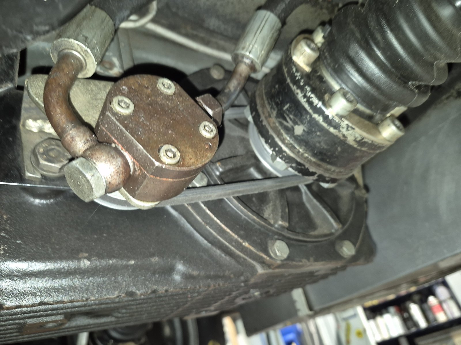

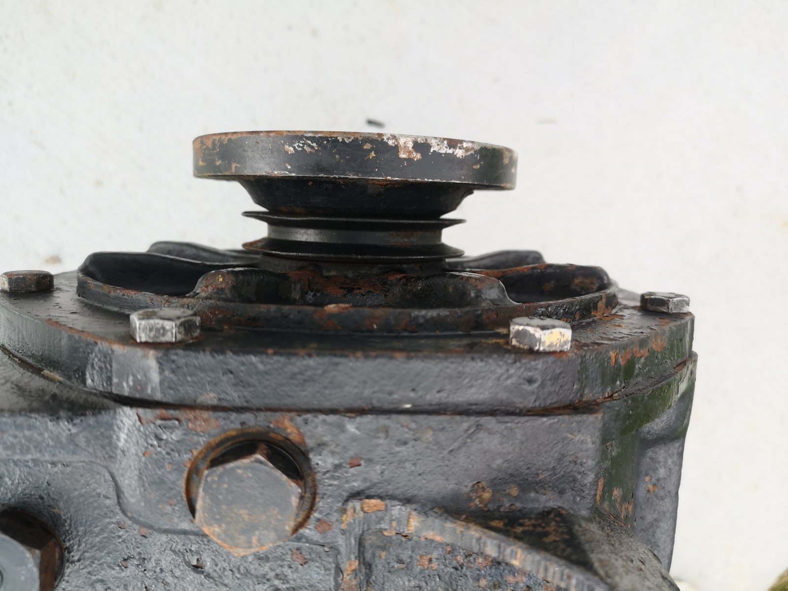

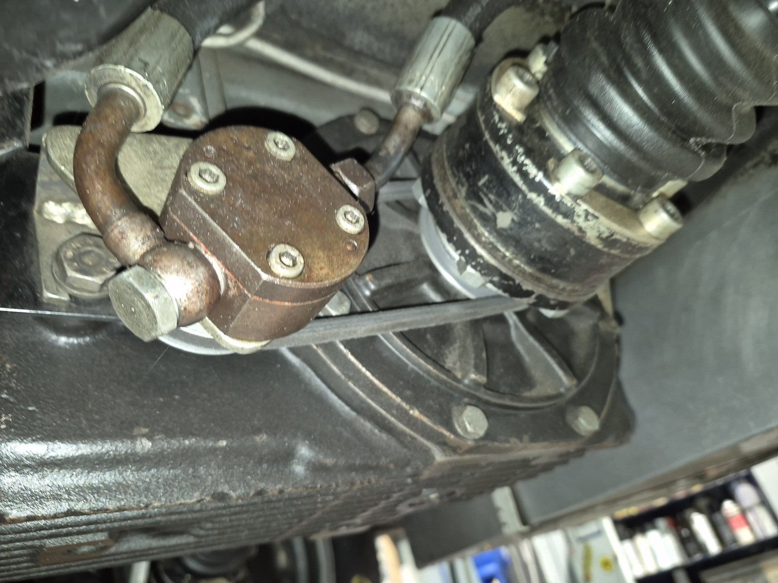

The pulley is pressed on to the modified left stub axle on the differential. The pump is mounted on the two 12mm bolts to the differential. I will try to post a picture later on.

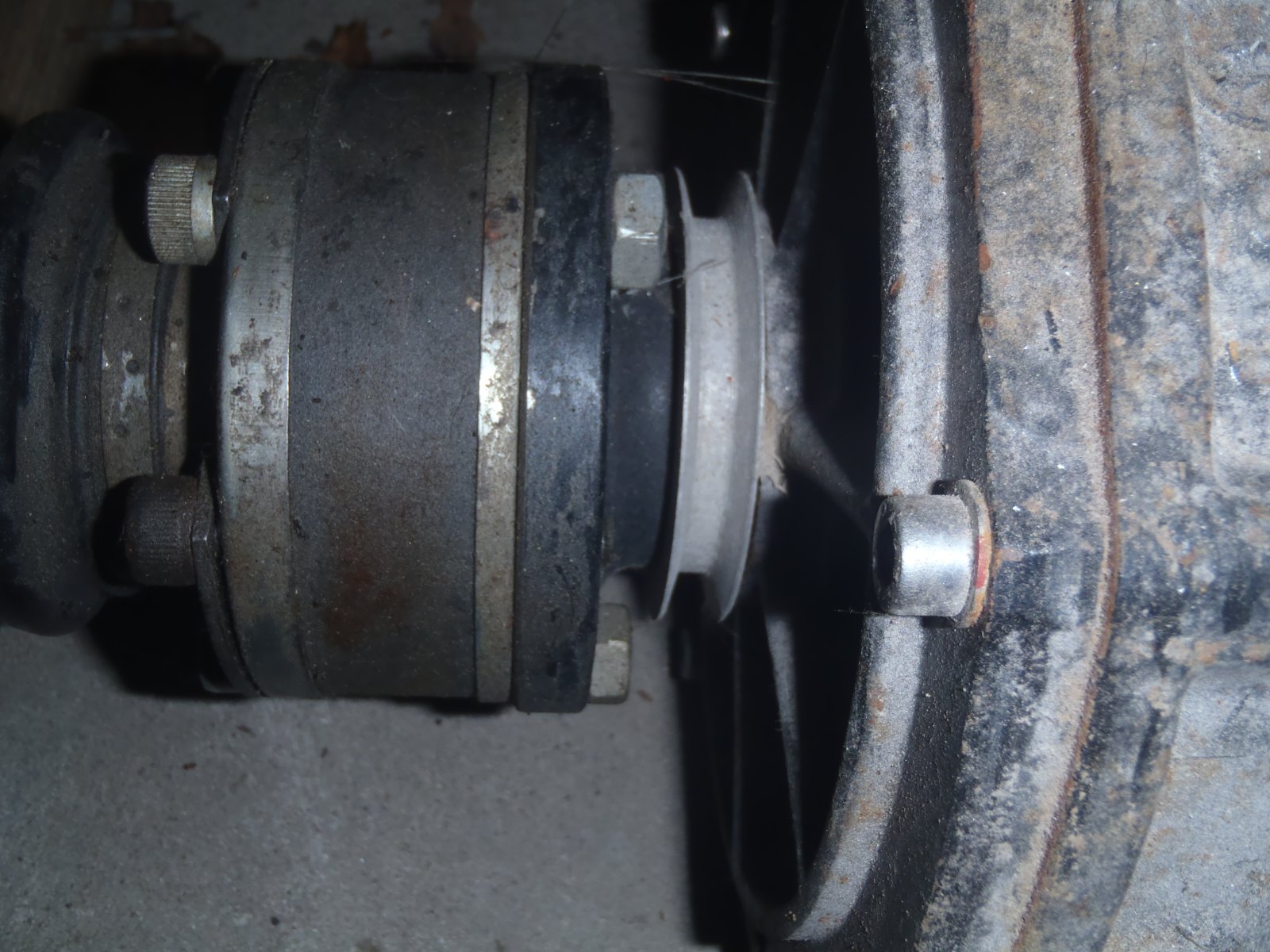

The V belt pulley is pressed onto the output shaft where the dust cover would be....
