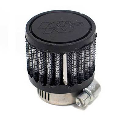

A very common E9-problem with hesitating +4500 rpm is a very easy one.
Replace the additional air slide with a new one (blocked filter). If already replaced, check if the new one still has the round filter inside. Unfortunately there was a production problem with some new air slides. The filter simply fall out after some few km. With no filter in the additional air slide, the engine will hesitate starting from 4500 rpm. I had this problem om all my injection E9.
Cheers
Hey CSL,
I don't quite understand - the auxilliary air slide is shut when the engine is warm though and therefore the air filter for this should not make a difference? I did replace the auxilliary air slide a while ago but I reused the air slide air filter.
Regards,
Rohan
If you re-used the air filter check that the round air filter itself is still there or not blocked. My aux air slide filter house looked fine at a glance but when I put my fingers inside (from the right), it was empty. The poor air filter-welding/glue was broken and the filter had fall out despite that the part was just a few km old. Same story with both my CSL and CSi. After another new aux air filter (improved version), the hesitation I had at 4500 was gone.
Don't ask me for the logic in this, I'm just happy that the hesitation was finally gone.
