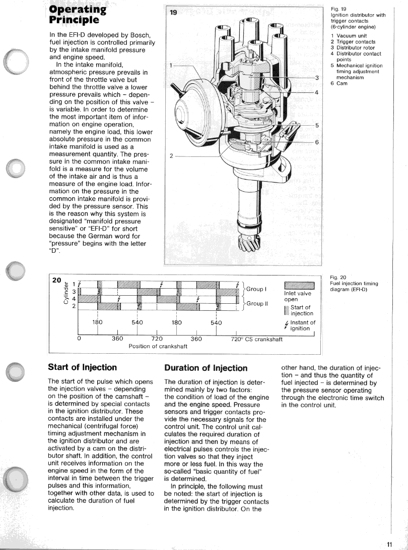

On a djet equipped csi one might pay particular attention to the fuel pressure and not overlook the injector trigger contacts (at bottom of djet distributor) and possibly even a worn or maladjusted throttle valve switch. For any of the electrical parts, e.g., senders and switches, the part itself may be fine, but a poor electrical contact due to brittle wiring or corrosion can make any part appear bad. It is unlikely, but ECU's and pressure sending units can also suffer from poor connections and are not impervious from breakdown.
