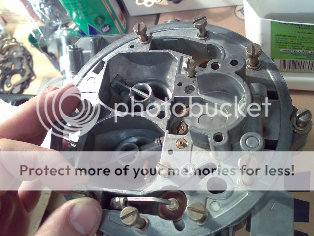

not sure, but a hessitation when pressing the throttle can be the little pump that is placed inside the carbs, it is a cylindrical object that is composed of a spring and a rubber end that acts as a syringer, injecting fuel when the throttle is suddenly pressed
they are available in bmw, and almost in any rebuilding kit
rebuilding the carbs is a nice work to do, not very difficult if you have minimum skills

in this pic you can see the top of the mentioned little pump
is the cylindrical part that you can see 4cm to the right of my thumb
Thanks mate, I take it that the acceleration pump outlet is the small curved brass tube visible in the intake of the carb in that pic?
Fix it before rebuilding... much less to deal with.
Operate the lever on the side to see if you get squirt while looking at the nozzle. Engine off, etc.
Once that's ok.... check the linkages to make sure everything moves the same on both carbs. Best with a helper to operate the pedal since there's a lot of slop that can accumulate, don't take it for granted. You might just find that missing extra horsepower.
Buy a synchonizer or get comfortable with a tube and your ear. Carbs out of sync will do the same thing.
When describing a carb symtom- always reate it to idle, rpm, wide open, etc. It helps in the cure.
The best way to say all this- the carbs have to do the same thing at the same time. The fix is usually just a problem with one and finding the right one.
