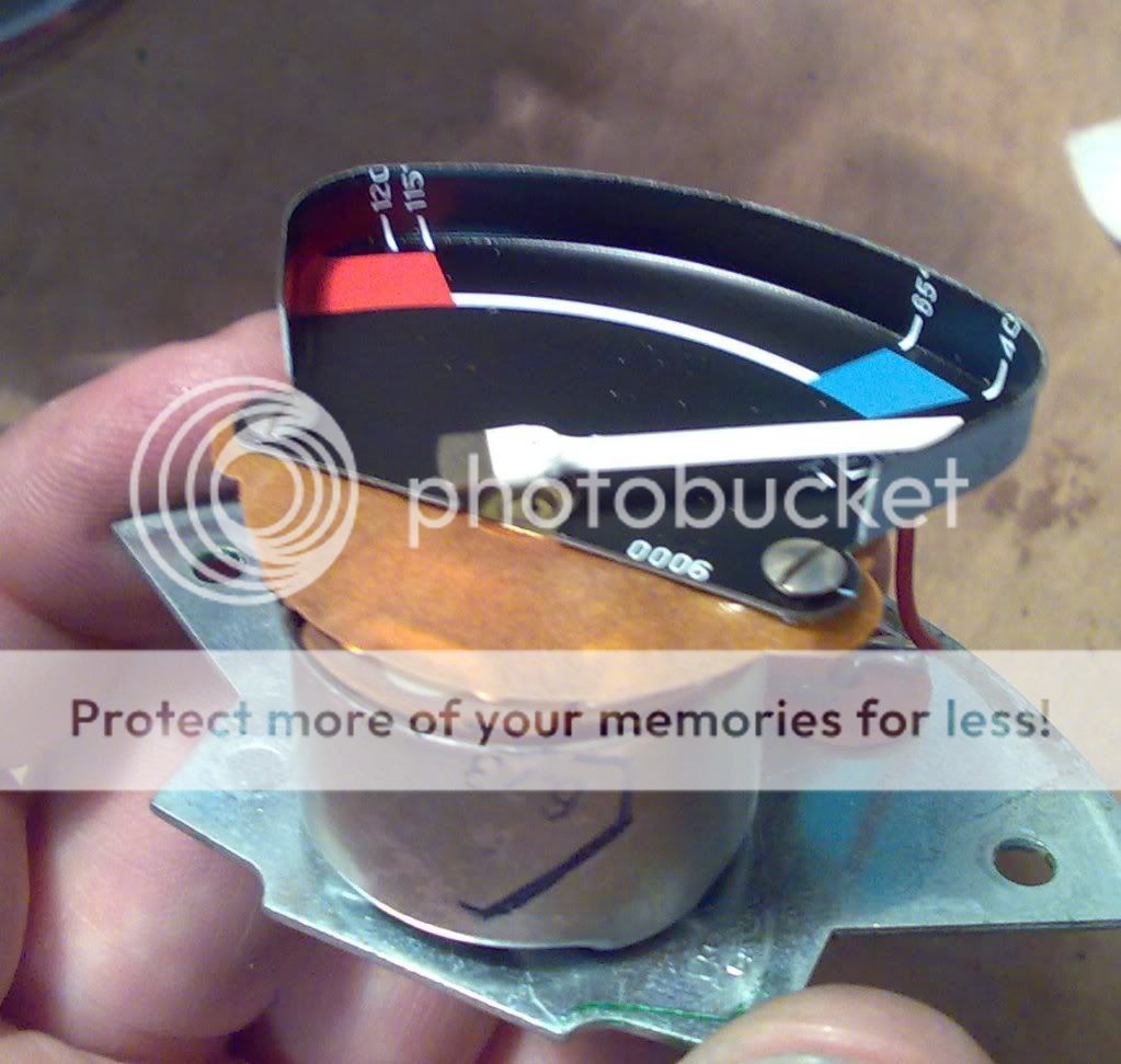

On the way outta town, I noticed a sweet musty smell in the ****pit, "Hey?! WTH is that smell?! The Pumkin regulary sports 'Ode de 40 year old Hot Rod', so certain 'smells' are normal.. My well versed E9 co-pilot suggested: 'it smells like manure!" A logical deduction around the farming/AG regions in the north valley of CA. However, being intimately familiar with the Pumpkin's aromas, I new something wasn't right. The smell was getting stronger and there were not any farms around us at the time...hhhmmm?!....Doing a systems check by glacing at the nice row of VDOs, the temp was rolling up quick past 220! ARGHH!! Still had 4 miles to go in 5th gear...
Did I blow a head gasket?! Temp was fine earlier tonite, car is running great...the G.Pumkin never runs above 140-160 degrees.....crap. With all the mulit-day events the Pumkin has enthusiastically and effortlessly tromped over, Murphy's Law has to deal me some drama a couple miles from home after an evening's fun.
My very E9 wise co-pilot offered, "Keep the rpms down, we can make it home, we'll be OK..." I questioned his thinking that we could make it without pulling over.... The Pumpkin has endured CA's East Bay area's rush hour's traffic in the summer heat without a ever breaking a sweat many a time. This seemed and smelled a bit different. My faith in the Pumkin's awesome race ready, High-flow, re-cored/rebuilt radiator was in question, so I hit the 'Arctic Wind' switch (my 2500cfm electric fan) and WHOOSH!! Usually this will drop the temp gauge before your eyes...no effect, temp kept rising..230 and rising...ARGH!..time to abort!
