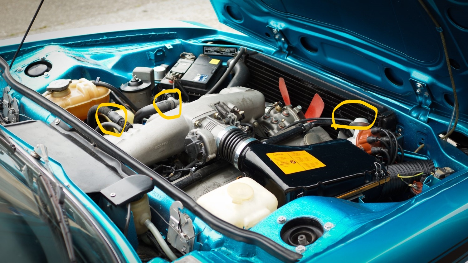

I started my 3.0csi last night and the idle jumped up very high and I couldn't get it no normalize. I took it for a quick spin to see if it needed to cough out a furball but that didn't work :/ any ideas if it's a bad part or adjustment?
Thank tou for your education and experience Ken
The latest guidance I got was that a vacuum leak would produce a systematically high idle, while a bad O2 sensor would produce erratic or hunting idle. Finally, a bad Idle Control Valve caused high idle for me on the E24 that would go lower upon a light tap to the accelerator. Again, the above is second hand hearsay and idle talk.
My vote is for a vacuum leak. On your djet there are many possibilities. The easiest to check might include a loose vacuum hose that connects “slips” on to the distributor retard mechanism. Auxiliary air intake valve that fails to close fully is also a likely candidate as is the hose from the valve to the manifold. While unlikely, there is a hose from the manifold that feeds the brake booster and then there is the booster itself. An unusual “hiss” may be a good clue.
An alternative theory regarding a "high" idle might involve the late Mr. Marley, but there is nothing referenced in the shop manual index.
For starters >>
