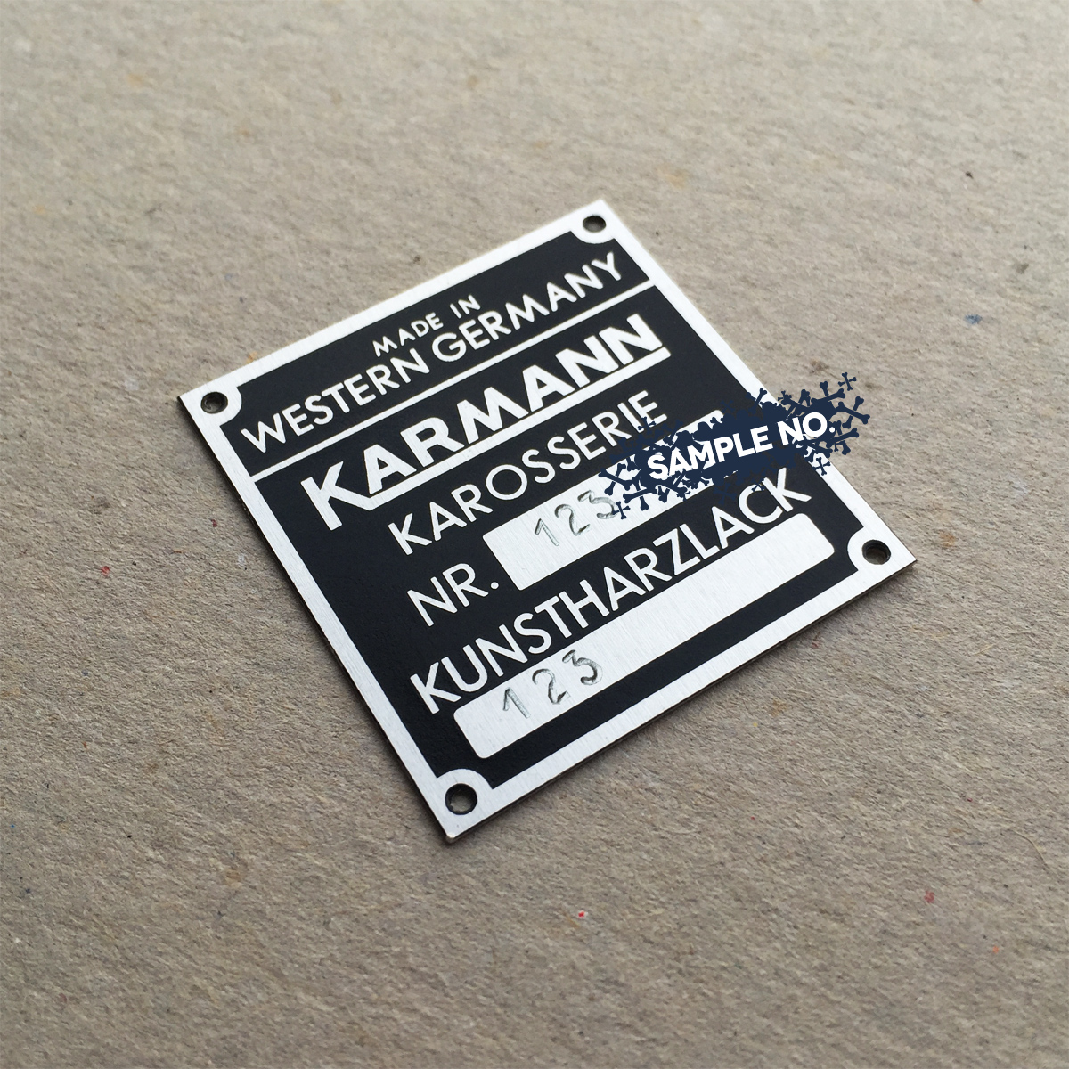

1. If you have original plate as below (A-post, drivers side door, between door hinges) - then check what number is written in position "KUNSTHARZLACK", by that number you can check original colour.
2. You can write an e-mail to BMW CLASSICS section ([email protected]), give them your's car VIN and they will reply you with couple of useful information's (including colour).

1. If you have original plate as below (A-post, drivers side door, between door hinges) - then check what number is written in position "KUNSTHARZLACK", by that number you can check original colour.View attachment 30928
On mine number 85 is seen last one I cant read... I will send them email.
Chamonix have colour code 085, so white is original colour.
Yes, I got confirmation from BMW: The BMW 3.0 CSi VIN 2261124 was manufactured on January 04th, 1972 and delivered on January 14th, 1972 to Italy. The original colour was Chamonix, paint code 085.
