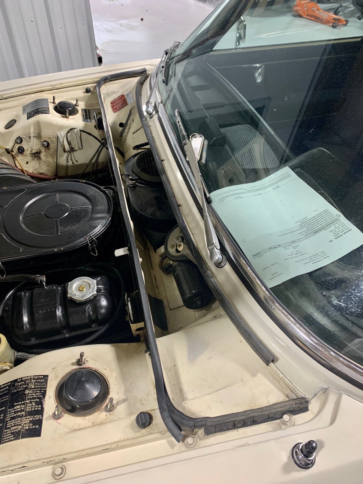

Hello all:
I would appreciate a recommendation of where to go find an aftermarket rubber gasket manufacturer that works with our E3s. Specifically, I am looking to replace the two gaskets under hood that surround the blower motor - as pictured. Even better would be reference to part numbers if someone has replaced their gaskets with a new set, since these are NLA with BMW. Many thanks

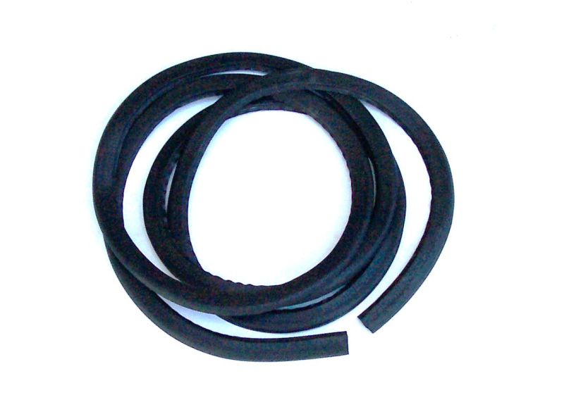

I don't want to steal his thunder but I have two saved threads where Chris Macha suggests using a trunk seal cut to length. I bought two trunk seals (one for the trunk, one for under the hood) but have yet to try to install them.
