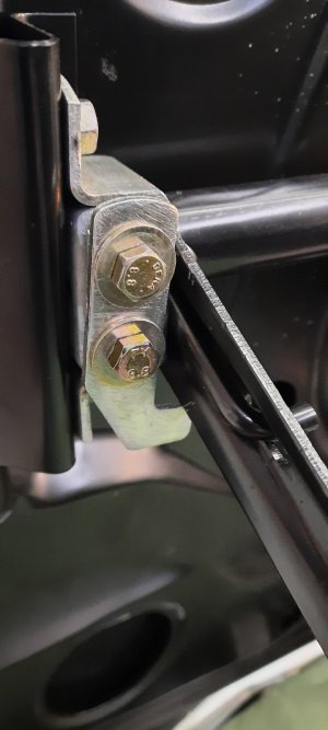

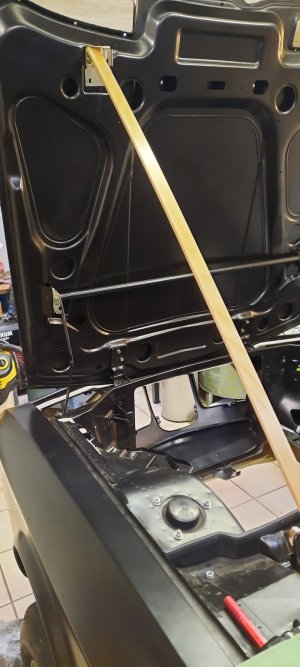

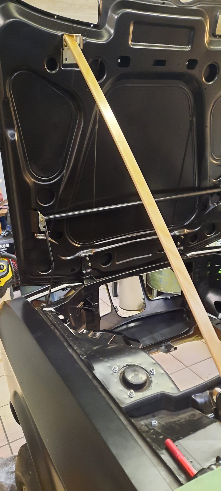

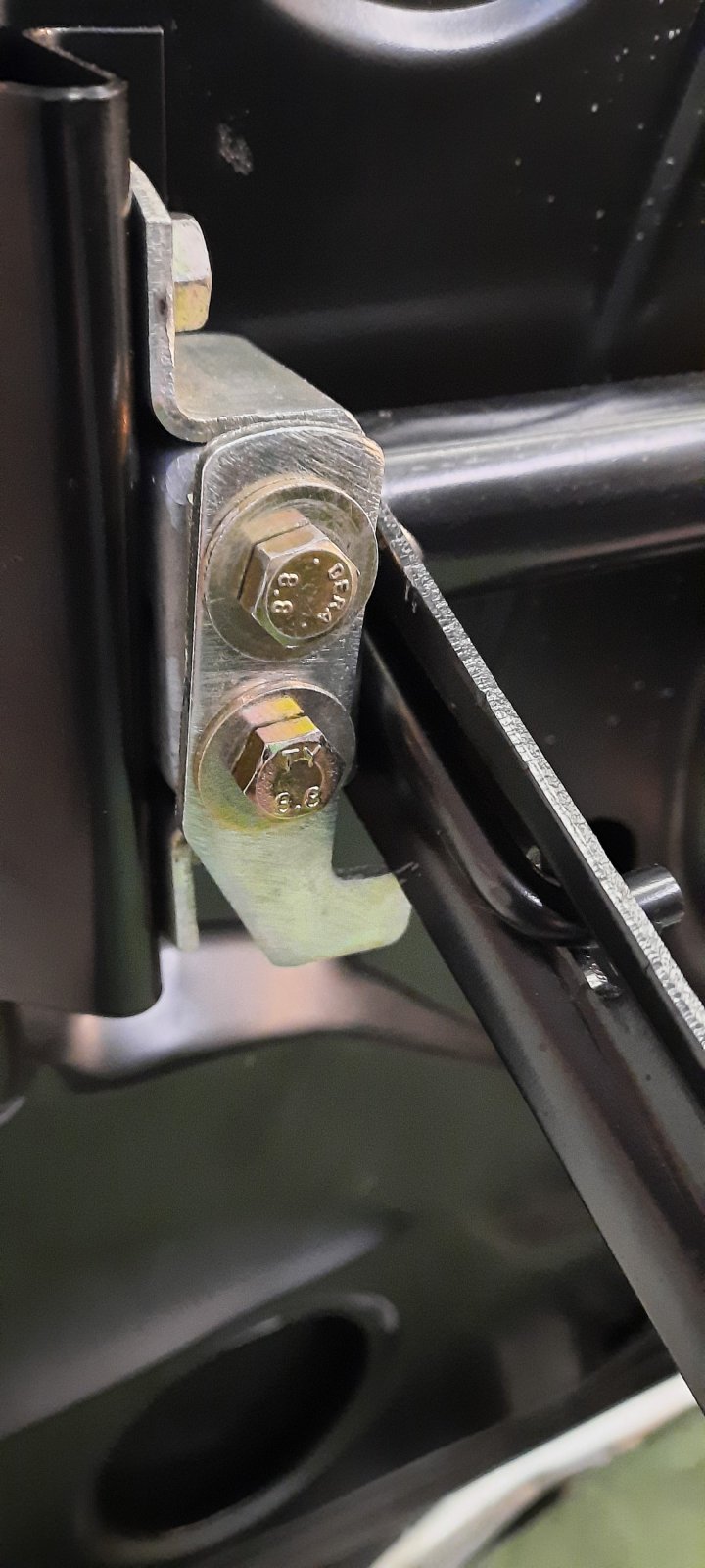

in fact it's an easy job:
- bring the hood into the upmost vertical position
- support the hood with a small wooden plank or broom stick, no need to fix it
- remove the covers on top of the front light

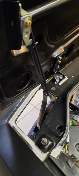

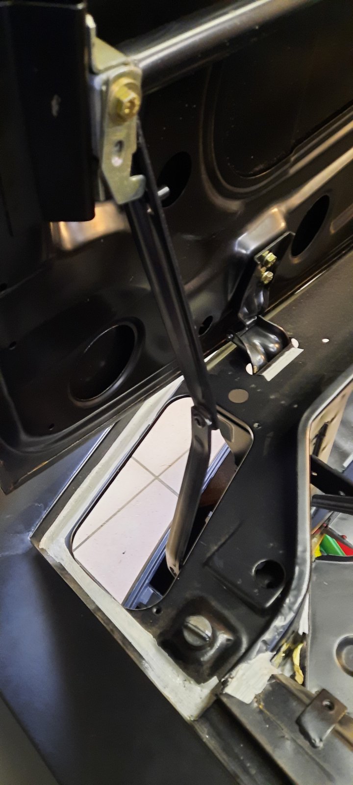

- install the torsion bar on the hood placing the arms inside the front light opening
- cover the area with a mat to avoid scratches
- slowly move one arm upward to bring the latch into position
- secure the latch by the M6 screw
- do the same on the other side
- fix the arms on the car body
For me (since I have strong arms and not two left hands) it's easy to do this job alone. If you do it for the first time better ask for a helping hand!
Thomas
With the procedure as described by Thomas, the torsion springs are in their relaxed state when mounting the system to the hood.
The tension in the spring only builds up when the upper part is rotated towards the back of the hood ( to the vents).
Apart from getting the hood in place, it's a one man job.
