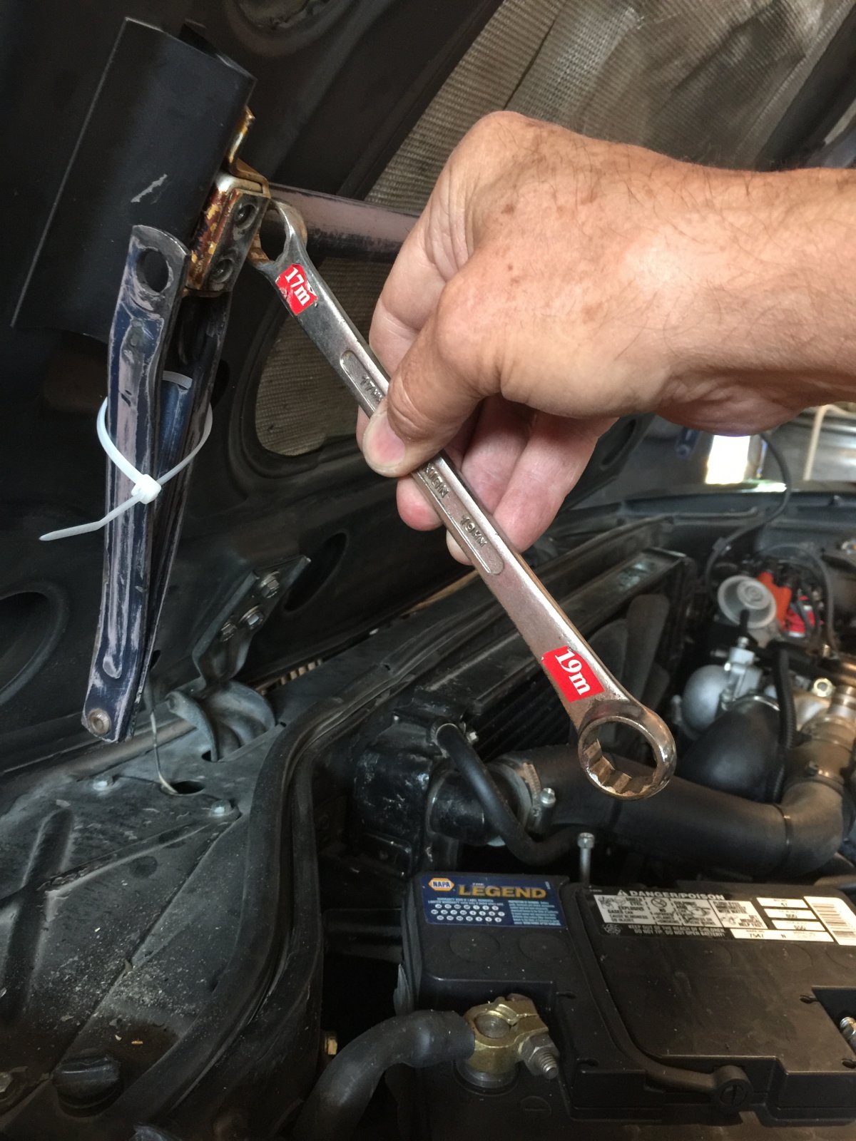

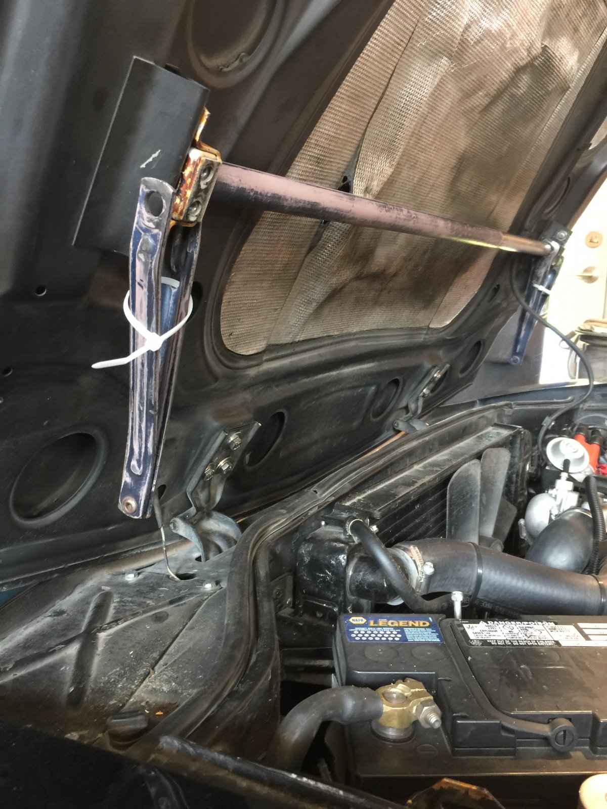

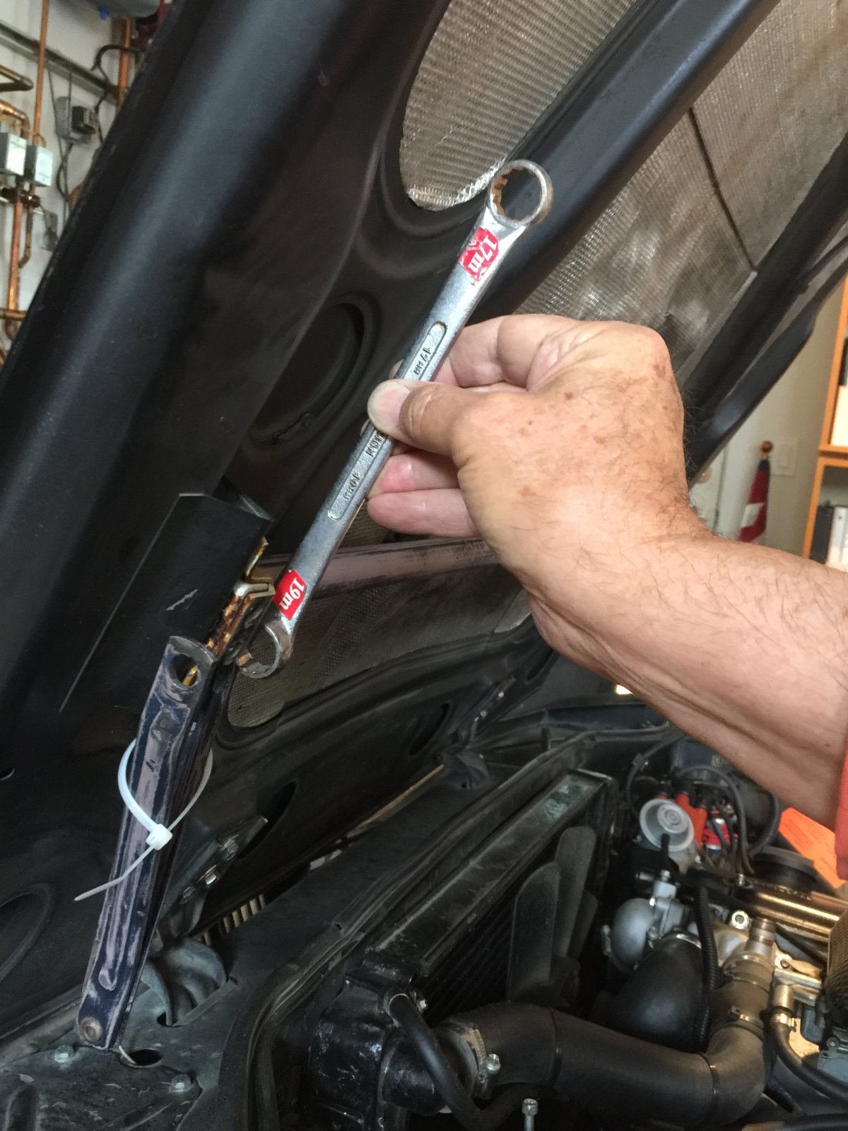

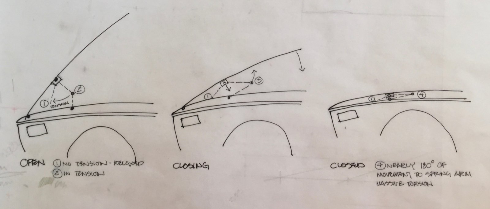

I'm replacing a broken hood torsion bar. A pre-paint test fit of the replacement unit (scavenged together from 2 sources) went ok until I tried to hook up the link to the top of the fender. It seems to take an extraordinary amount of force to pull back the torsion bar arms. Then when I eventually close the hood, the torsion bar arms will rotate through nearly 180 degrees, putting a lot of strain on the system. Please look at the attached photos and diagrams. Am I approaching this correctly?
Thanks for your input.
Ken in LaConner, WA
