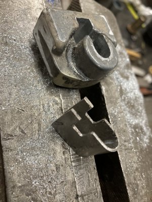

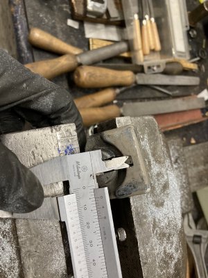

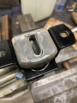

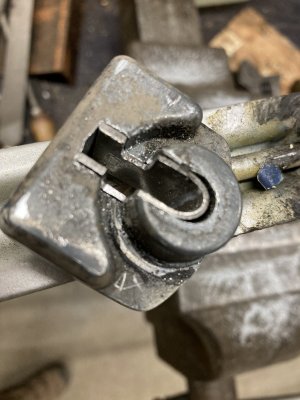

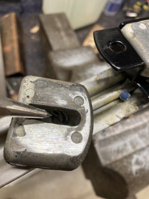

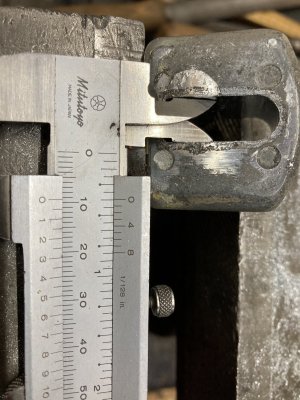

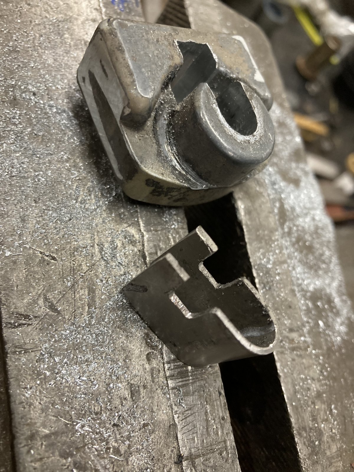

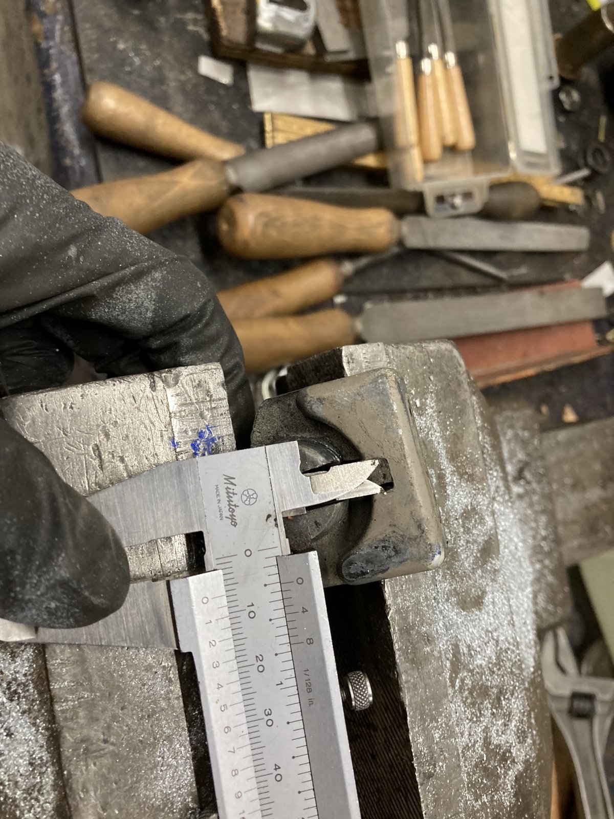

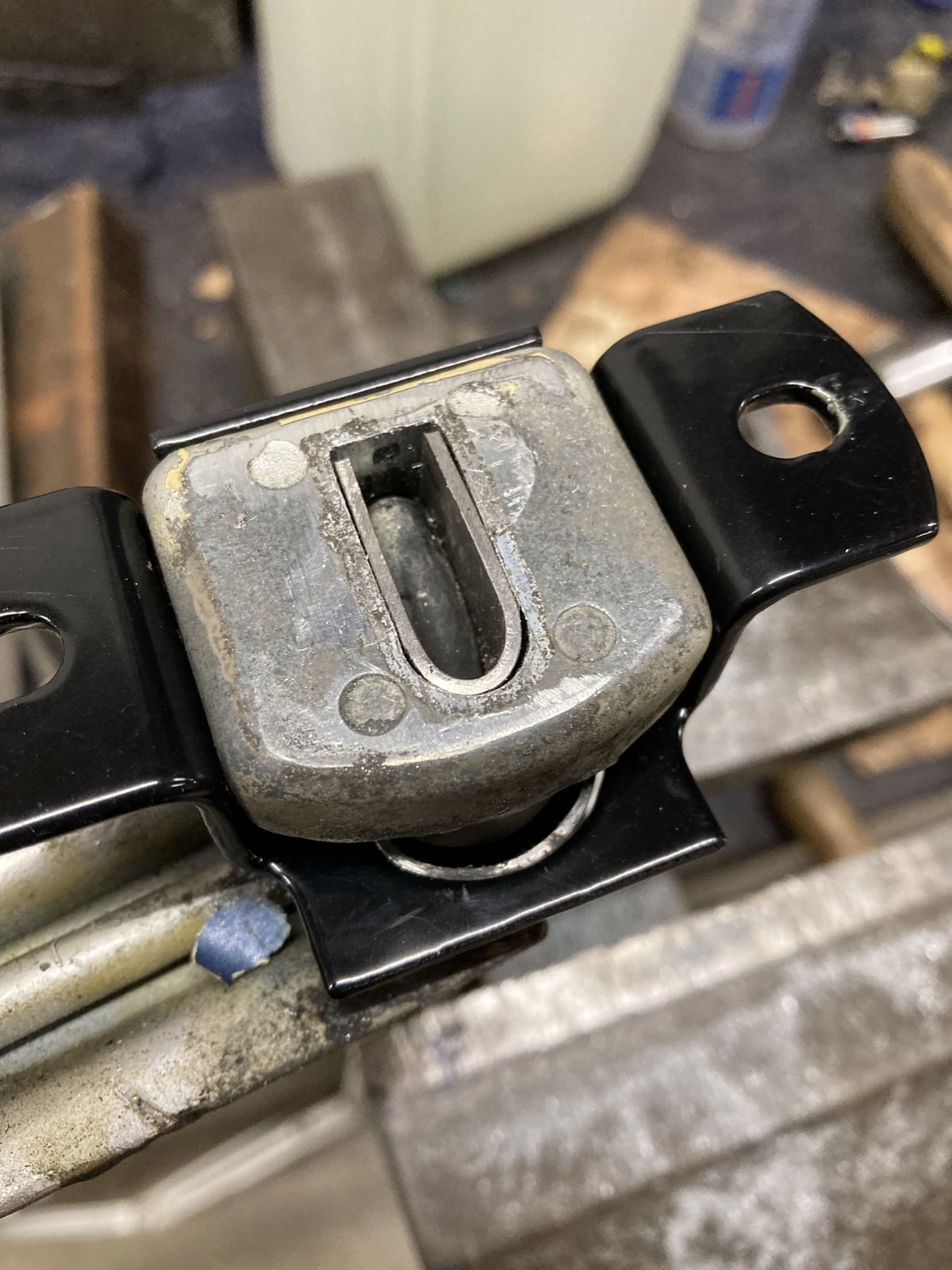

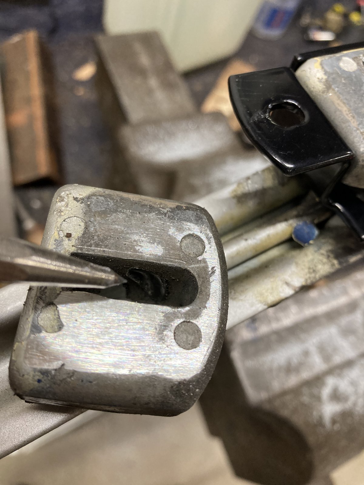

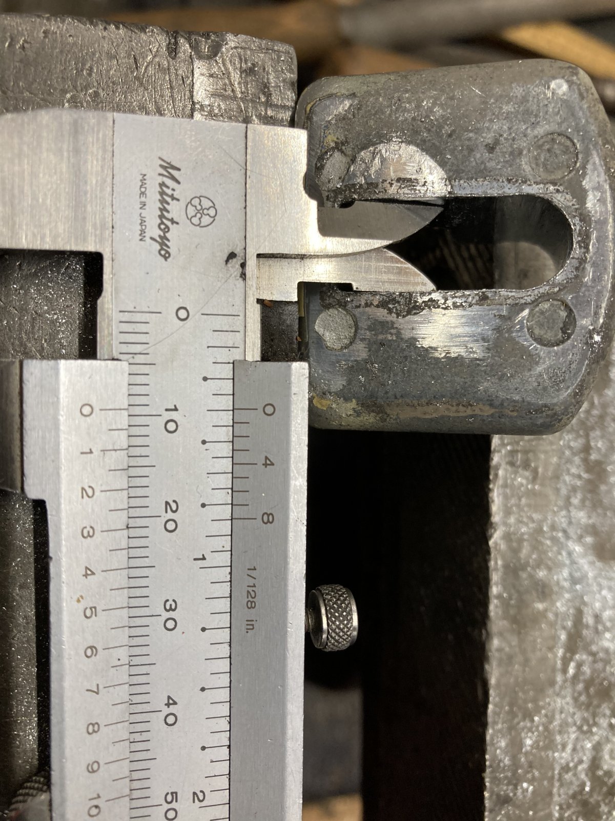

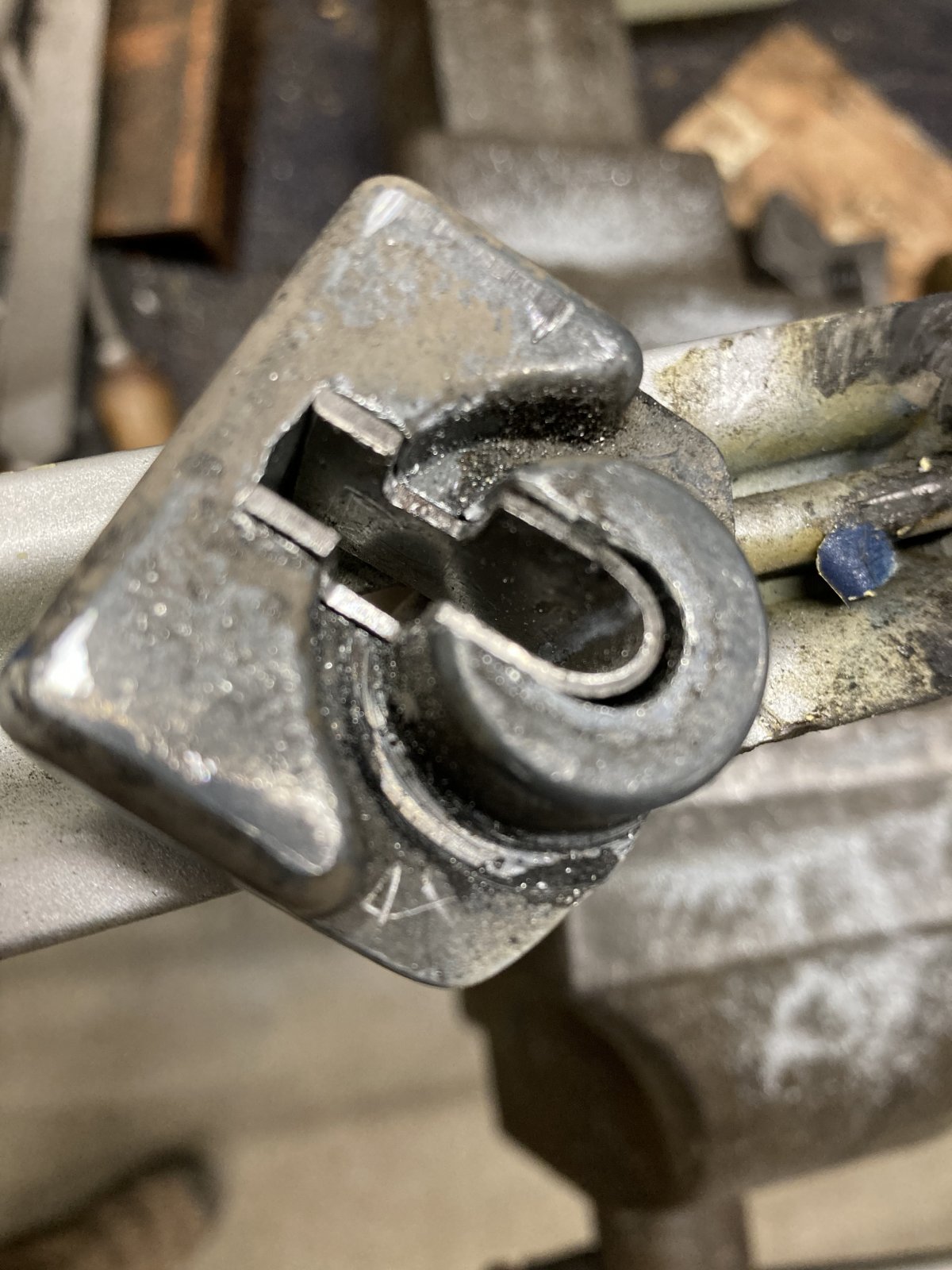

Today i made a modification/refurbishment to my hood spring holder. The soft aluminium holder was worn out, resulting in loss of torsion in opening the hood.
First I made the opening approximately 2,5 mm lager. In the opening I made a stainless lining.
See attached Photos’

I have made an drawing of the stainless steel lining. You can bent it around the torsion spring (6,5 mm). The opening in the aluminium holders must be enlarged by filing or grinding with 1 mm (totally 2 mm)
See also my earlier attached photos. Good luck
