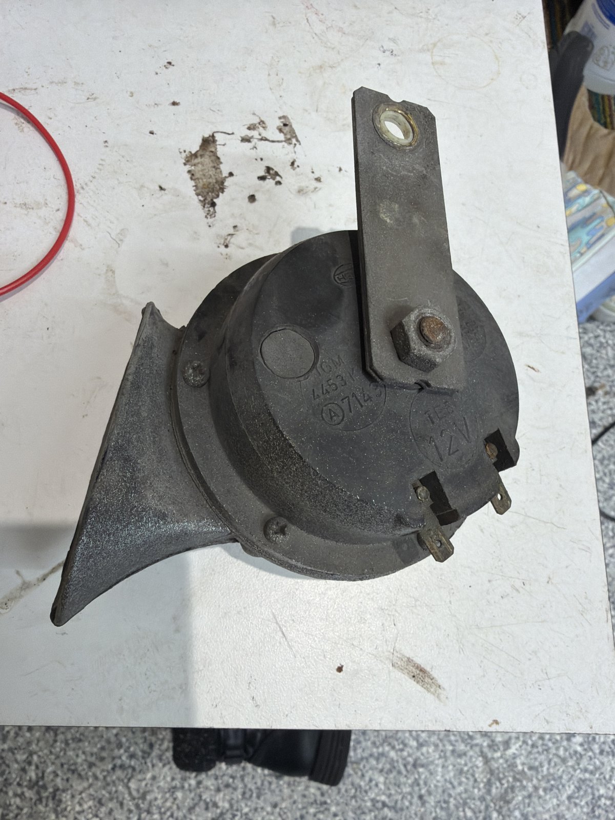

Horn location

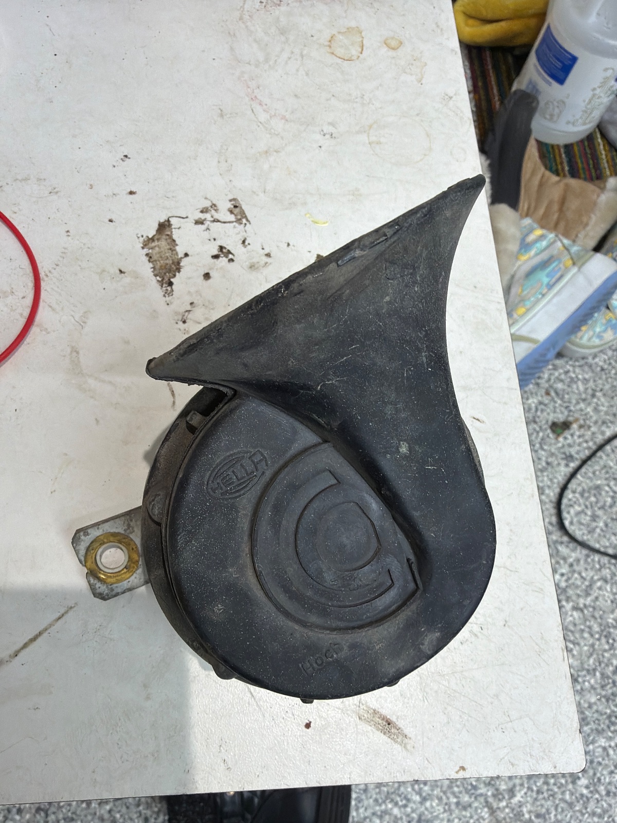

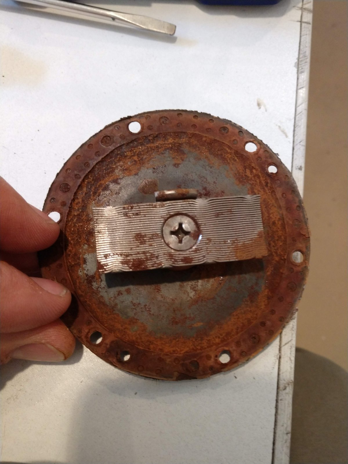

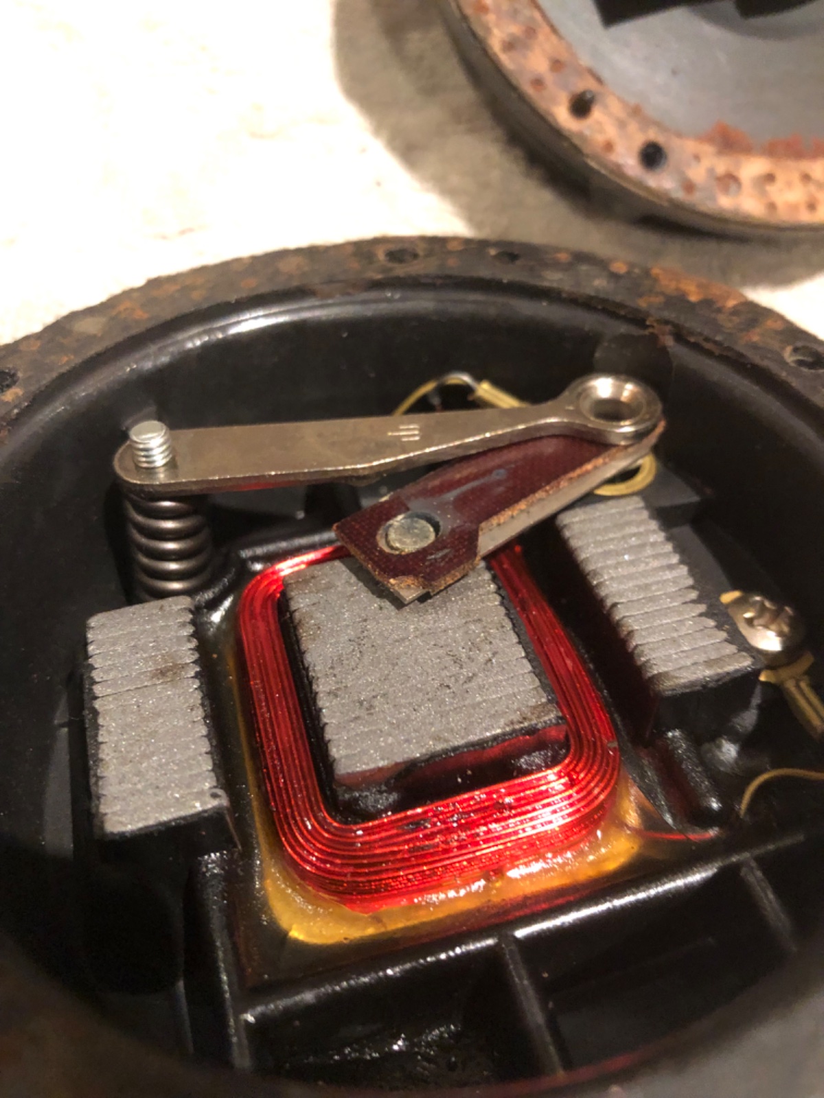

yes, don't buy the black ones that say they are for BMW, they use a new type of connector that doesn't exist on the coupe.

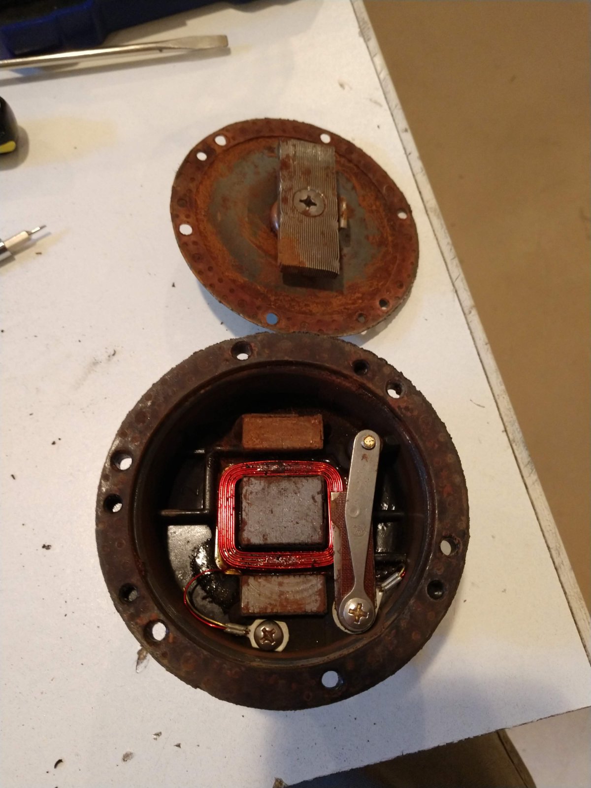

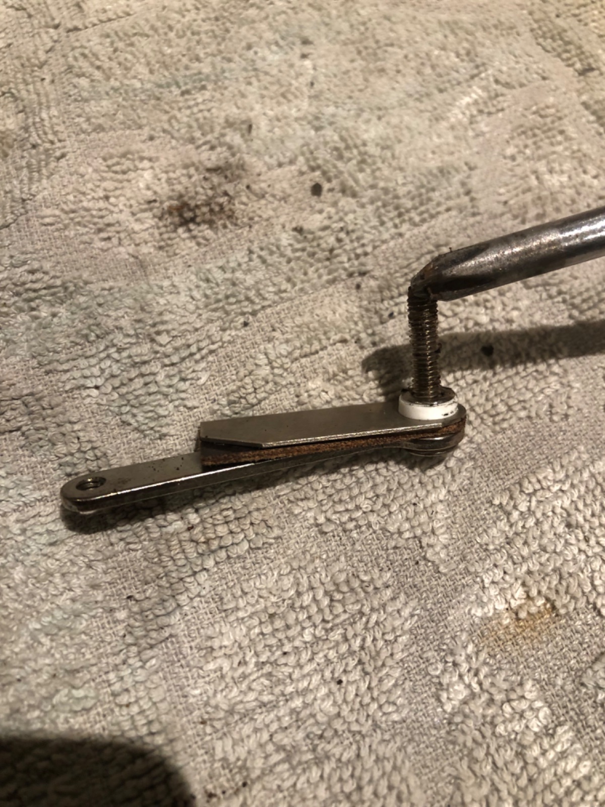

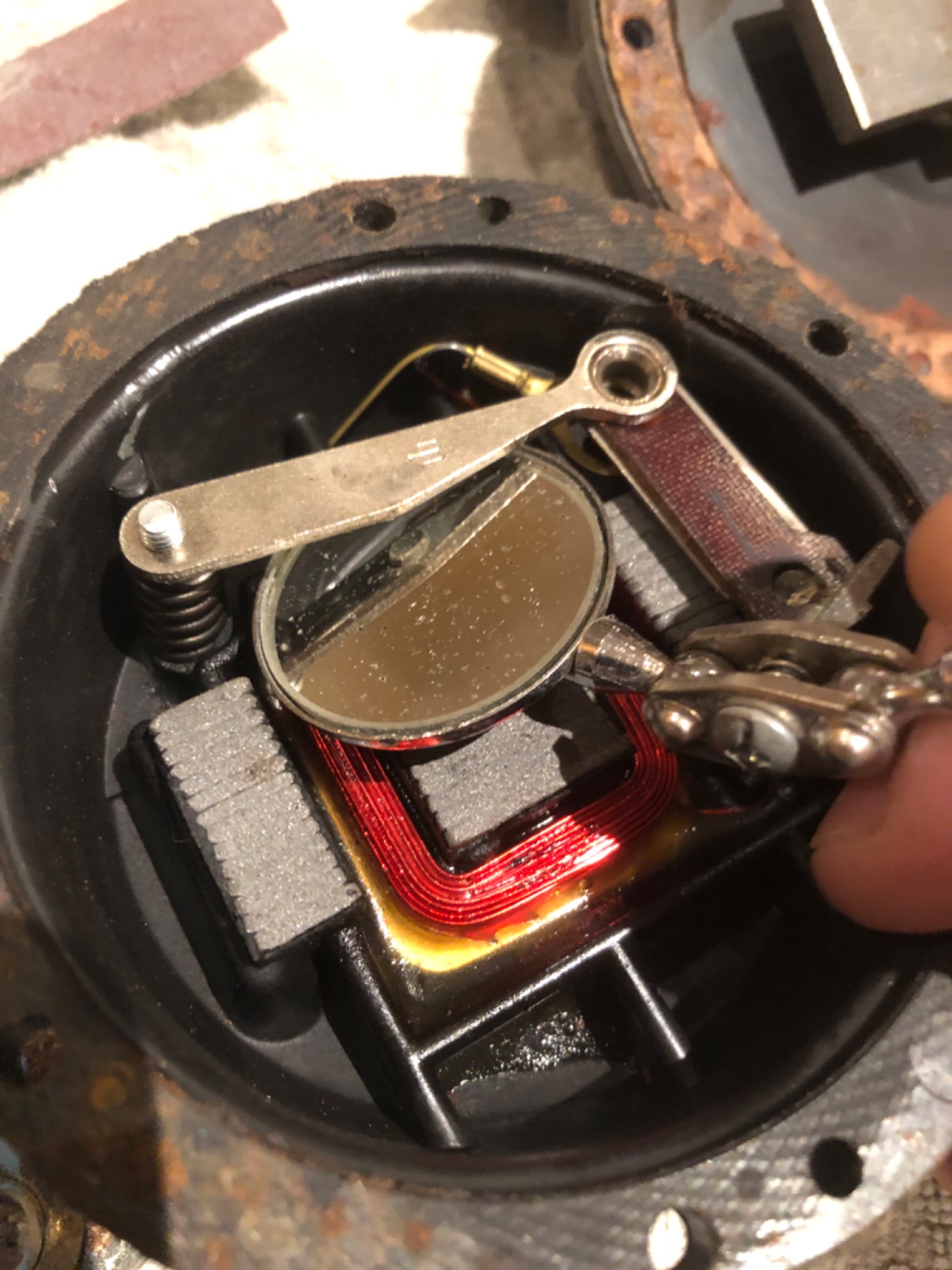

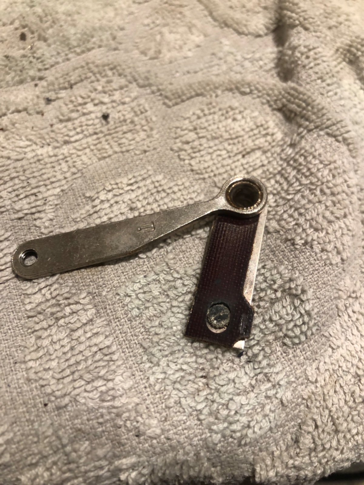

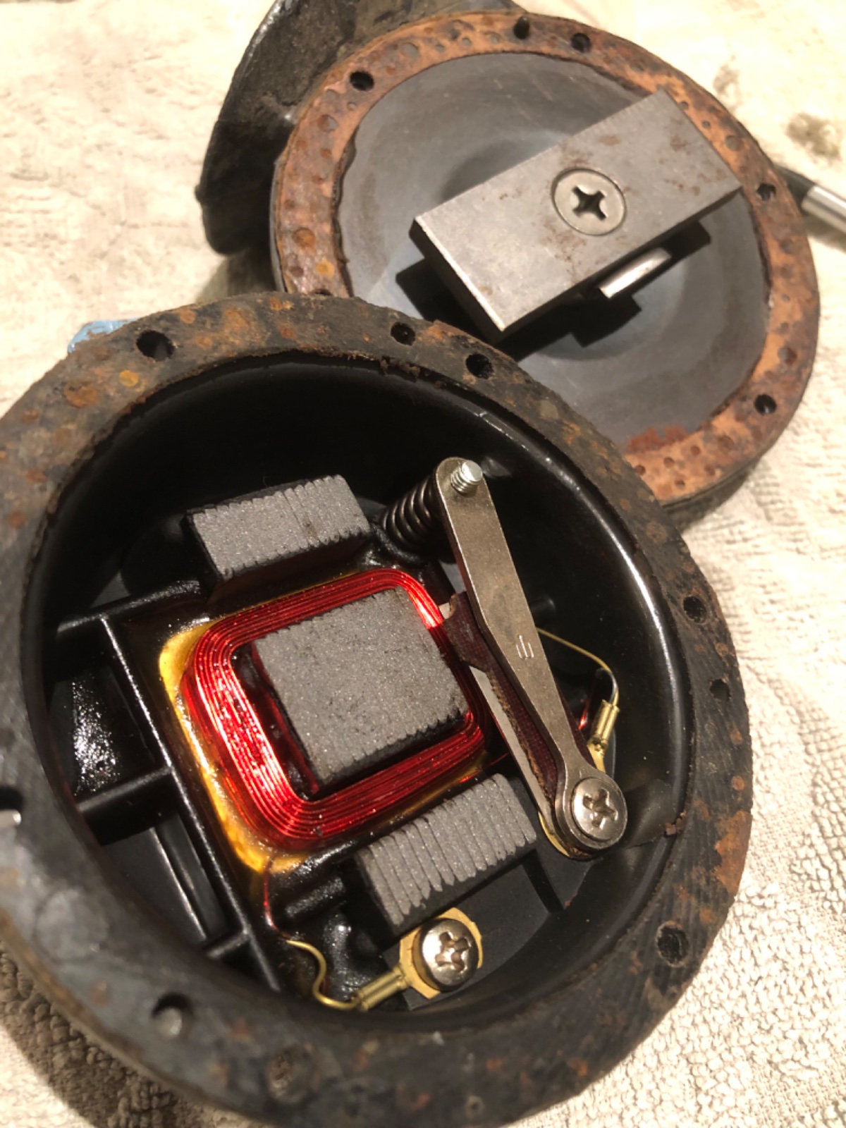

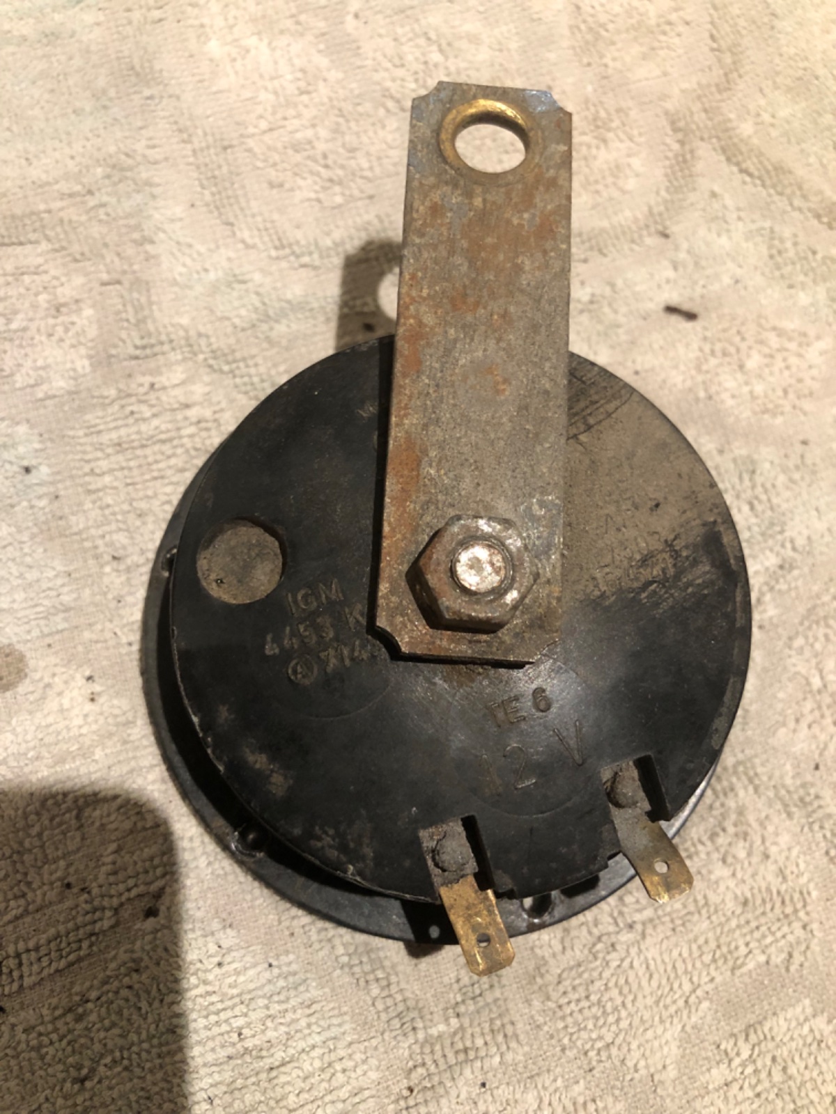

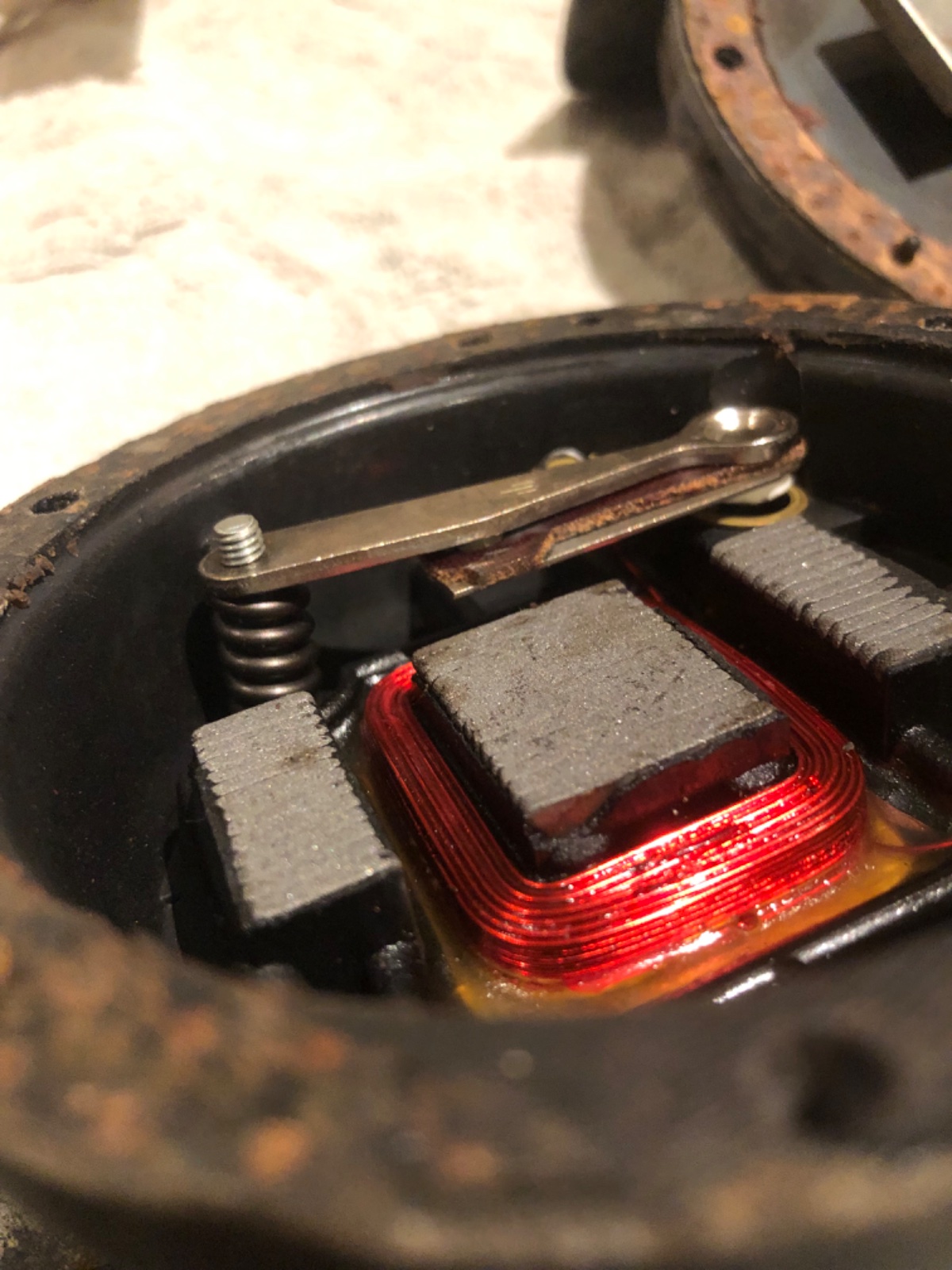

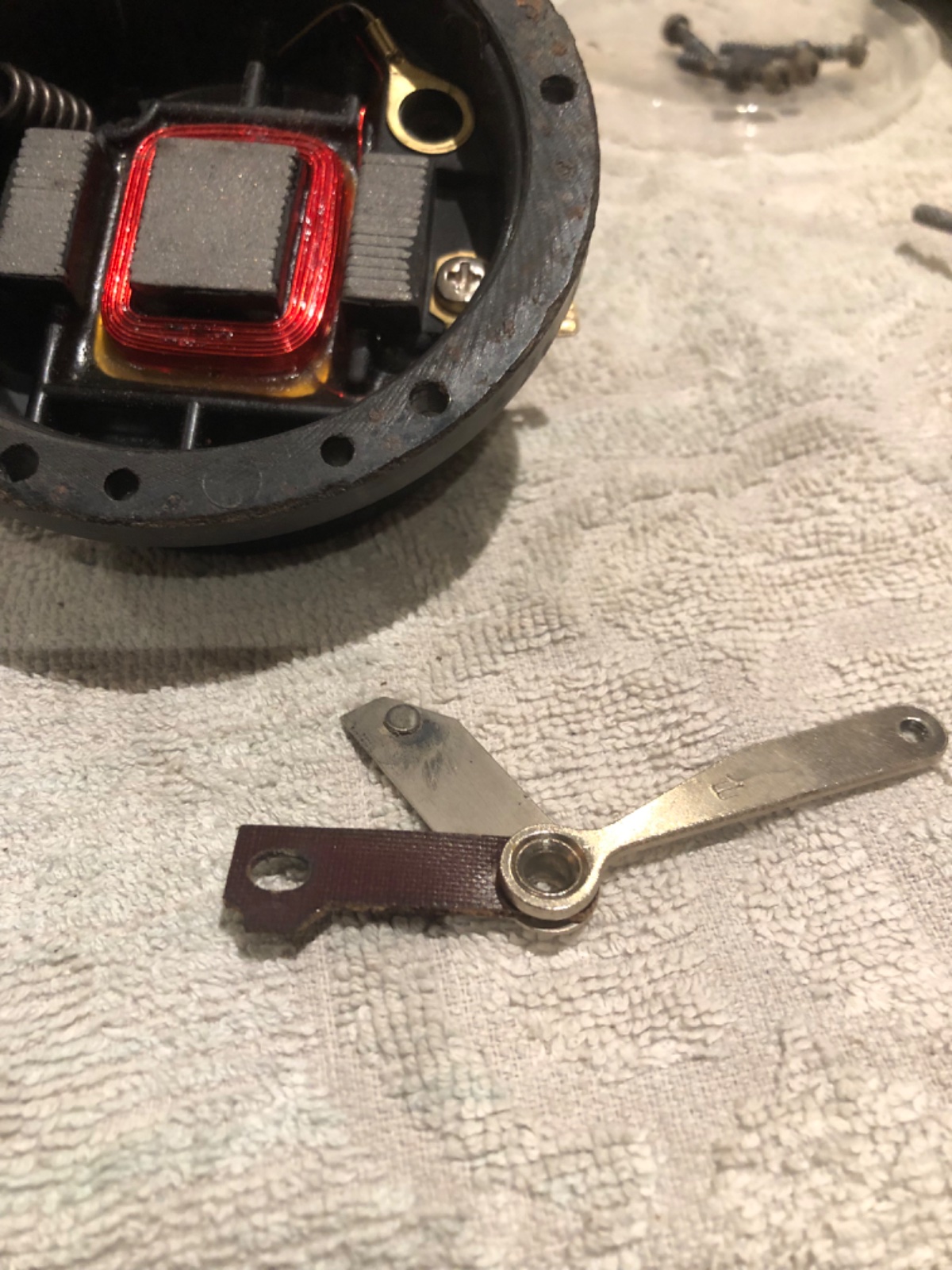

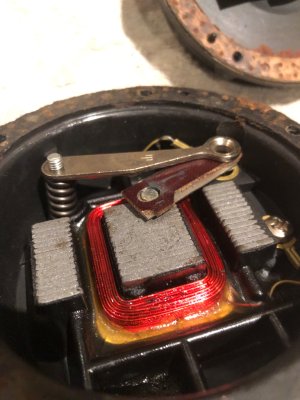

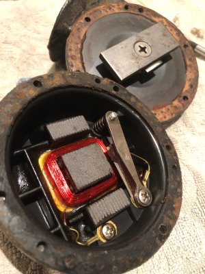

Here's what they look like inside, fascinating little things but I'm a nerdy engineer.
Mine did not work, took it apart and found rust had seized the moving parts. I cleaned and lubed, got them working again.

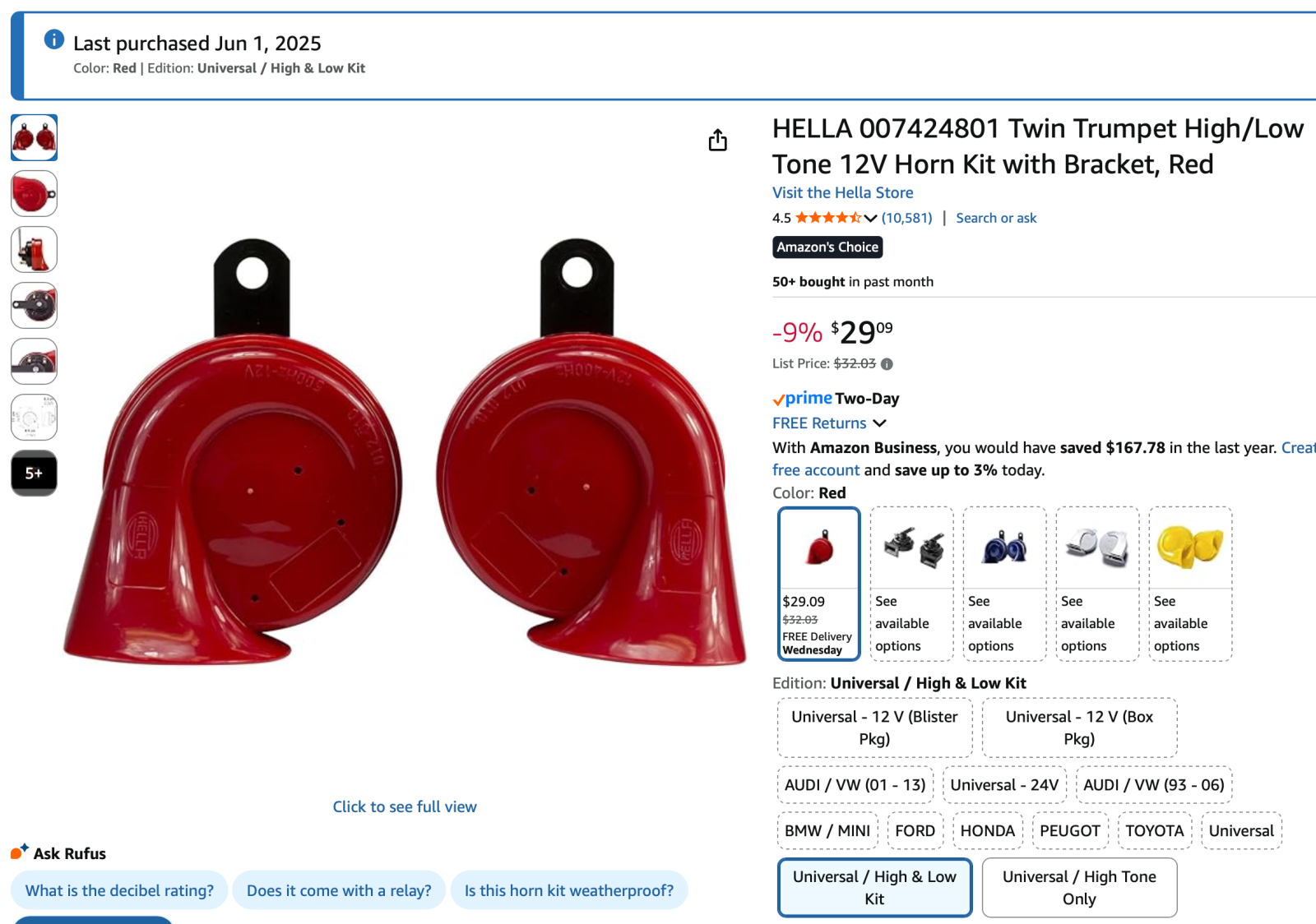

as long as the horn was grounded, it should sound when you apply power ... if not, then it needs to be cleaned or replaced. i took the quick approach and bought 2 from Amazon for 30 bucks. i am replacing the wiring harness from the relay to the horn, as well as replacing the ground wires from the horn (and lights). i have bought new spade connectors and the clear sleeves.

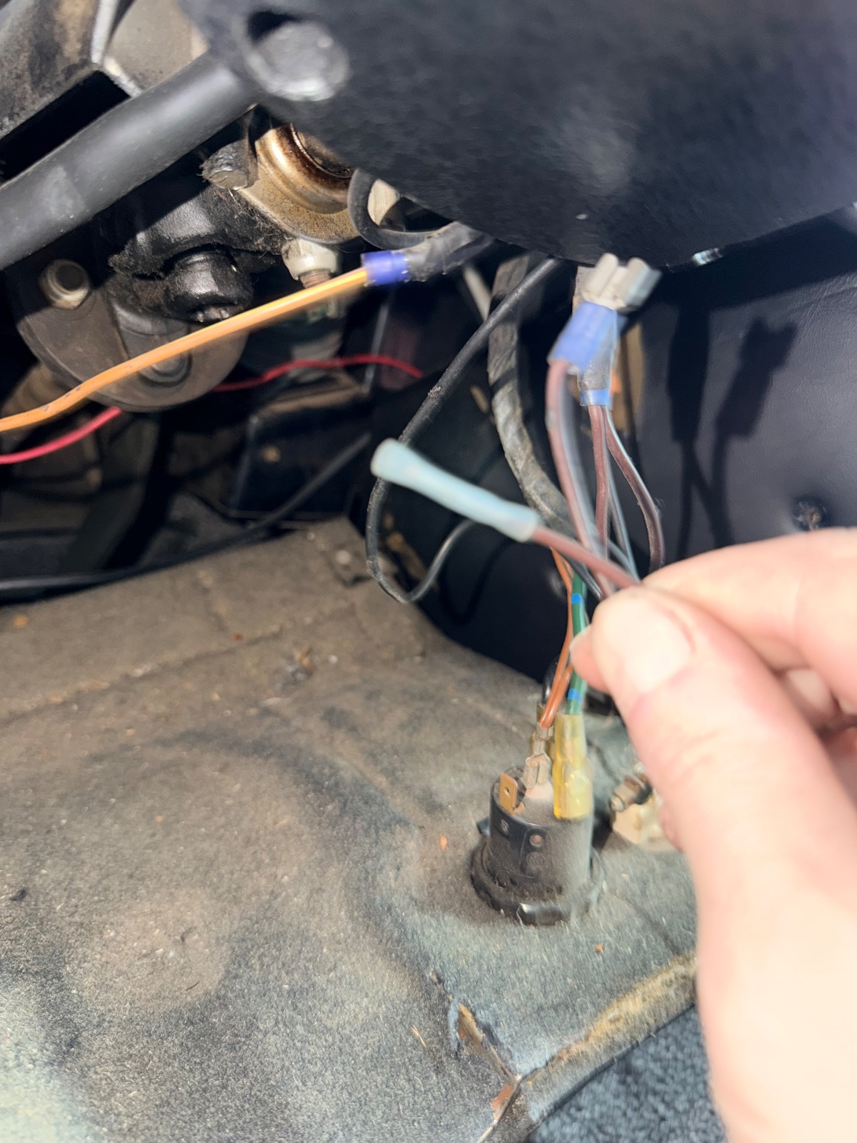

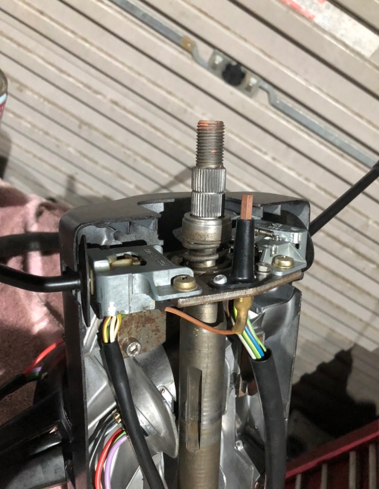

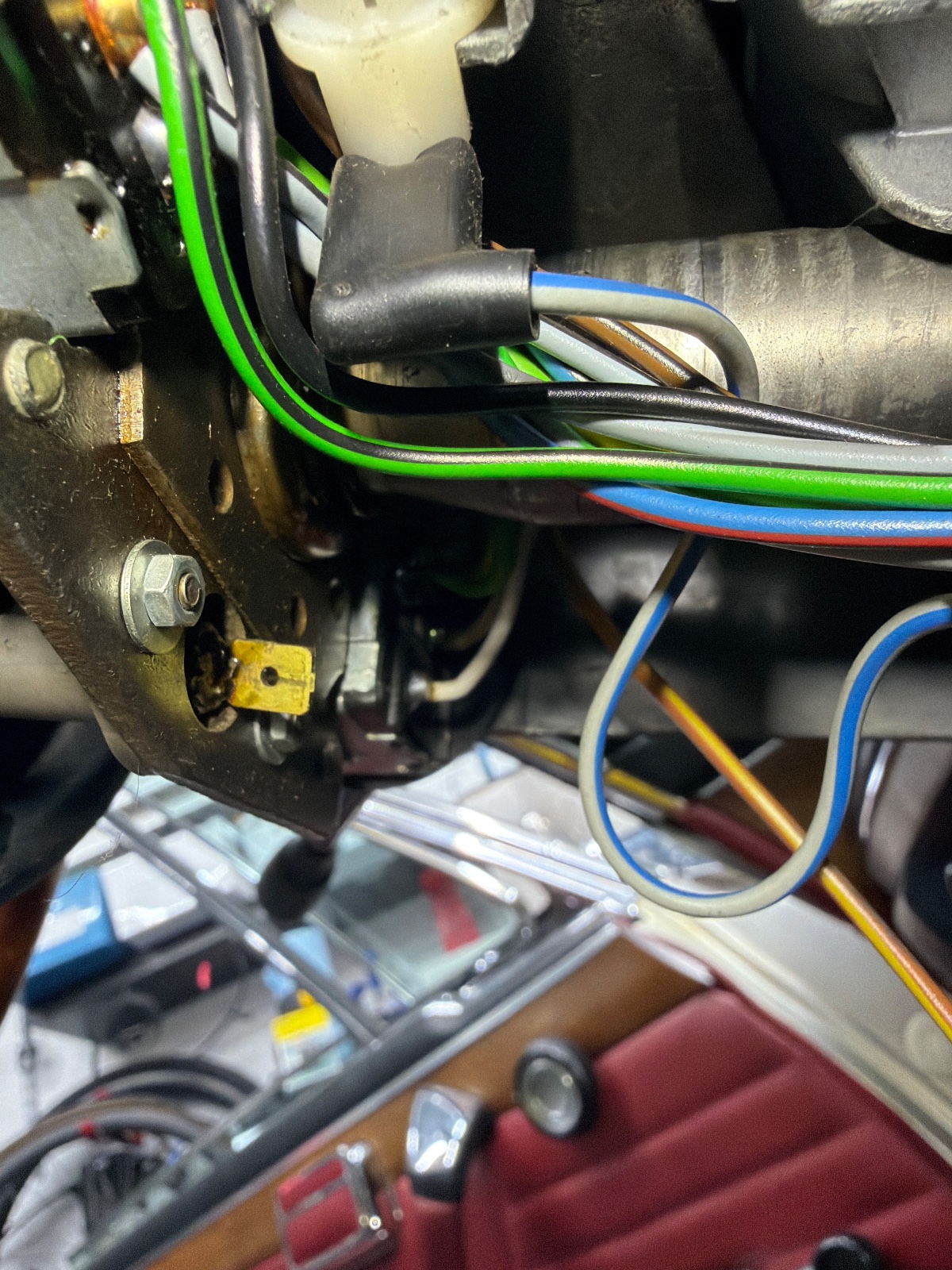

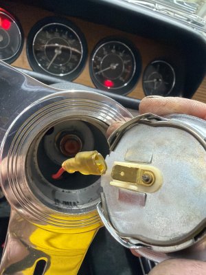

Ok, an update (and thanks everyone for going along on this journey with me). Turns out that my 12V tester was being nonfunctional and wasn’t outputting enough power to directly sound either horn out of the car. Hooking directly to a small 12V worked. New tester now will sound each horn, and if I power across the relay I get two-tone horn sound! So now moving up the chain, when I take out the horn button, I only see one wire leading from it down the steering shaft. I would have figured that there needs to be a ground on the other side of this switch but not seeing it. That’s also what the wiring diagram shows, so once again I’m confused. I wish I were better at wiring. As a neurosurgeon you’d figure I’m into the wiring (brain) but have gravitated more towards the engineering/mechanical side of the field (spine). Guess my work reveals my weaknesses…

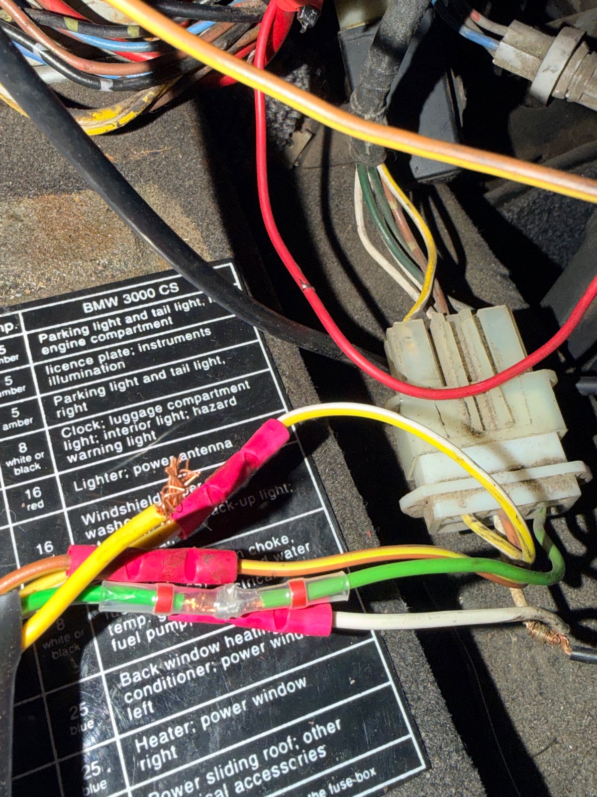

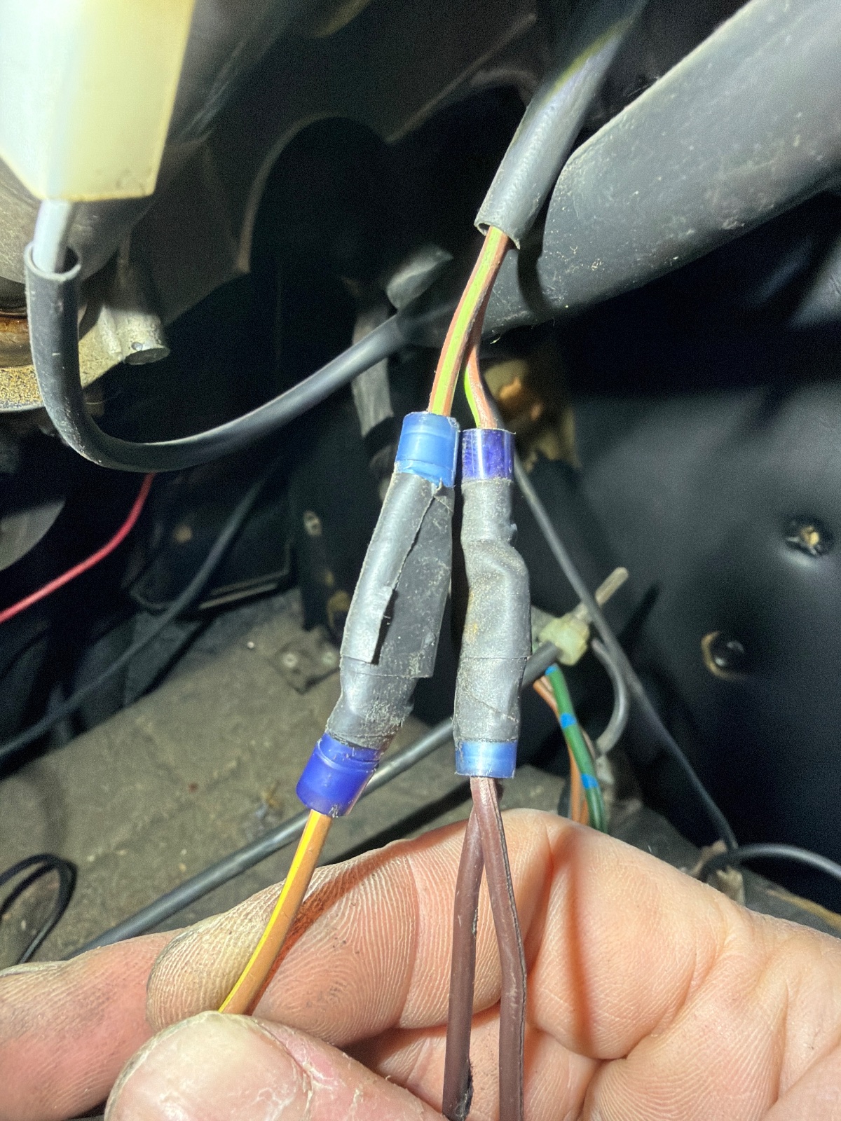

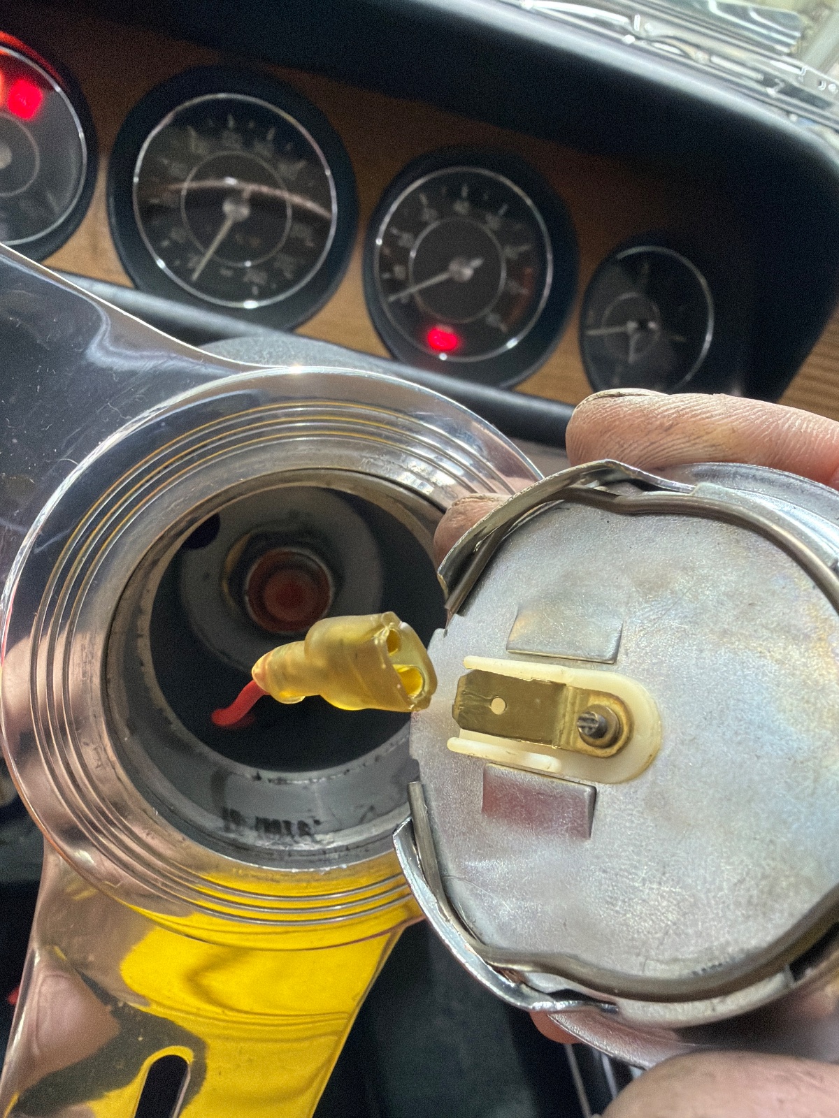

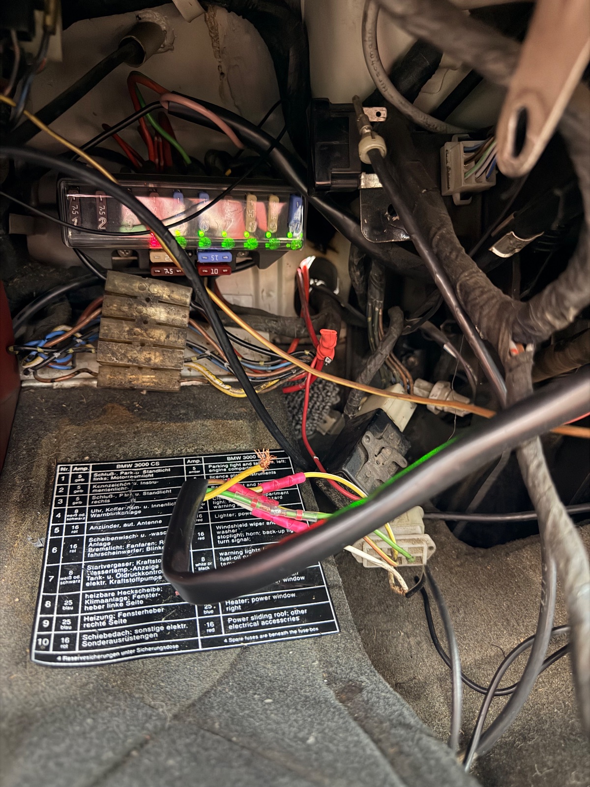

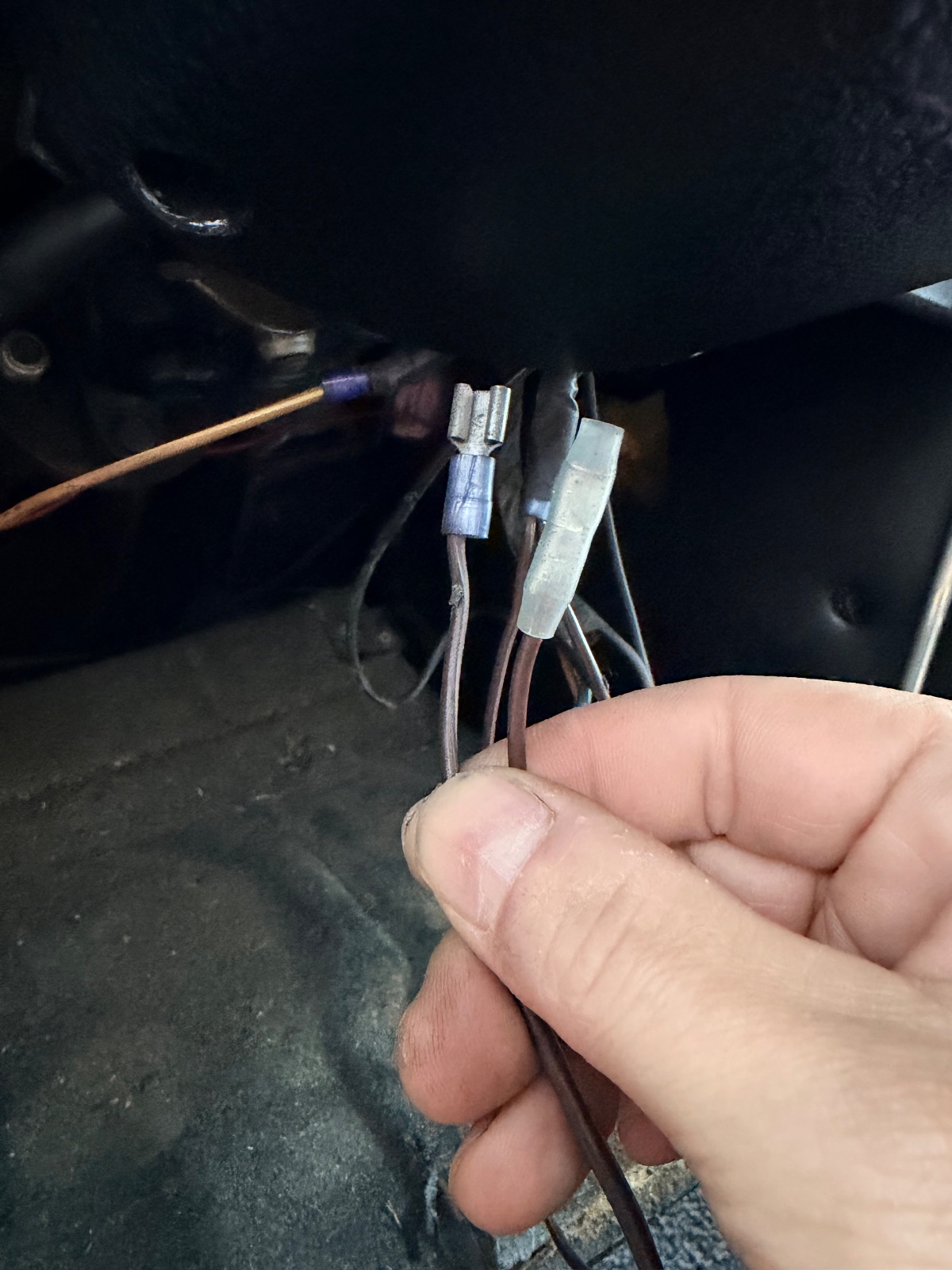

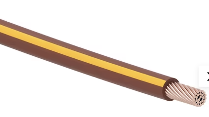

whomever was here before me decided that brown and green is close enough to brown and yellow that it shouldn’t make a difference, right?
I took the suggestion above and ordered an old wiring harness to try to keep these colors correct so I can actually figure out what the hell is going on here. I think my pain is making me realize I better make it simple for the person who might follow me. As it is this just isn’t cool. But I think I figured out the horn issue - there’s nothing connected to that spade connector on the backside of the horn assembly

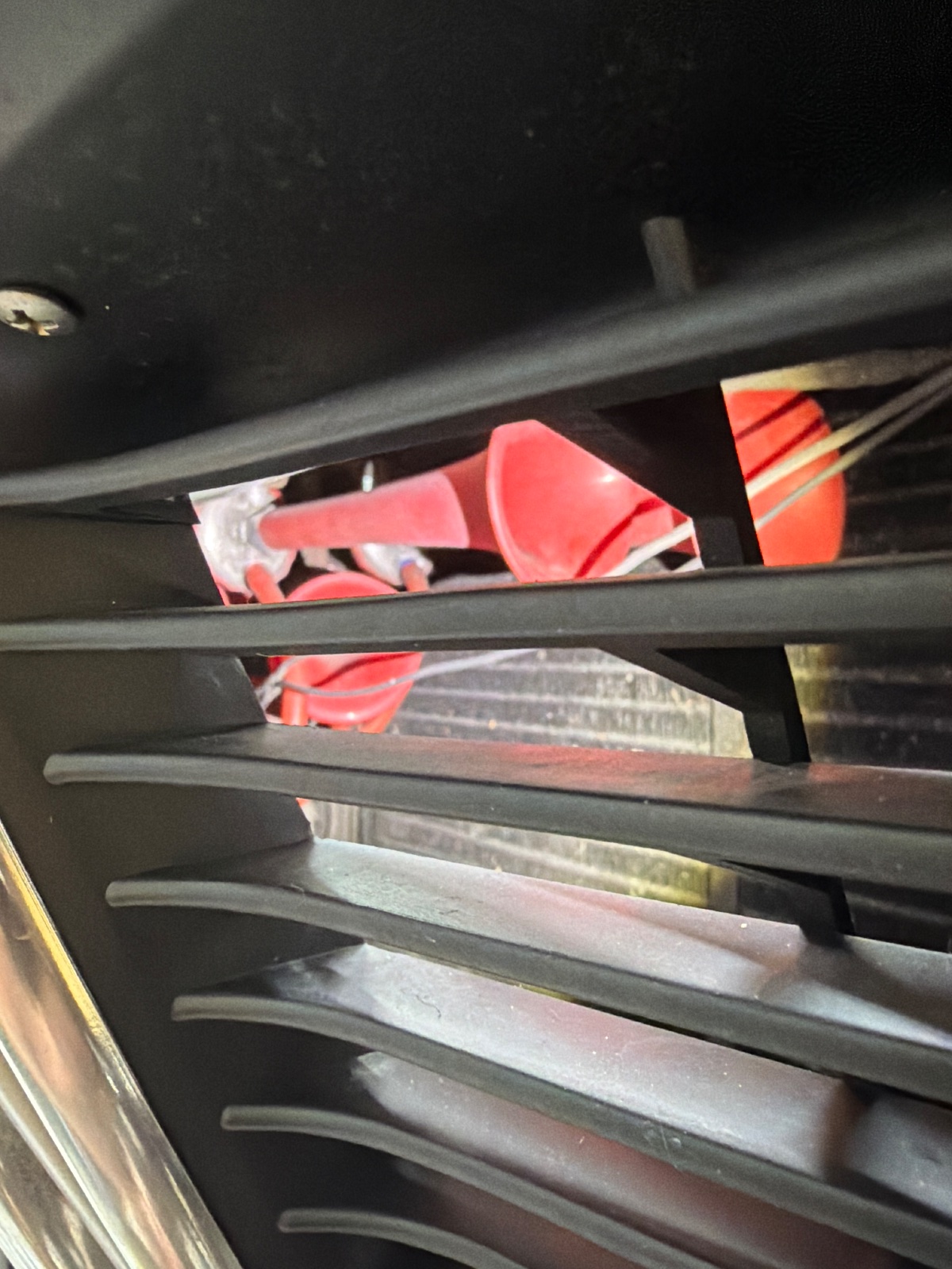

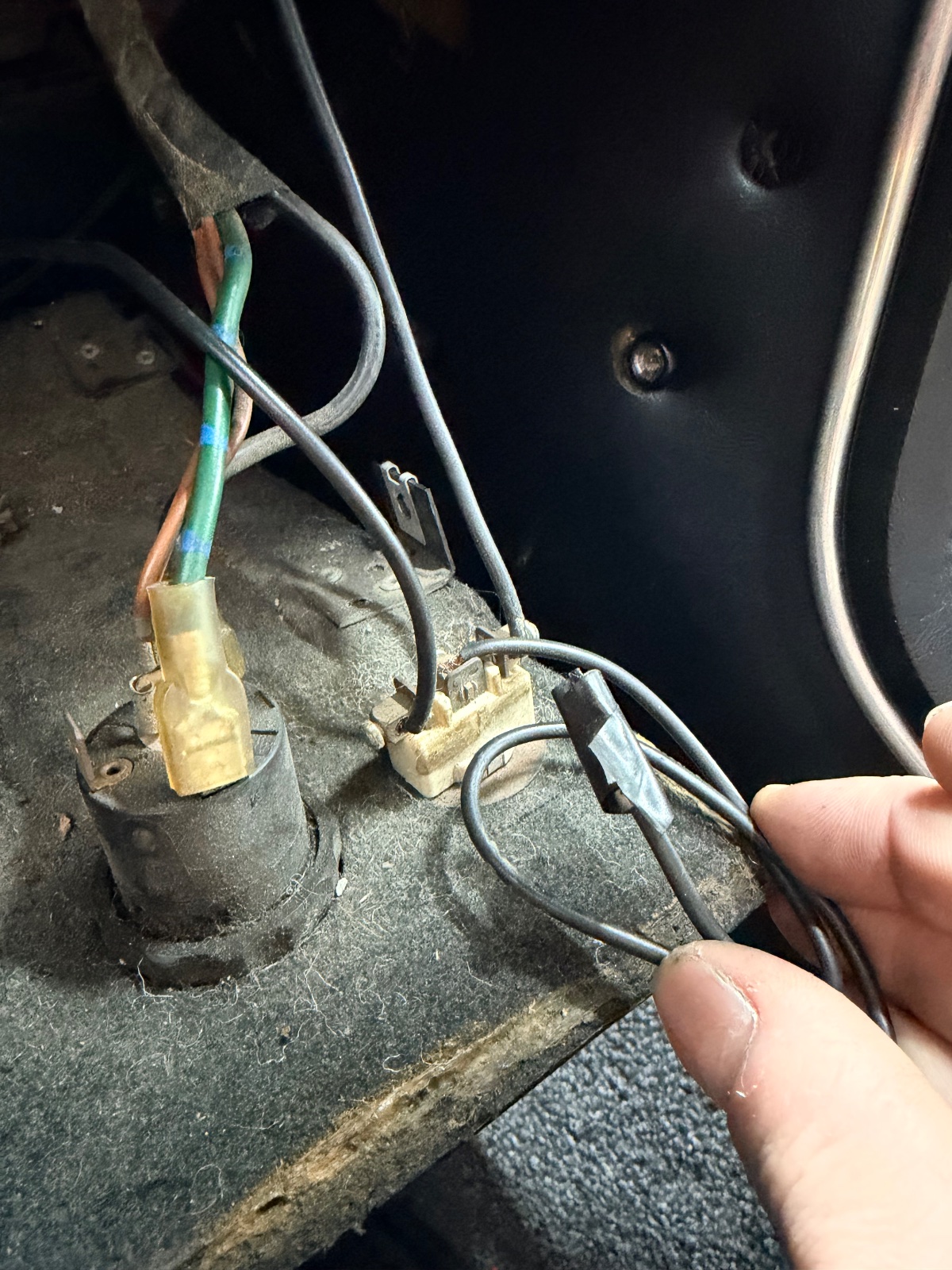

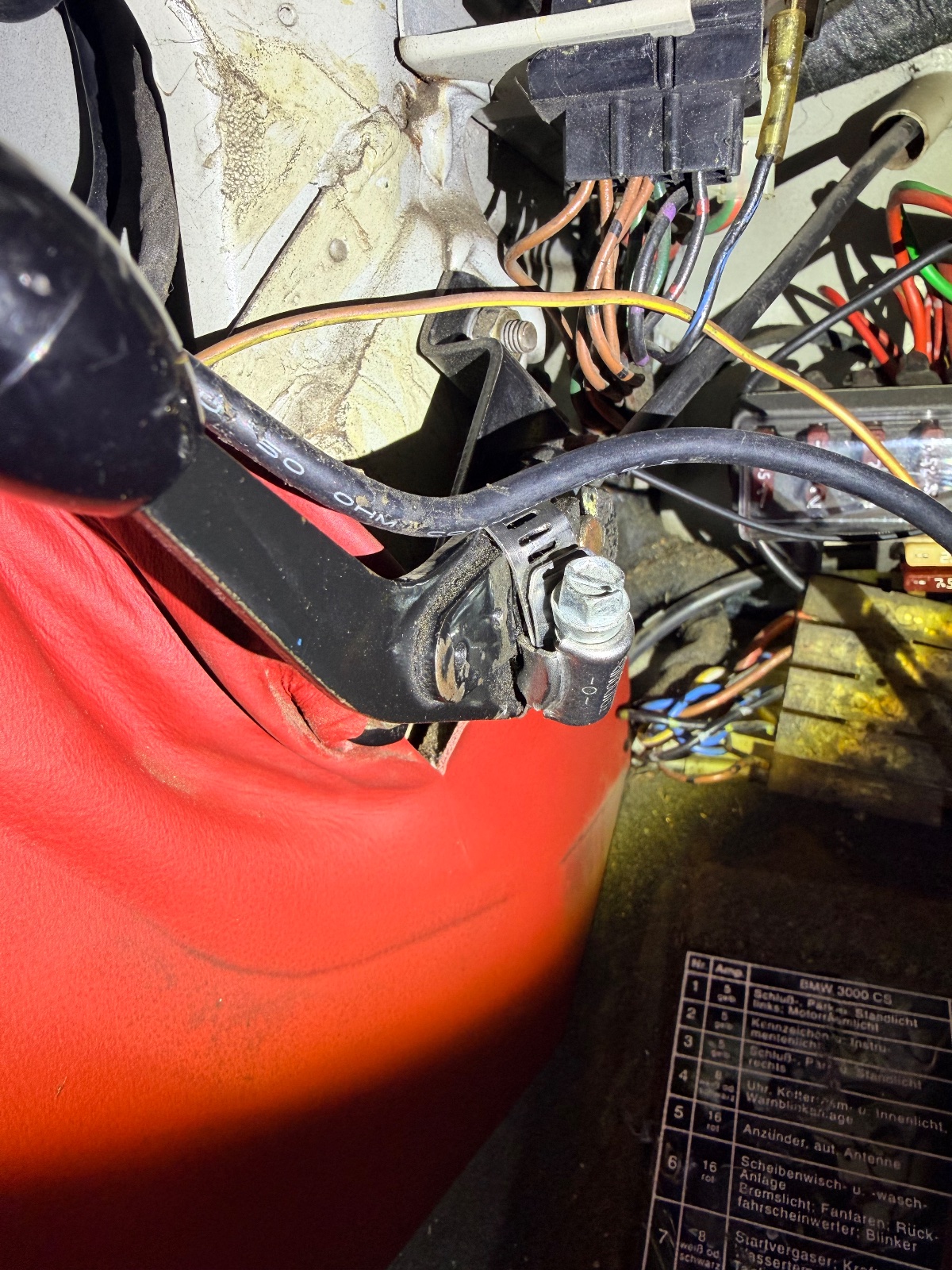

Sorry for multiple posts, but this just keeps getting crazier. I have a three-position switch located to the right of the steering column which is clearly an aftermarket add. It’s wired up to these red air horns that are mounted behind the front grille. What the hell is this and why? THESE I can get to sound with a horn button press now so someone assumed this was an upgrade.
seems your PO decided to go for a custom aftermarket setup on their horns, hence disconnecting the original wiring as they would not use the stock horn connector... your chance to rebuild back to original and get rid of the aftermarket stuff...

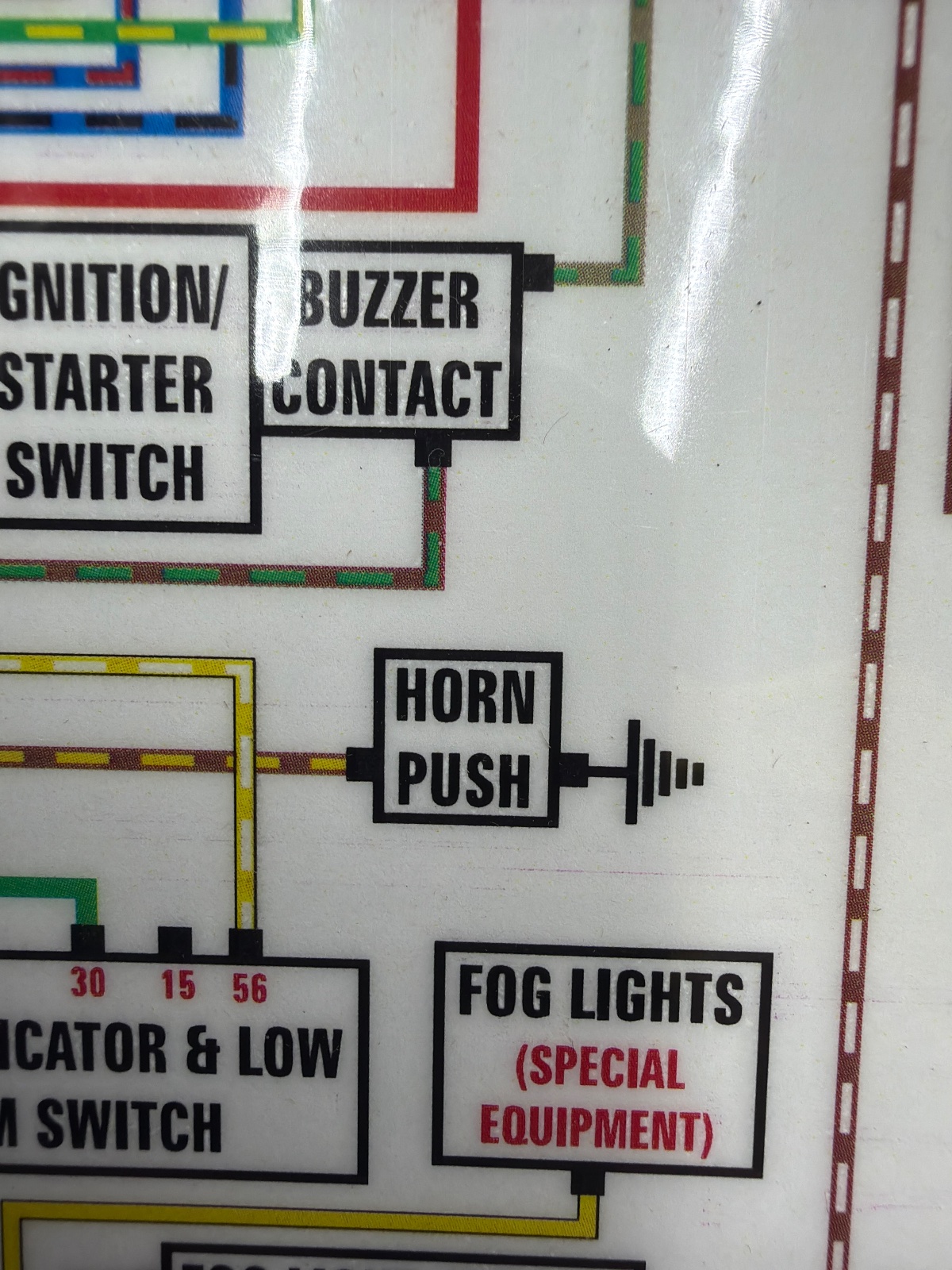

Hi

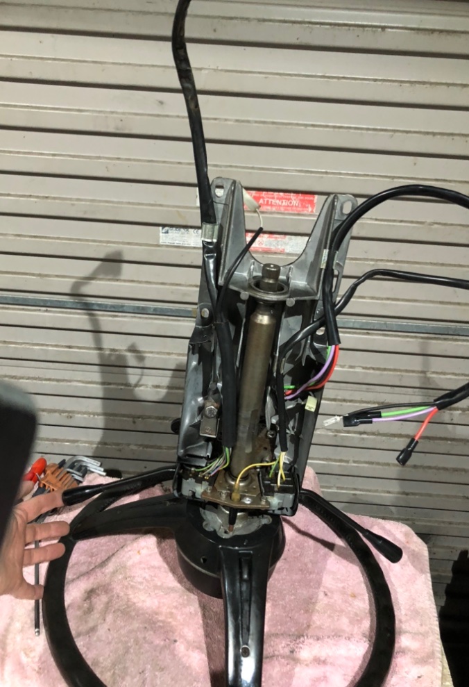

This is the wiring on mine before re installing it into the car .
She is a September 1973 Right hand drive Csi. ( I think some of the wiring changed at the factory from 1974 on )

Yep, you are exactly right. This has been an instructive evening. So I think what I’ve discovered is that someone added the air horns but installed a 3-position switch so moving it to the left would allow for one set of horns with button push and to the right would allow the original set of horns. Middle position disengages both. No idea why this was the decision, and in order to add this switch they moved the hazard light up to the upper half of dashboard and put this switch in the hazard light position. To add to the confusion at a later point someone disengaged the connection between the horn button and the switch so neither would work. Would love to understand the course of events that led to this outcome. Well, regardless it taught me something about how to figure out the wiring and inspired me to correct the incorrectly-colored wires as well as we all had a good discussion of various horn options including rebuild vs red vs black Hellla aftermarket ones from Amazon.

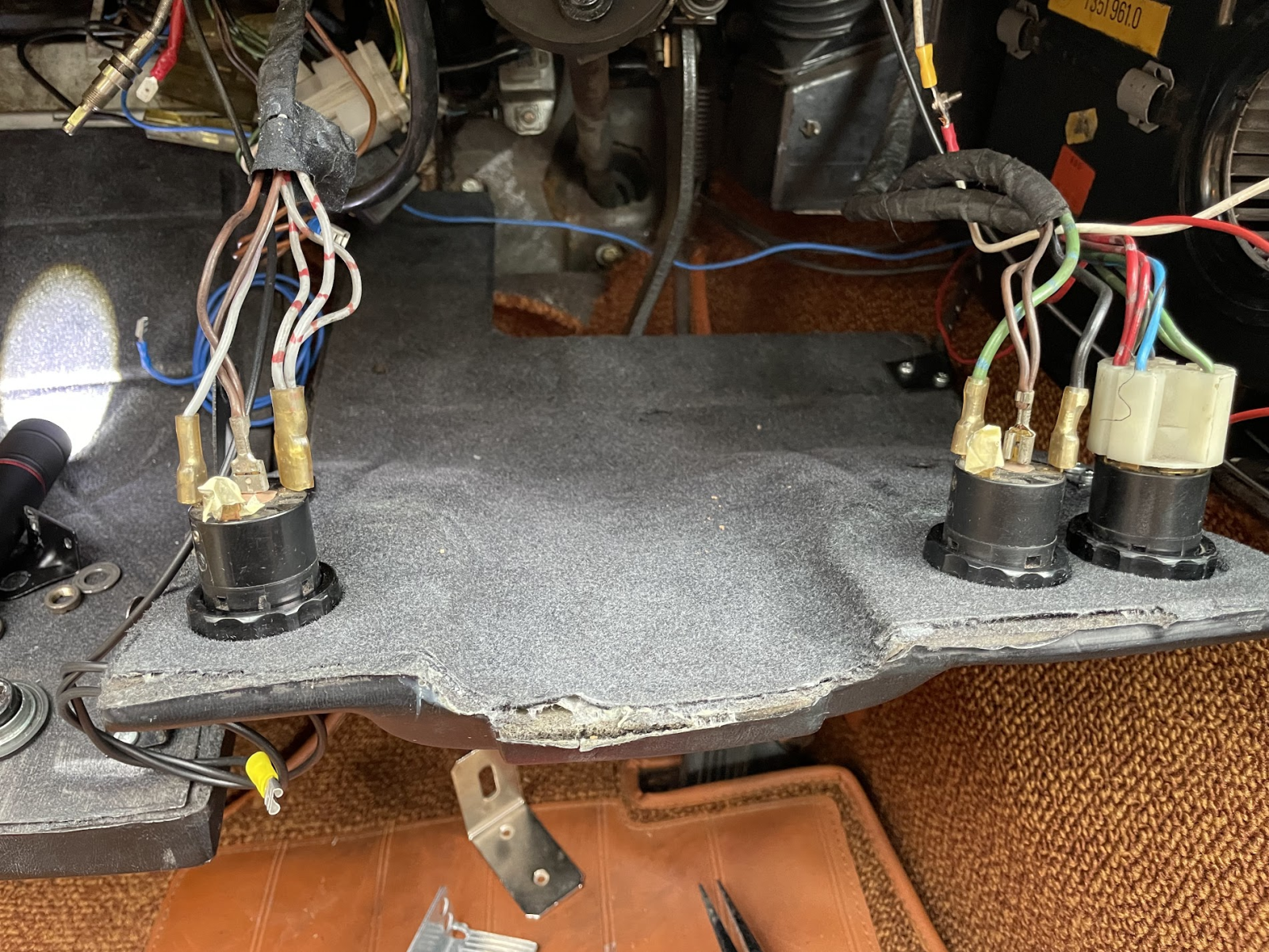

@HB Chris - ok, that's good to know. THe owner's manuals that came with my car are for the 2800 and then have small <20-page "additional" manuals to address the 3.0 and 3.0 CSi changes, but there isn't any note made of these changes to the dash. So if the hazard light is in its "correct" location on the dash rail, what would normally have been sitting in that right lower spot (just to the right of the orange button) where the PO placed a three-position switch? This is an area that doesn't tend to show up well on photos from any prior auctions, since the steering wheel sort of covers it up.
on my 1971 3.0 CS the hazard switch sits under dash, beside the fog light and rear window defroster:
I did understand the hazard switch moving up into the dash rail did come on later cars only (73 onwards)?
Europe got the 3.0 before the USA and production of the 72MY was July of 71 for the US and that might be why some euro coupes still had it underneath.

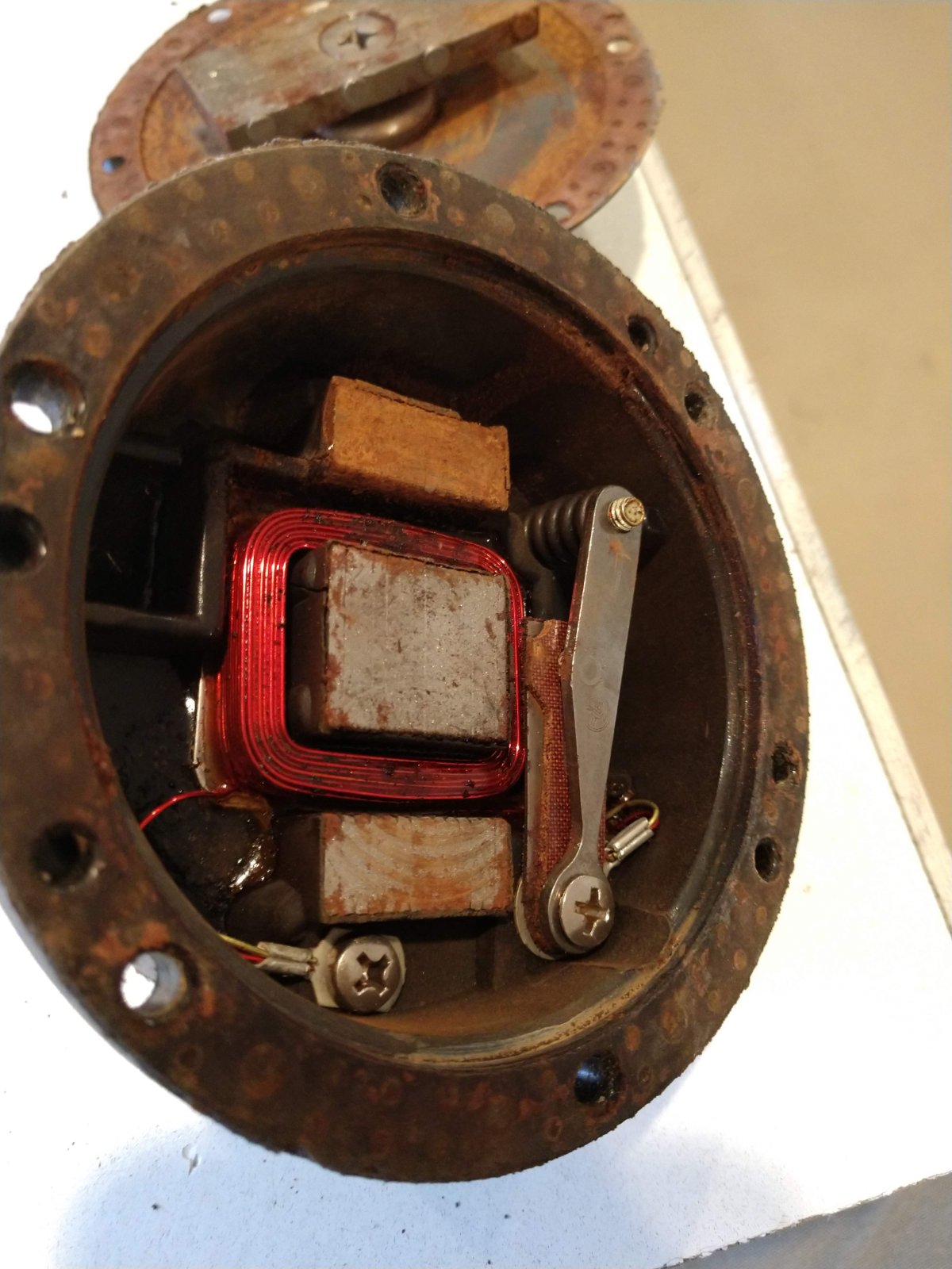

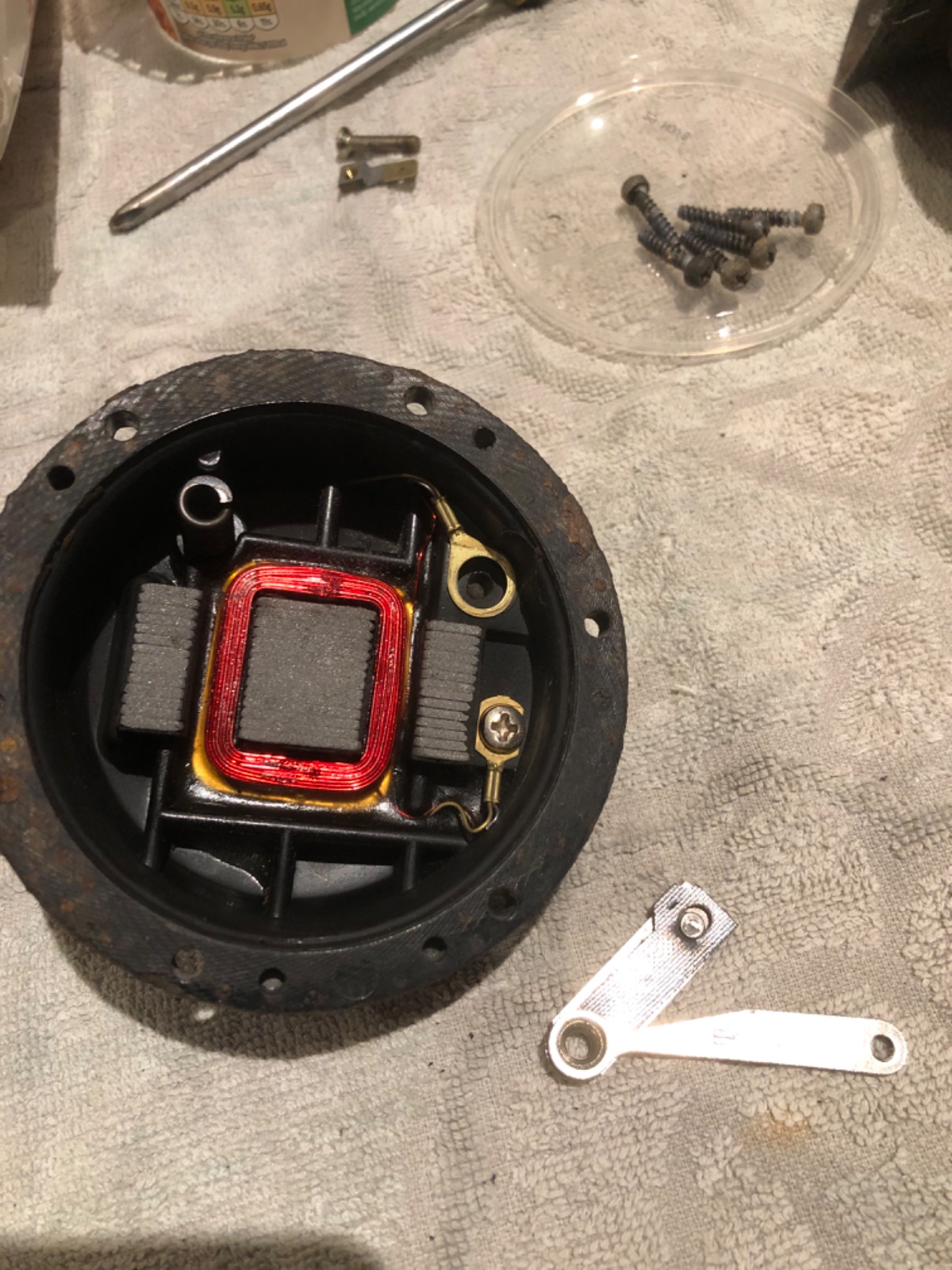

Hi Thomas
I opened mine up this evening expecting to find something obviously wrong or seized , but nothing looked obviously wrong.
I checked the coil with my multimeter and it seems to be good .
Did you remove any internal parts ?
Which terminal is the positive and which is the negative ?
Any idea what I should be looking for in there ?
@Barry.b negative or positive don't matter on these, it should sound either way. Are you getting any sound at all? I got a "clunk" when I first was playing with them and then after taking apart and using a little alcohol to clean the connections and putting a little lithium grease on the arm and rubbing it around with a q-tip I was able to get full horn sound. You did confirm that you had checked these on the bench with a separate 12V battery directly - try again after the above. I didn't see that removing the screw hidden under the little resin plug was going to help much so didn't bother with that.
Hi guys
Thanks again for the helpful info.

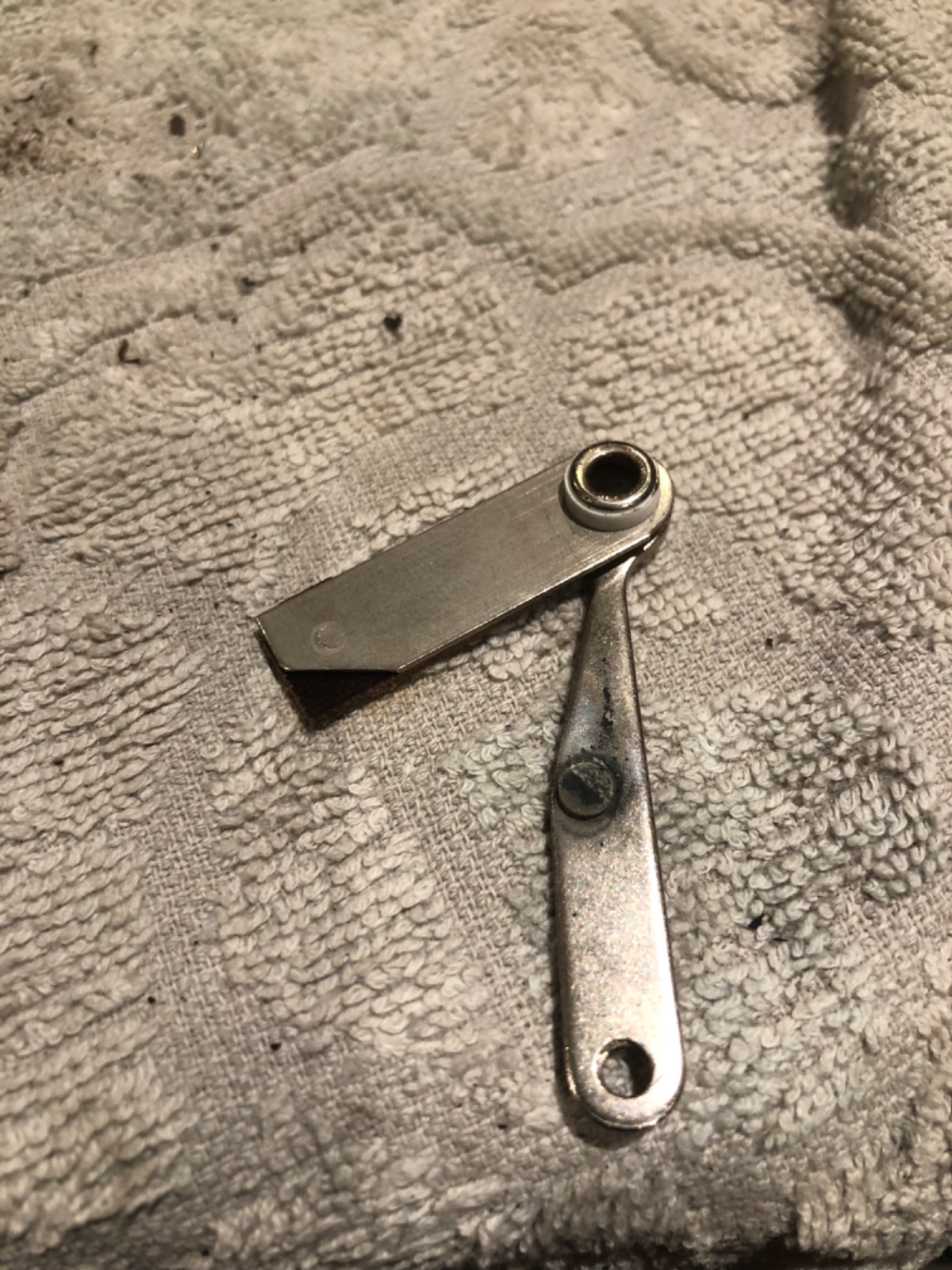

I took mine apart again last night and found that the points / contacts inside the horn itself were corroded so much that they were no longer making an electrical connection with each other.
I tried sanding/ cleaning the connections while still inside the unit, but that didn’t work, so I had no option but to remove the resin on the spring side screw and remove the contacts and clean them properly on the bench .
Then after all that, I reassembled and tested them on my bench ( kitchen table :) ) and they now work perfectly.
That’s another job off of my to do list and one more original 1973 part back in working order.
