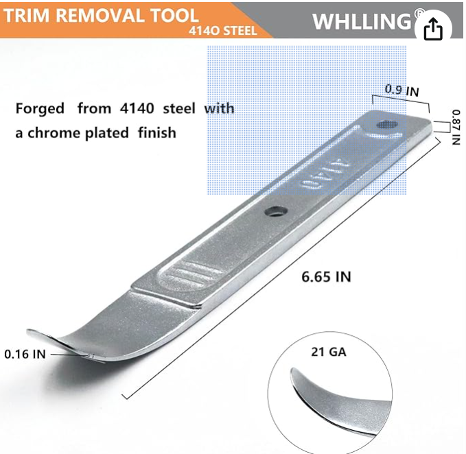

Every tool box should have a 4140 tool. Available on Amazon and other sites.
