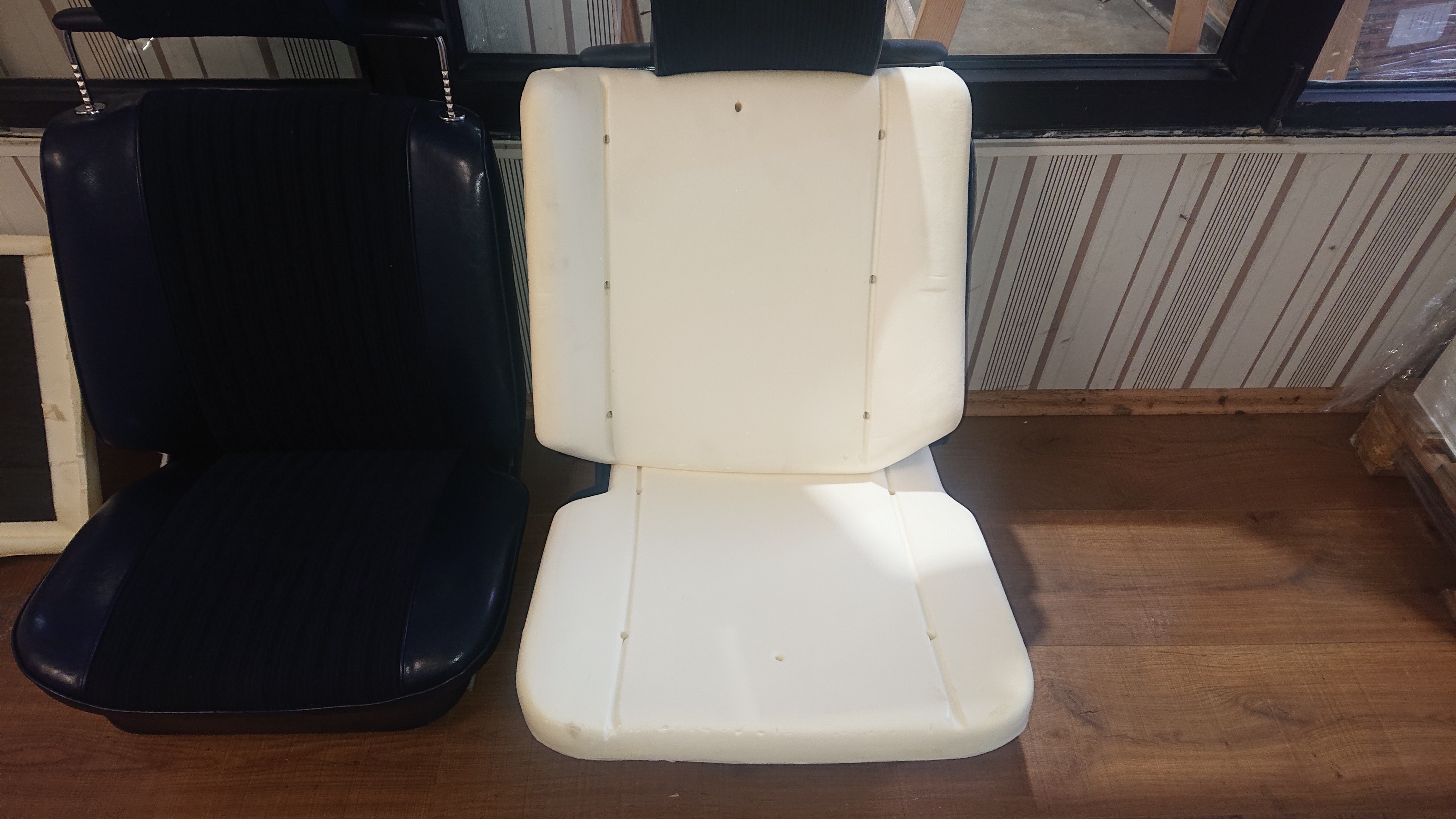

I recently recovered my seat bottom spring with 3 layers of foam - high density to soft, following upholstery industry recommendation. Pretty happy with results. PM if you'd like foam numbers and source, and pictures of the process.
