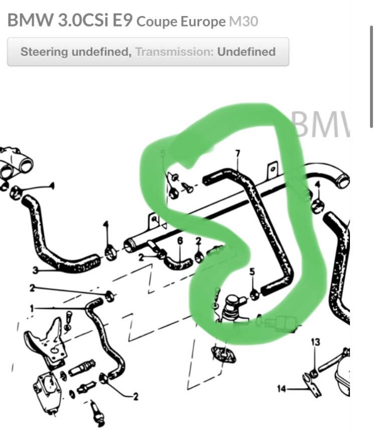

Does anyone have a part no. (or fiche no.) for the hose that goes between the d-jetronic throttle body and the hose fitting below cylinder no. 6’s intake port?

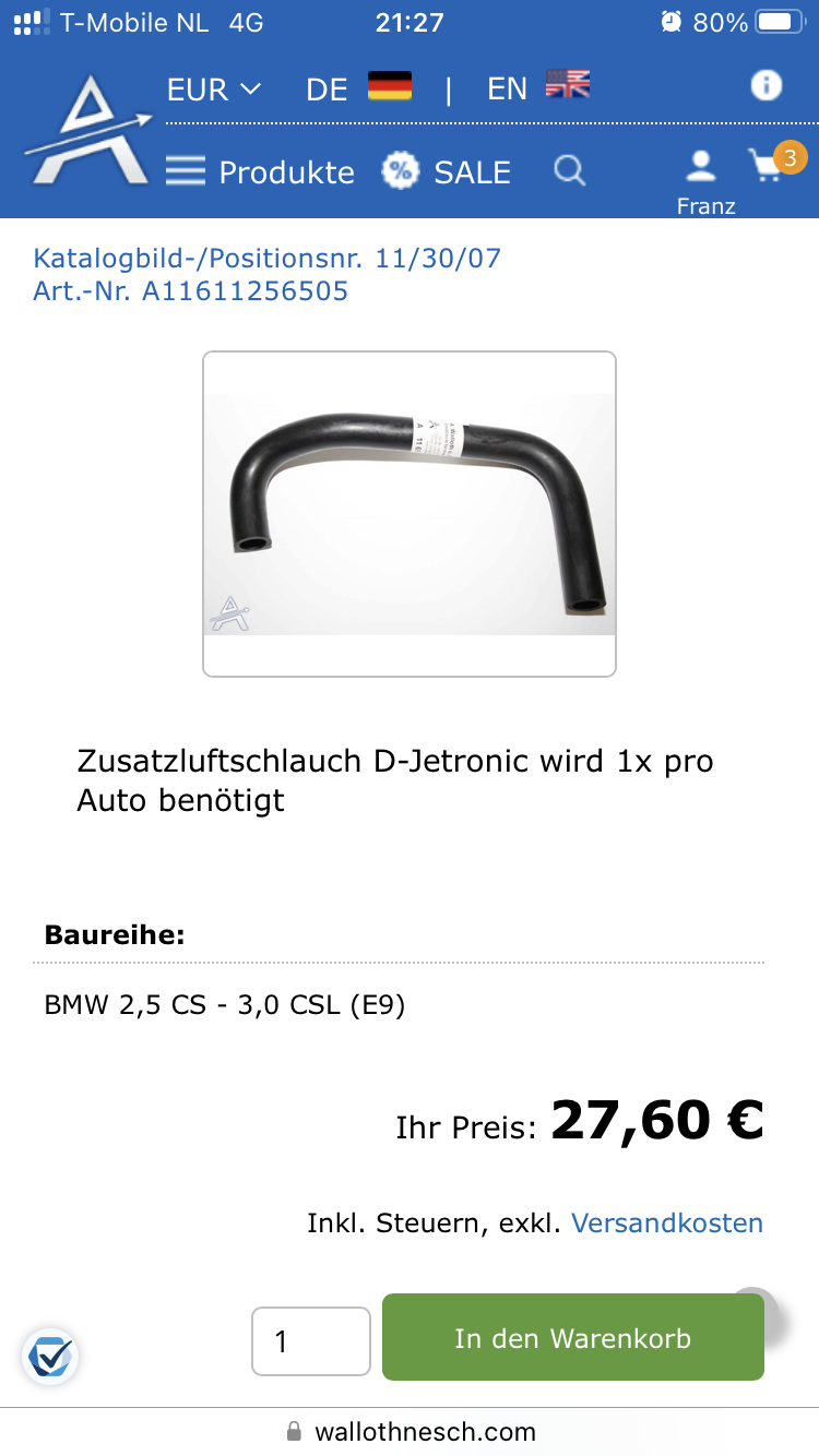

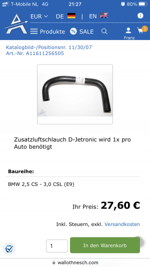

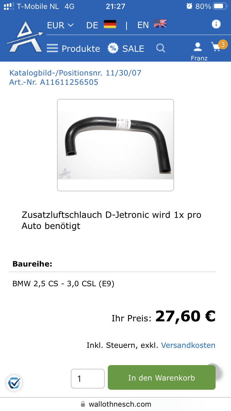

Hello Jasper,
Do you mean the house as in attached picture?

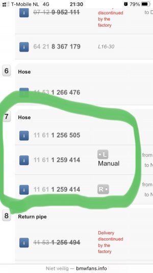

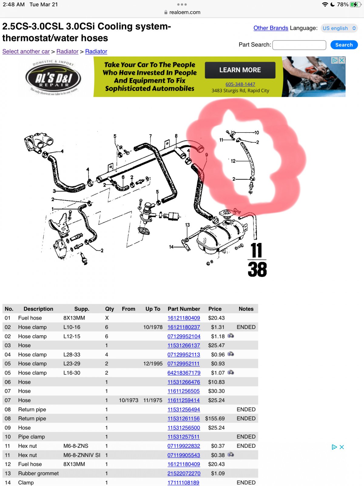

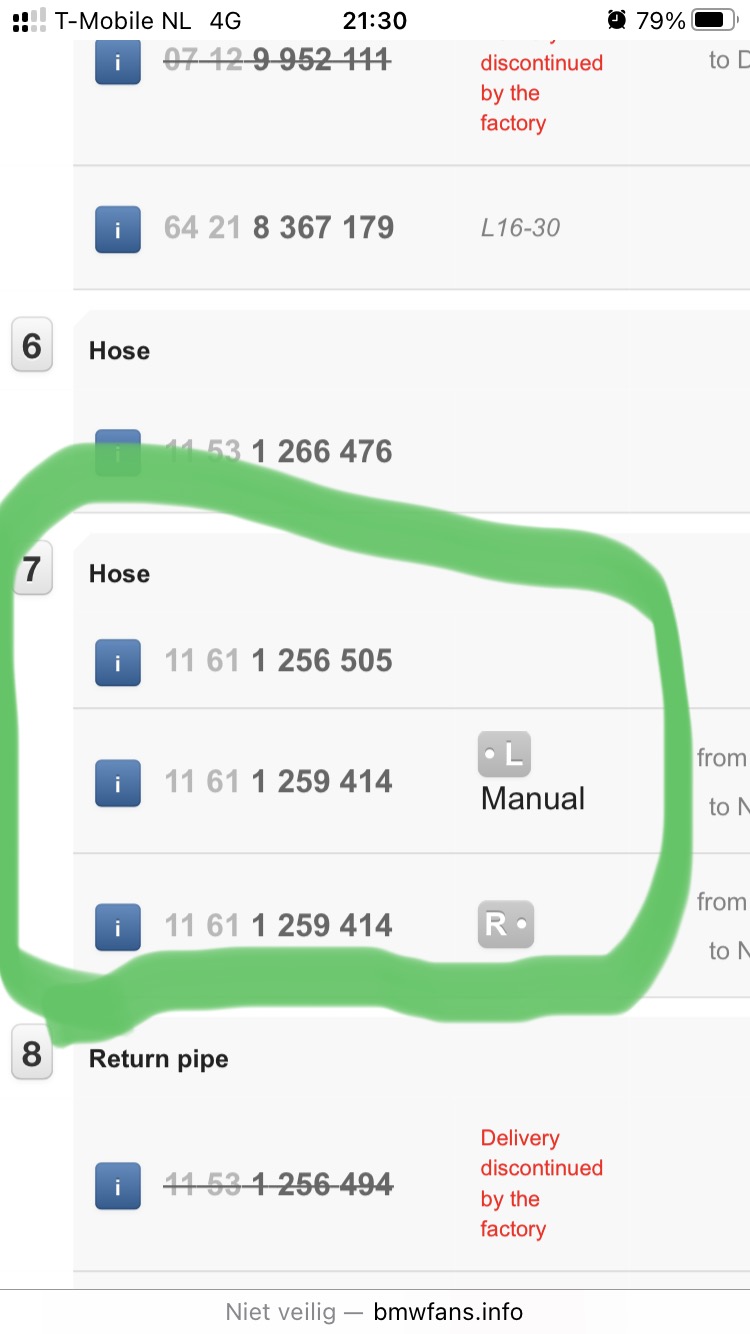

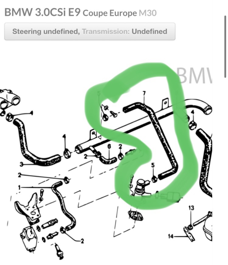

Hello Fritzie.
Nope. That's an air hose from the plenum to the aux air valve. I'm searching for the coolant one that runs from under intake #6 through the 4-5-6 manifold up to the throttle body heater. I can't find it anywhere in the parts book.
/Jasper

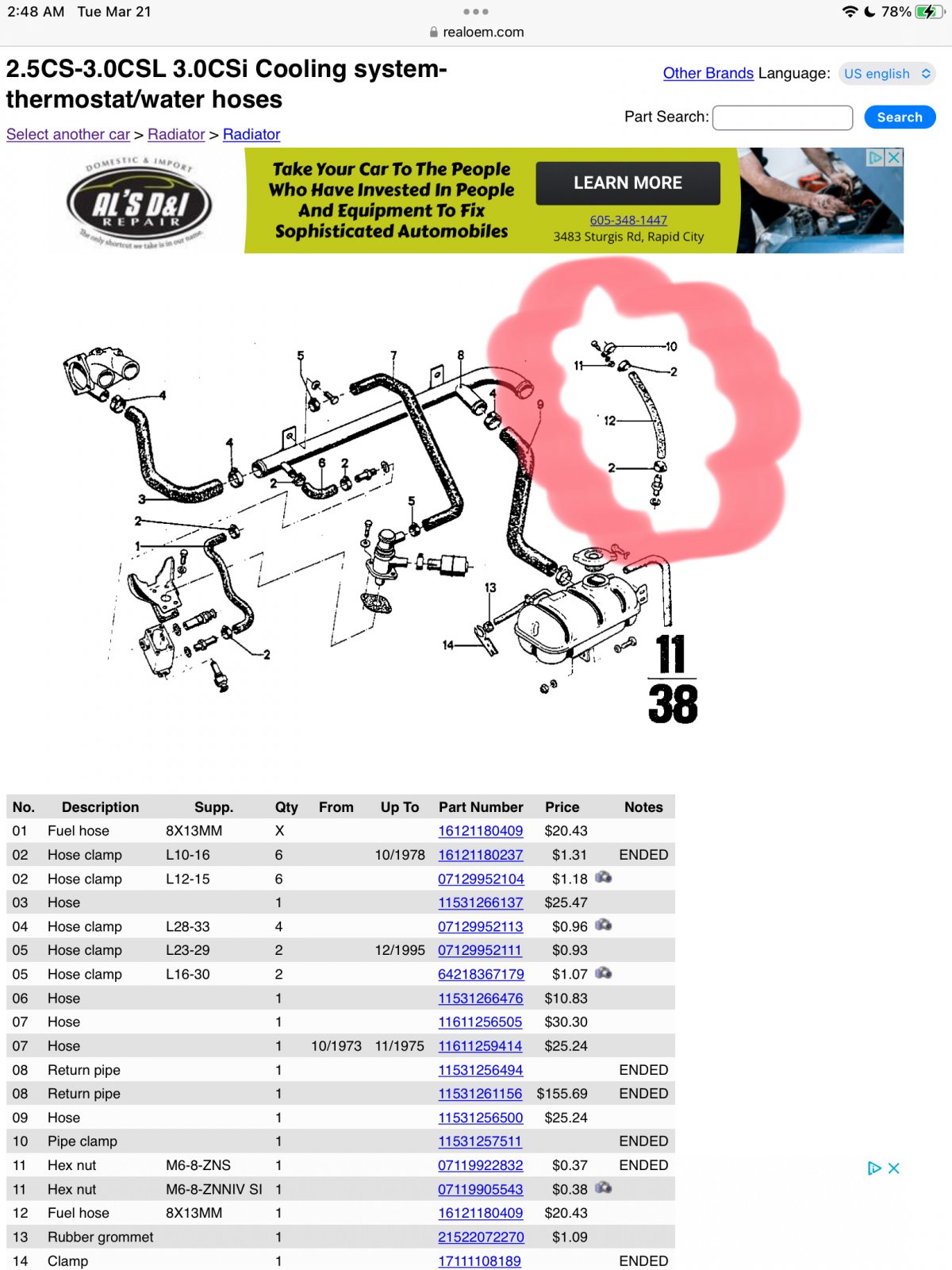

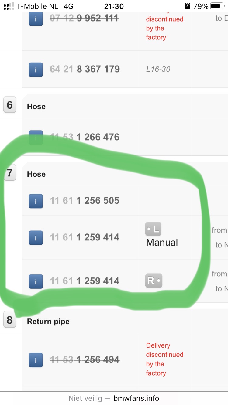

From the fitting at #6 on block to bottom of throttle body-
