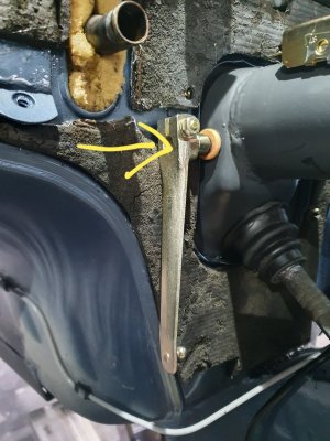

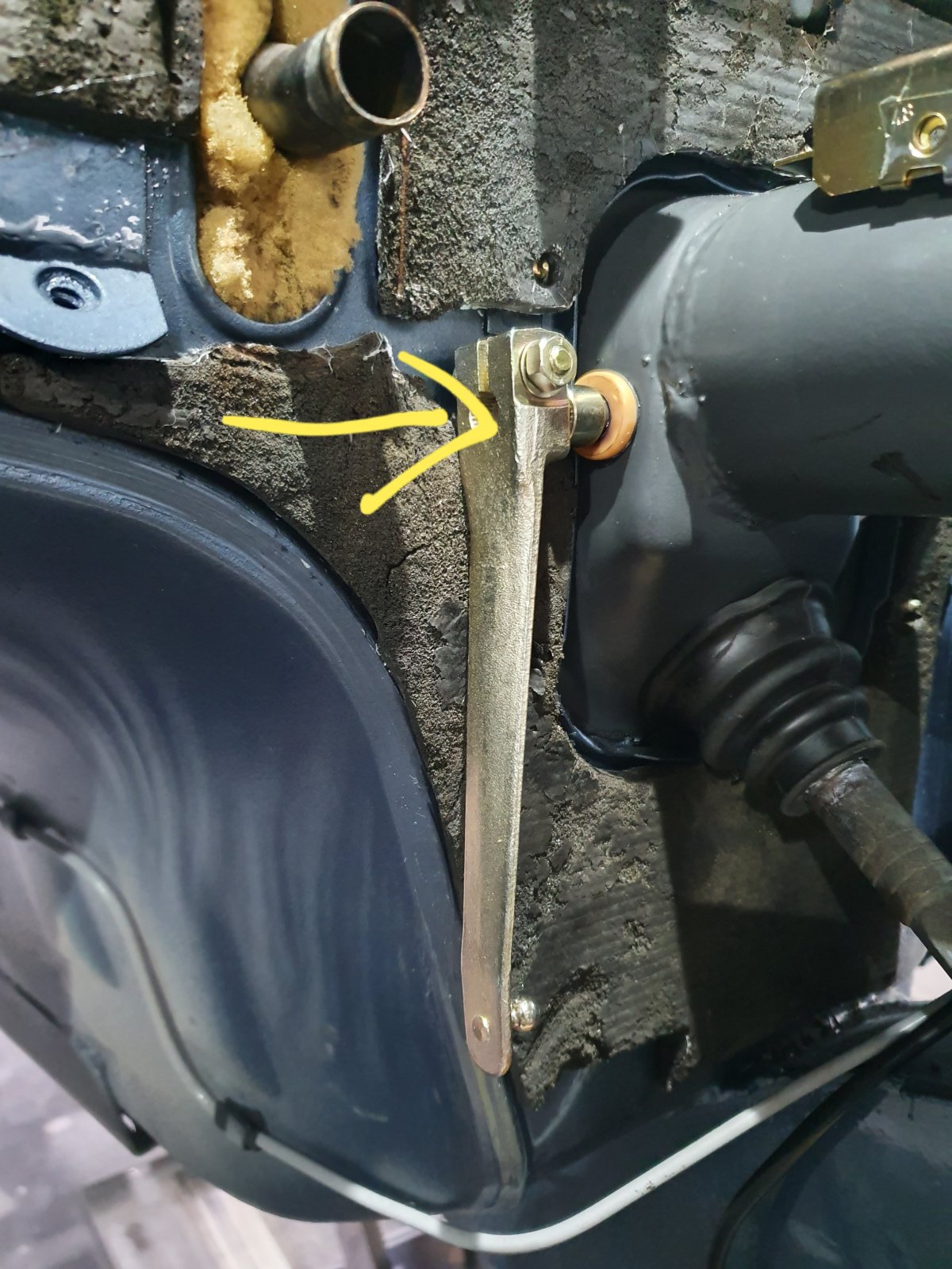

I forgot to mark the throttle link on there firewall.
Anybody know, how I stick it right together?
Thank you
Breiti
Critical- do NOT install bolt and nut backwards especially if you use wrong bolt length.
Your throttle will stick at wide open throttle.
Align gas pedal to brake pedal heights according to book first and then install drop arm as close as possible to firewall.
Use correct length bolt with bolt head facing firewall. Once new firewall insulation is installed you will see the problem if done wrong.
Thank you, didn't accept it in the repair manual..... blame on me.
Bushings are like new, no need to change them.
Thank you.
Breiti
