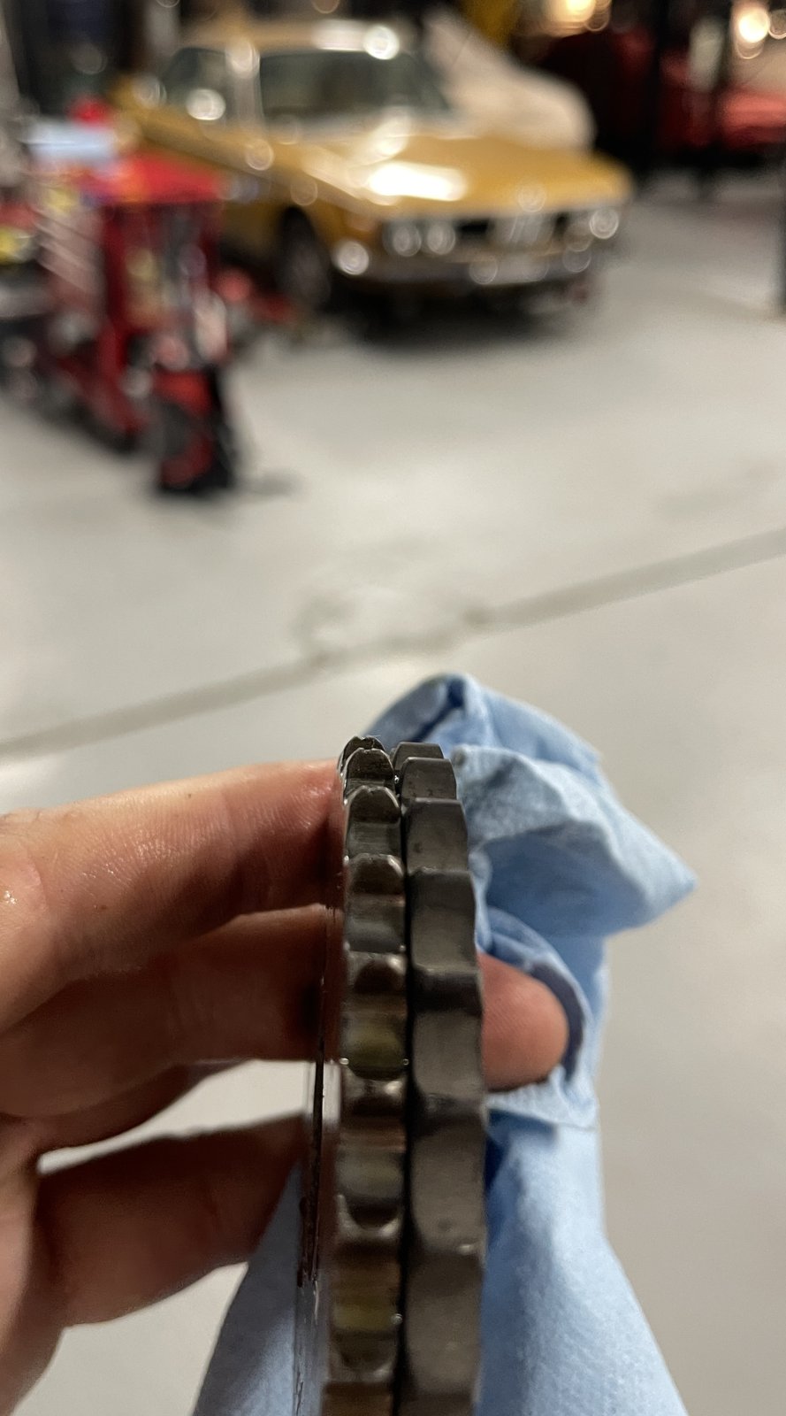

Old oil pump sprocket on the left vs just acquired nos one, and check out that worn tooth groove on top, quite a difference I’d say!
