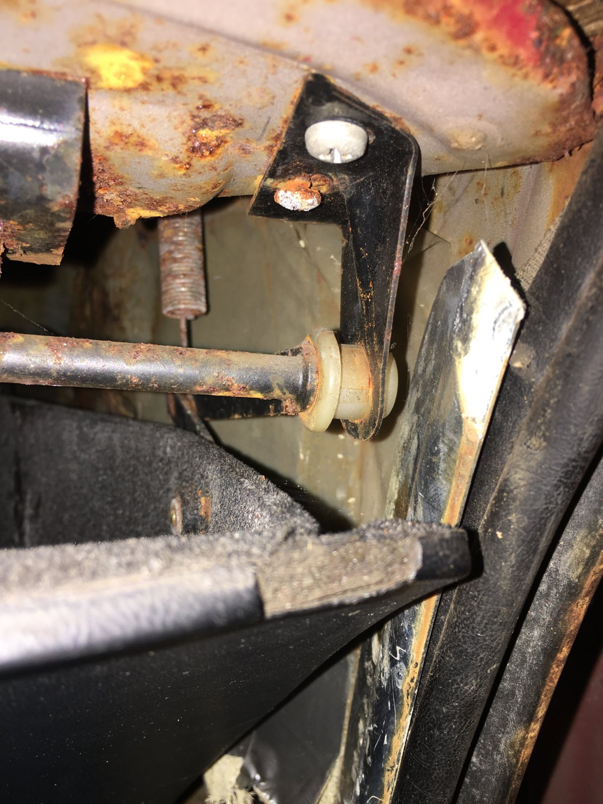

The spring clips to a tab welded on the body. The horizontal support rod inserts into the left to a tab, which is welded to the body. The right tab is screwed to the body. It is thin metal and would be easy to fabricate with a vise, hammer, dremmel, and drill. I don’t want to remove mine to measure because the screws will likely snap. I can measure it though.
Pardon my rust...

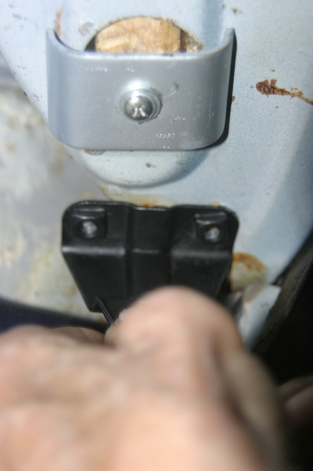

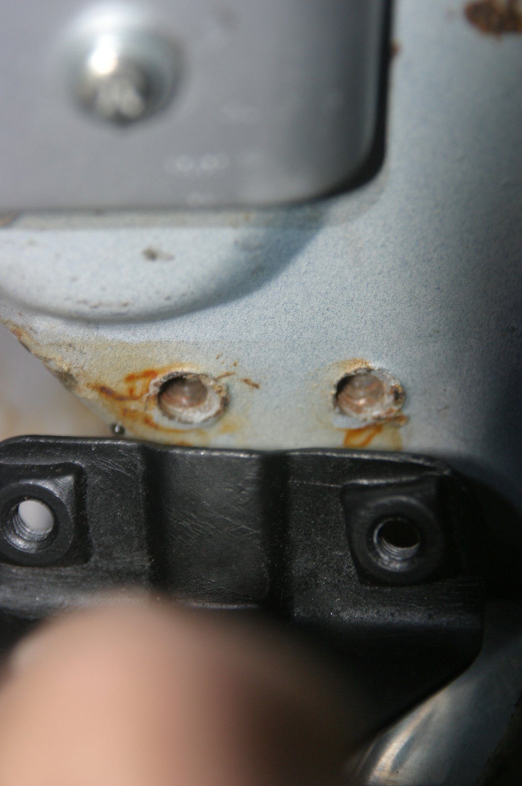

thanks for the help markos
i have those holes
but for some reason they dont line up
the holes in the bracket are wider and have nuts on the top side is
that right?
looks like i need those plastic grommets too
seems like there should be a plate to pick up the back screw
and the 74 must have been revised to prehold the screws?
i have those holes
that right?
That definitely isn’t the correct bracket. I’m not sure what that is from though. The only A-shapes bracket with captured nuts that I know of is the throttle stop. That doesn’t look like a throttle stop either.
