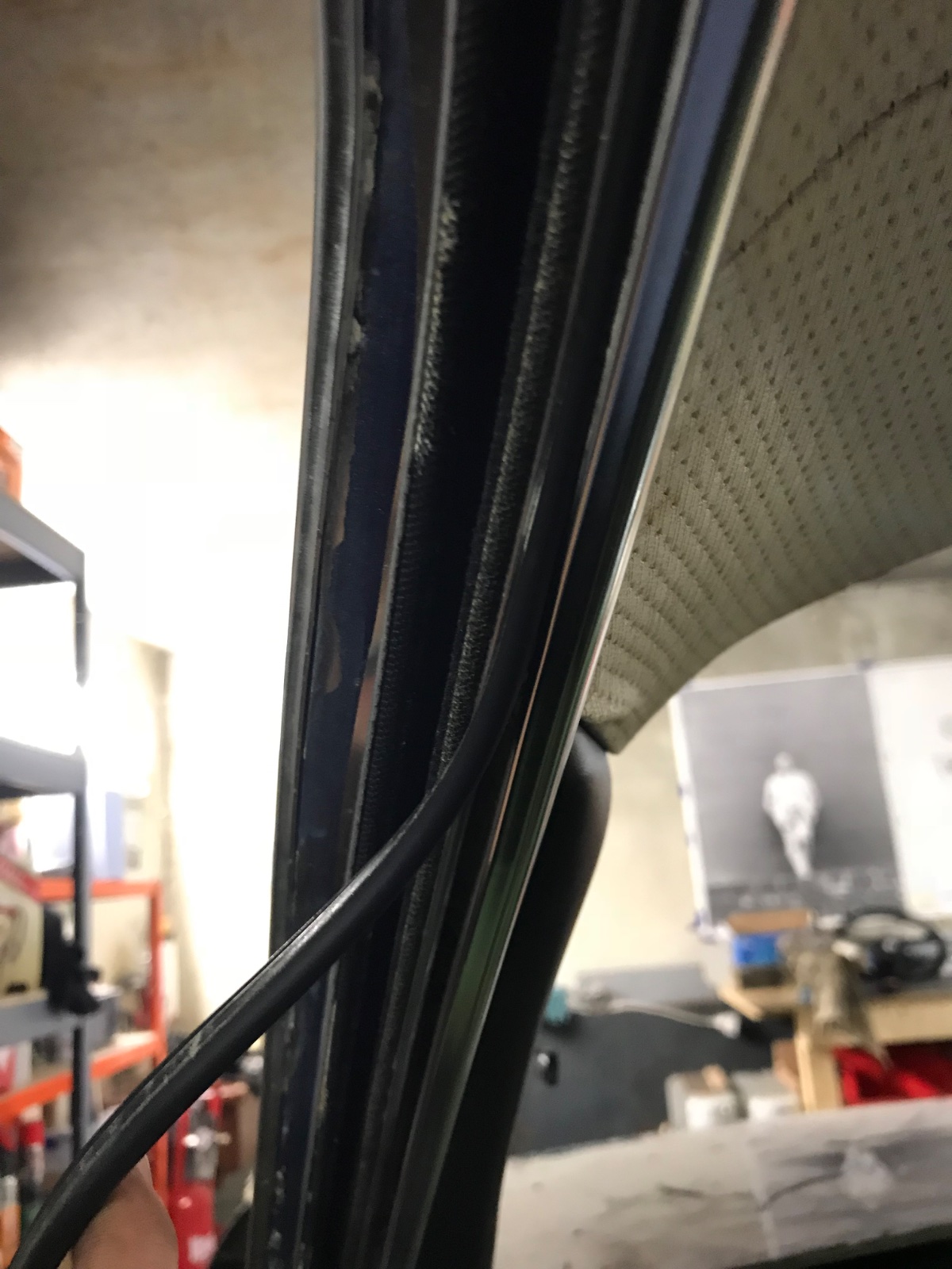

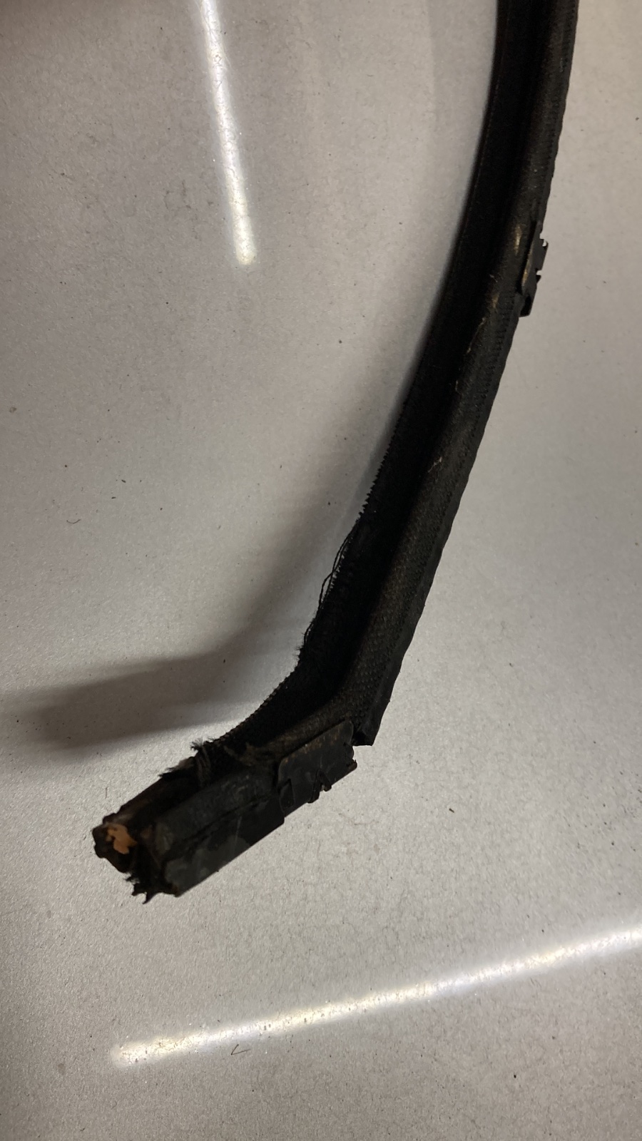

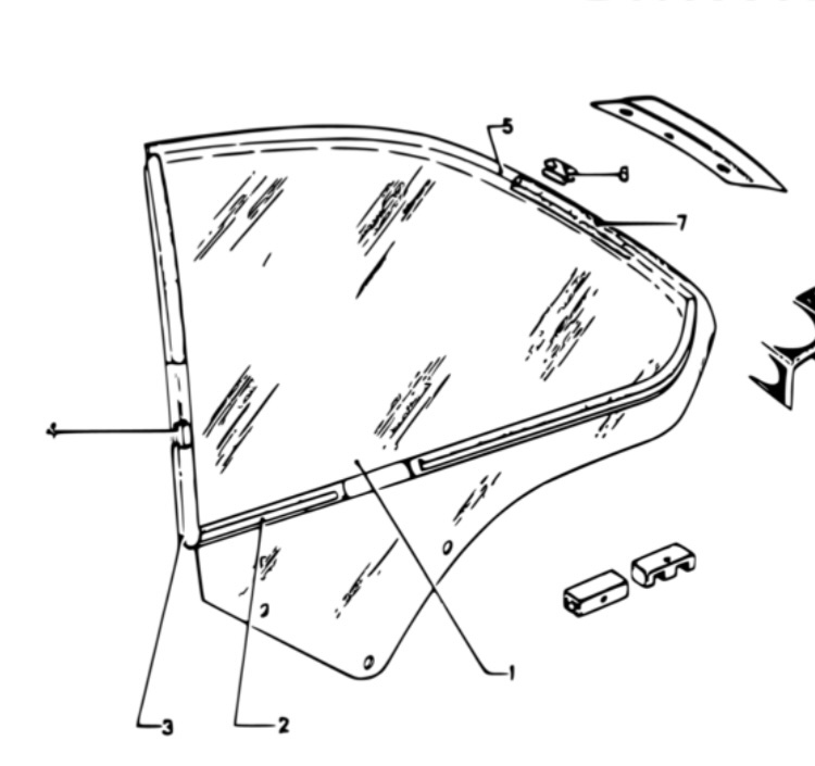

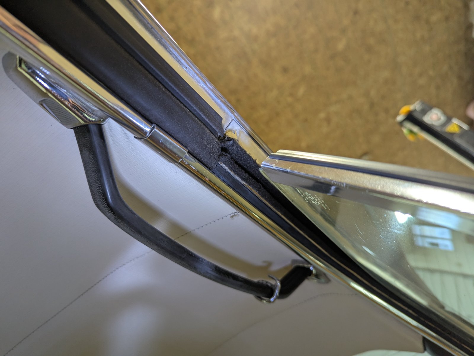

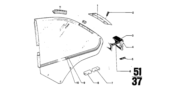

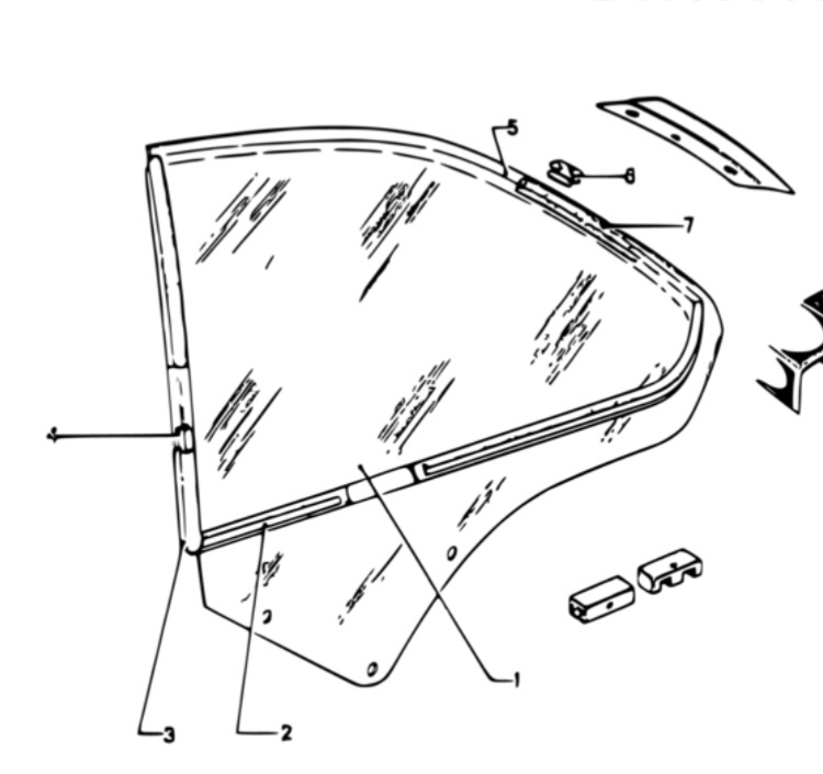

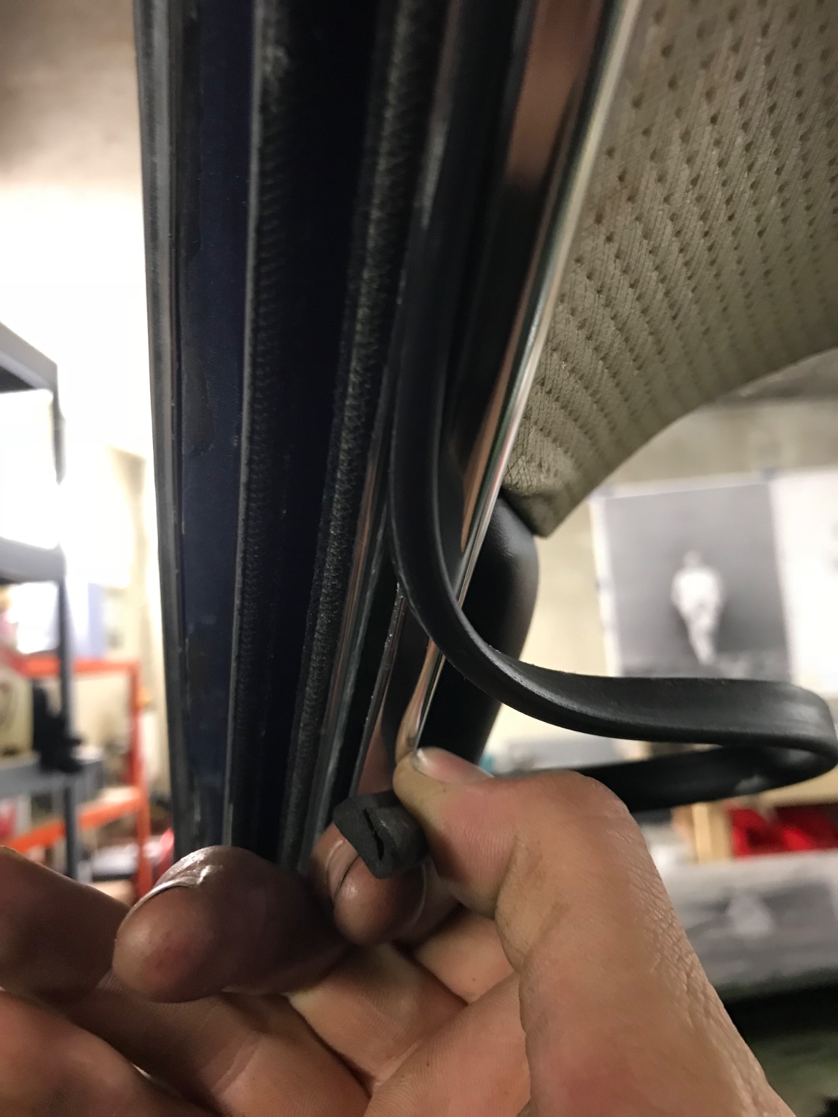

It is part number 11 in this diagram, and here is a photo of the gasket.
It has one thin side and a thicker one. There is a trimpiece which is against the top of the window with a join to the front piece just above the rear line of the door. On the left hand side this piece squeaks annoyingly sometimes. Is the thin piece meant to go behind that?
I have the gaskets but didn't fit them as it seems silly just to wedge them in not doing anything useful, so I didn't. Then the dreaded squeak surfaced.

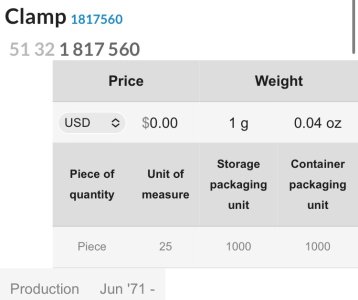

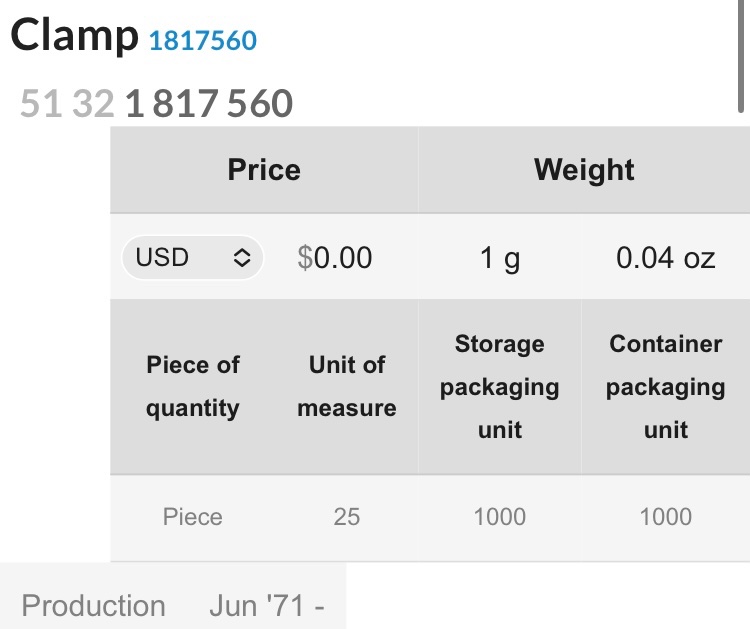

Shouldn’t it be held with steel clips number 6

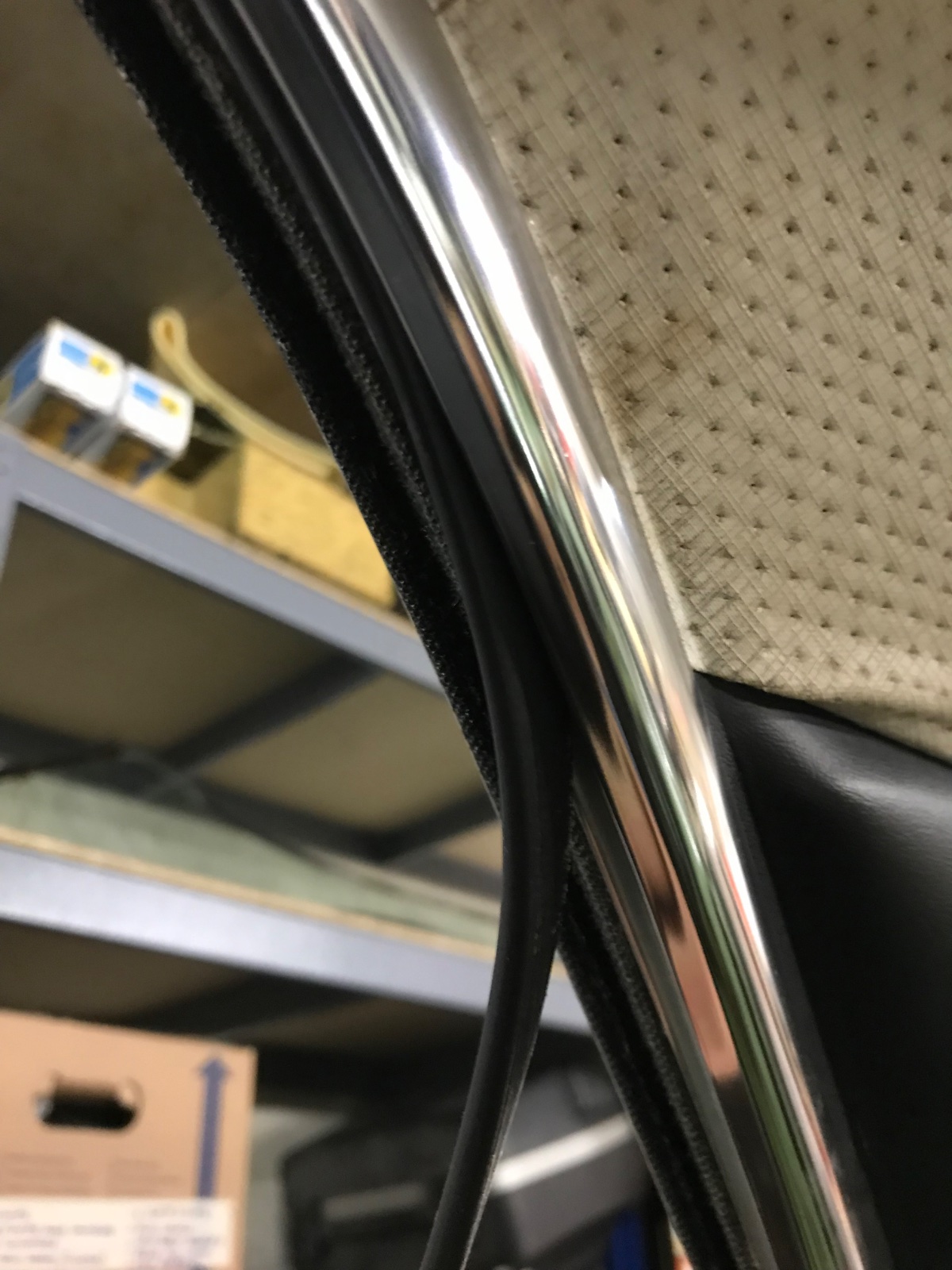

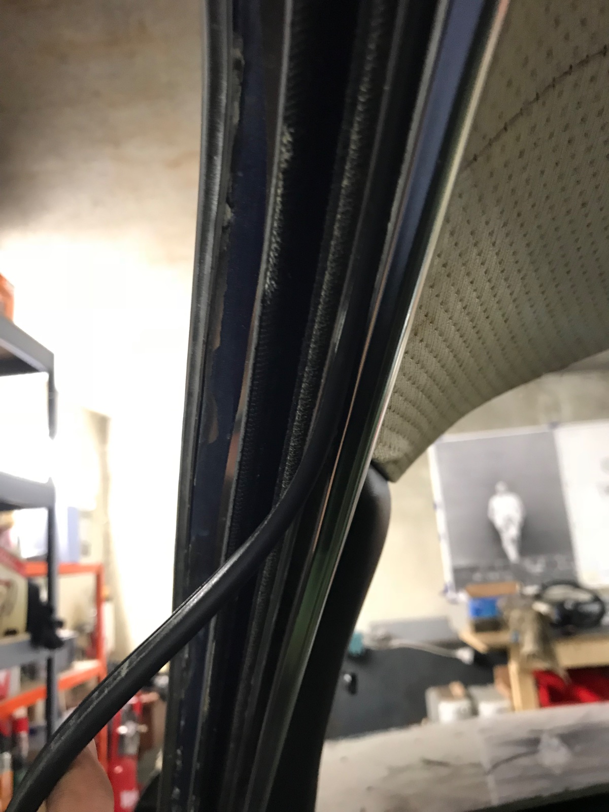

that i know the answer is NO. clips #6 hold in the U channel (#7). my memory s that this rubber trim finishes off the headliner. abutting the window channel

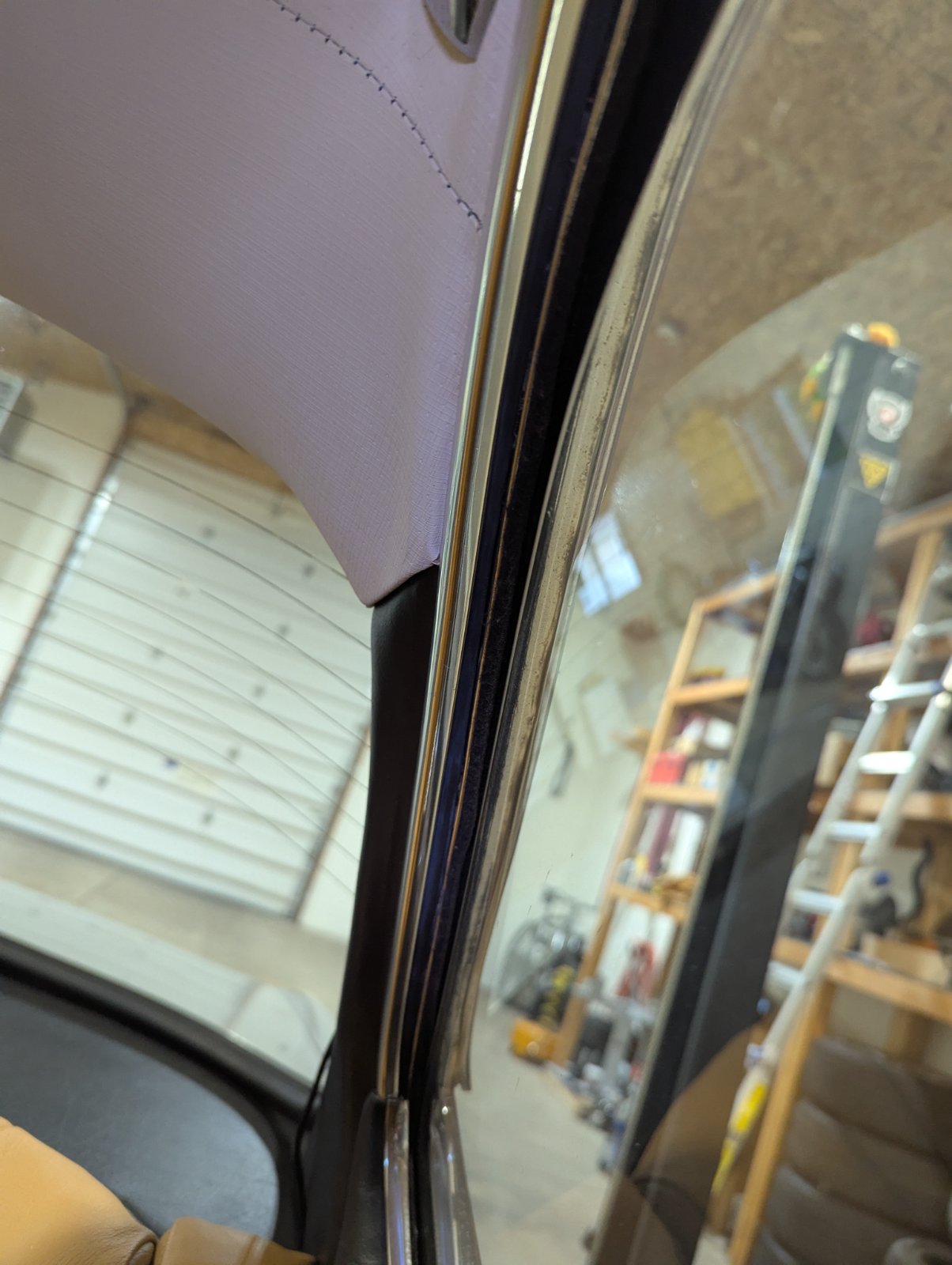

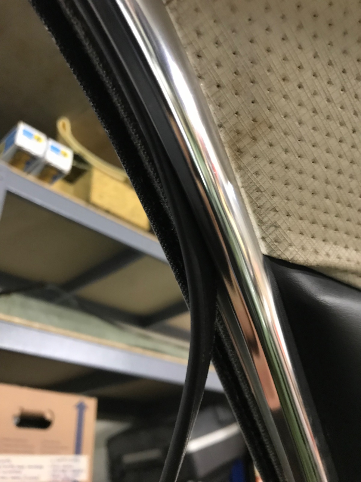

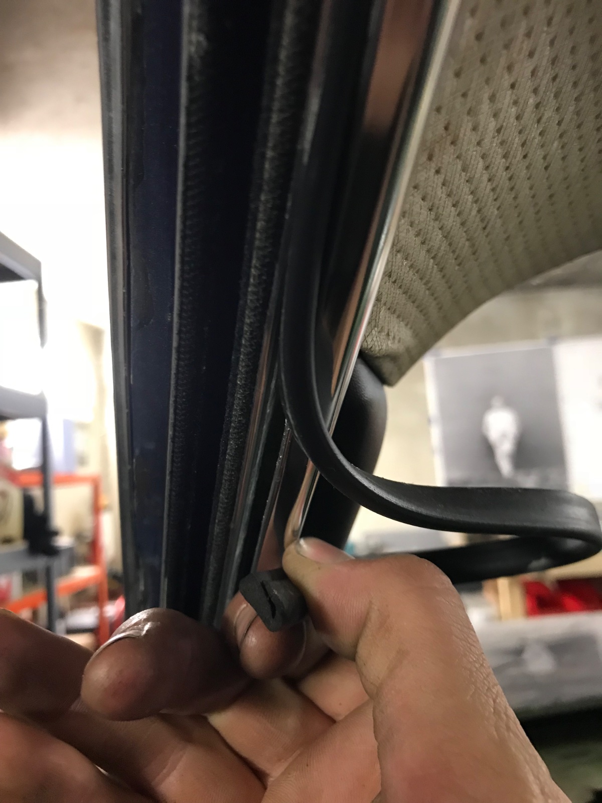

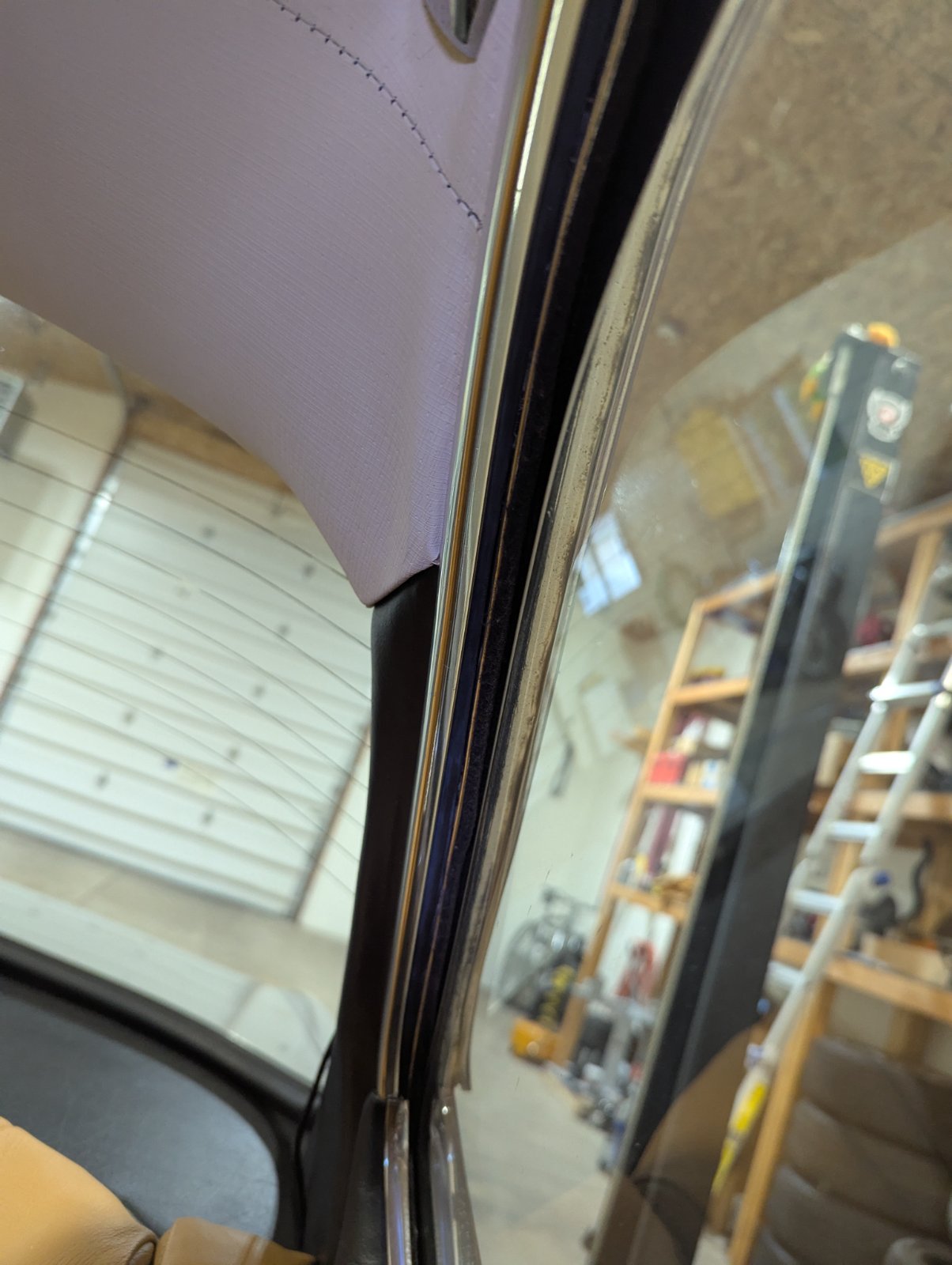

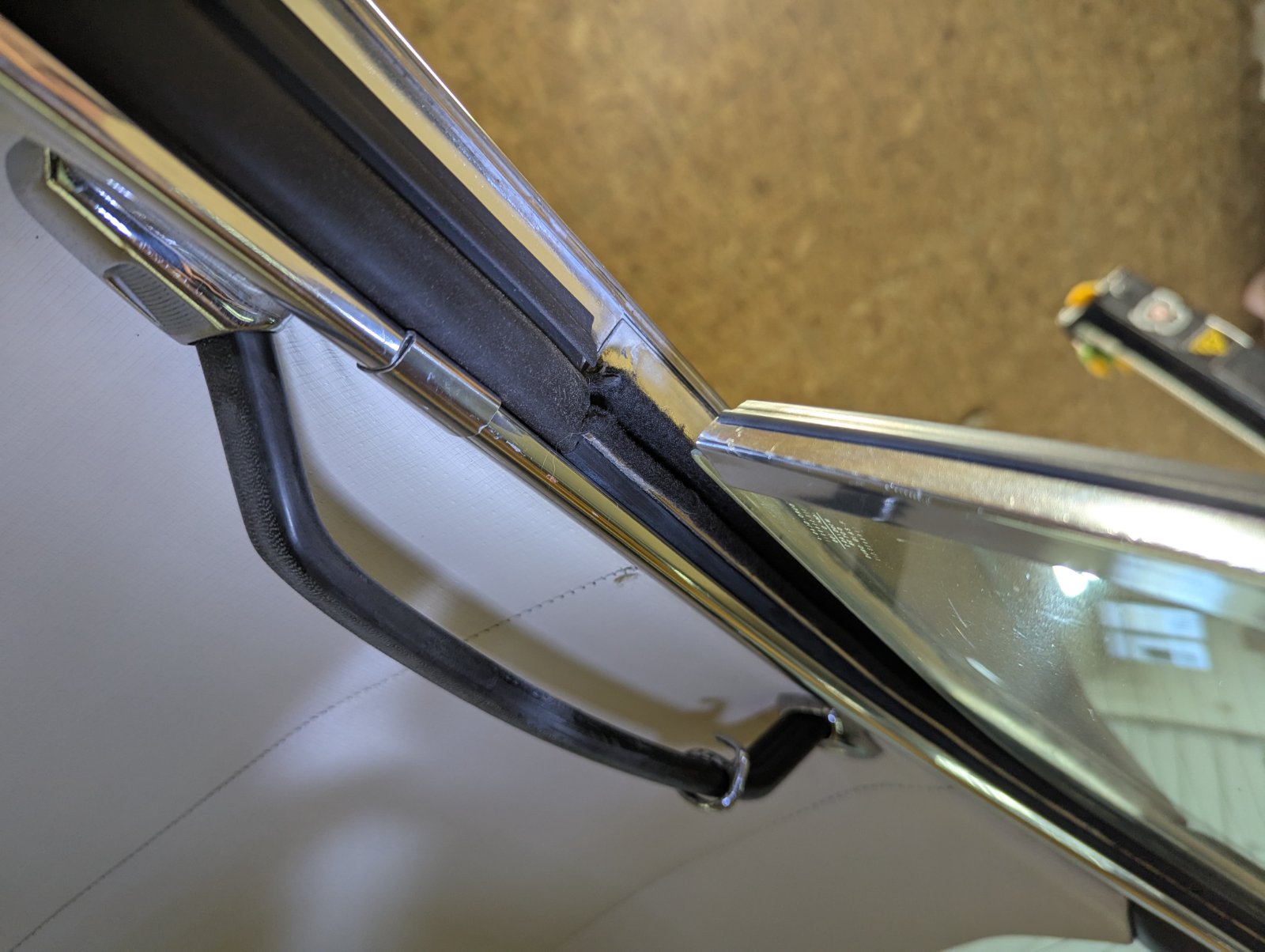

I'm not a concourse guy by any means, but I think I glued mine to the inside of the metal trim. PXL_20250515_232658462.jpgPXL_20250515_232616201.jpg
It squishes between the felt lined window channel trim and the alu headliner edge trim.
Small side of the “J” faces out.
Even though I had photos of mine when I disassembled I did a lot of research to confirm it’s correct.
I used a few dabs of Würth rubbber profile glue to hold it in place while assembling.

In my car it was also glued in. Seems to be the standard solution, but i don't actually know if it was OEM condition.

From what I can gather then, it looks like it is an aesthetic addition only serving little use.
I suspect it’s intended as an air noise/moisture barrier, since the alu window felt channel is hardly a perfect seal to the DLO trim above it.
