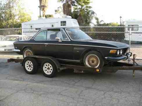

I appreciate the feed back guys, I would go up to around 10k here is one I will be checking out ImageUploadedByTapatalk1366333399.410317.jpg and also one on eBay that looks like a project..

The spirit may be willing but the flesh is weak. Especially in the case of that shock tower. Scary.
I would buy much closer to that $10K figure you floated. And of course be prepared to go a bit? higher.
"Remember what the doormouse said," TAKE YOUR TIME - BRING A COUPESTER.
A friend failed to do that and sunk over $10K into a RHD Bavaria that he sold for $3,000 to a guy in CA who flipped it for $6,000.
Yeah I spoke to the seller and he said around $2400 to repair the outer rocker on top of the $7500. I don't think this is the one for me. But I still do want to take a look at it in person. Hmm, decisions.
My concern is the rust in the general area indicating its been neglected and the lifting of the sound deadening which may indicated more problems underneath. And now we find that rockers need significant work.
