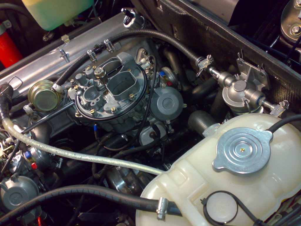

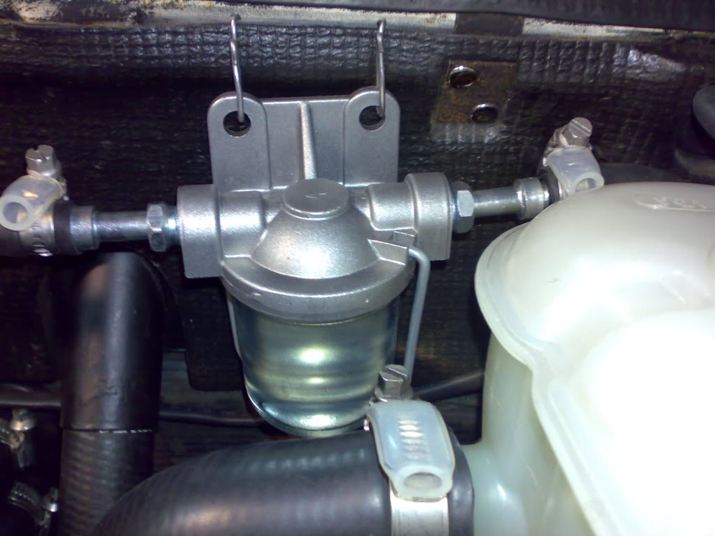

my setup
Here's mine, I matched the in/out diameter to the fuel hose, pretty simple Purolator or Fram, just make sure it's pointed in the right direction and it's before the fuel pump.

just a plastic transparent with paper filter element will be apropriate
mann, hengst, and others make this type of filters,
i do not have this type of filters in my setup, i can not show you a photo,
i use the old style glass bottle with a micromesh and decanter
you do not need to change this kind of filters, you open, clean and close, additional feature is that you see fuel cristal clear
my coupe is a 3.0cs
