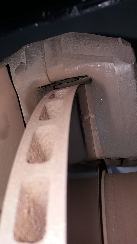

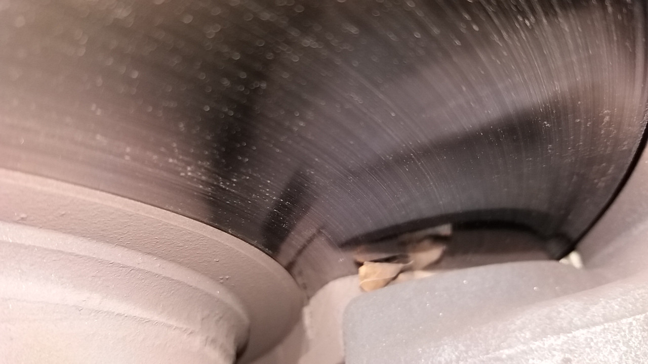

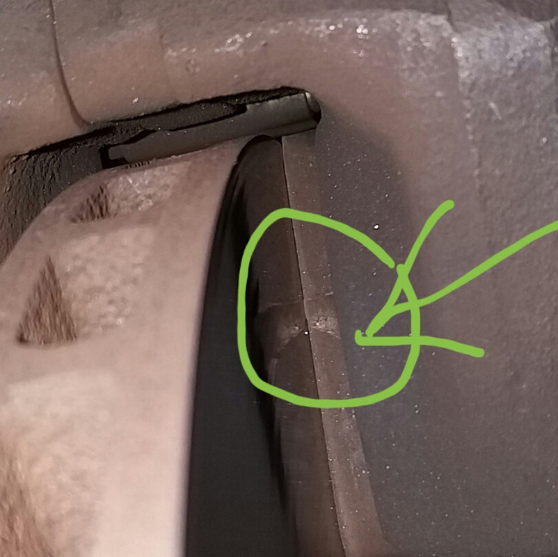

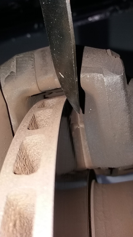

will put you in situation, a high tone noise sounds in your right front wheel, very loud, very high tone
so you go to your garage and you move the car on a flat ground
imagine you hear this...
what do you think ?
Scary for sure.
I know what it is by now but I'm absolutely sure nobody will ever be able to guess this.
Indeed amazing that such a small piece of dried up leaf can make such a noise. Would have scared the hell out of me if I heard that on my car. Thanks to DQ I'll be less afraid now.
