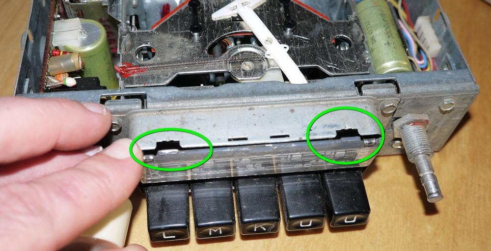

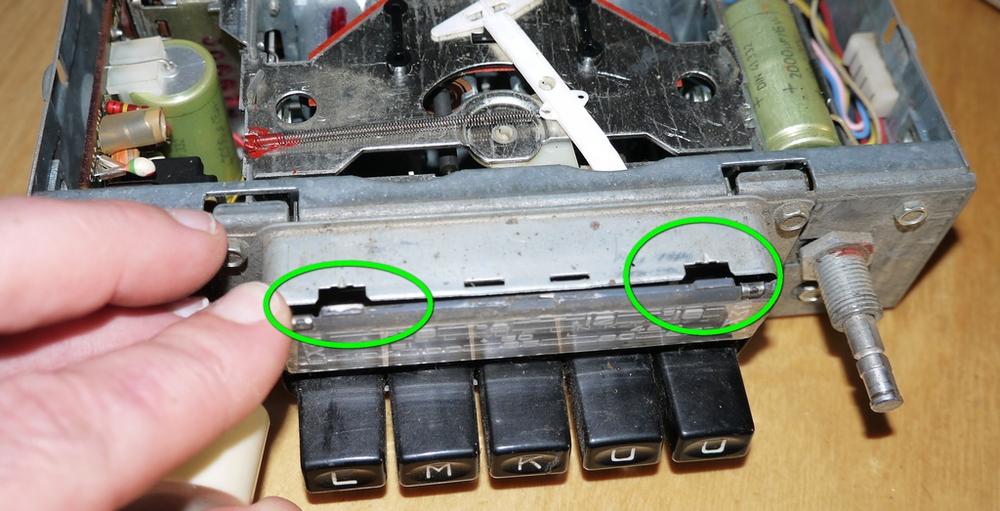

First remove the chrome faceplate.

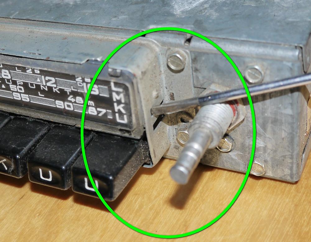

Remove the plastic dial with a small screwdriver

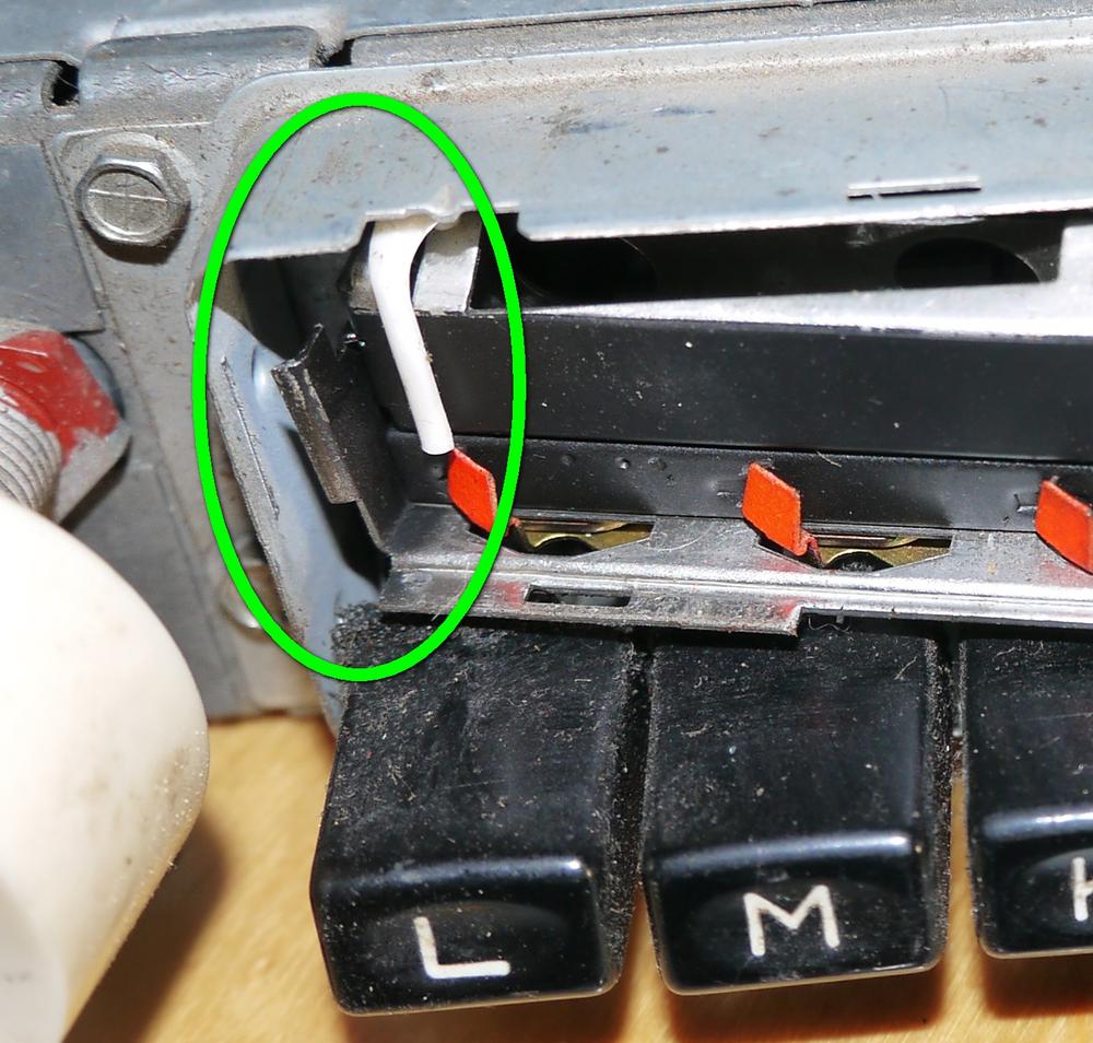

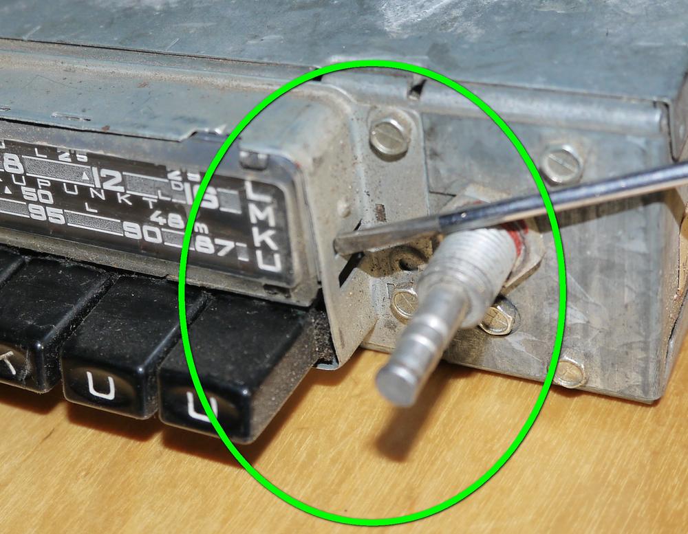

Turn the white needle fully to the left

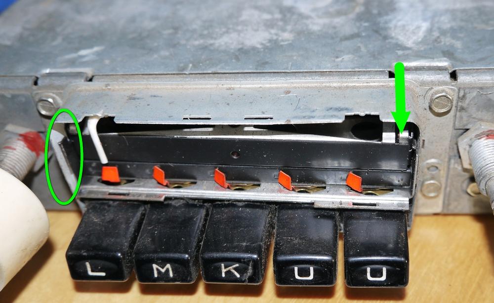

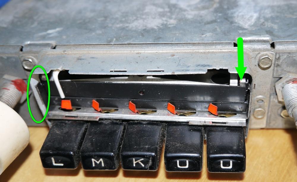

Point to lever with a small screwdriver
Move it to the right so that you can move it around the back of the needle

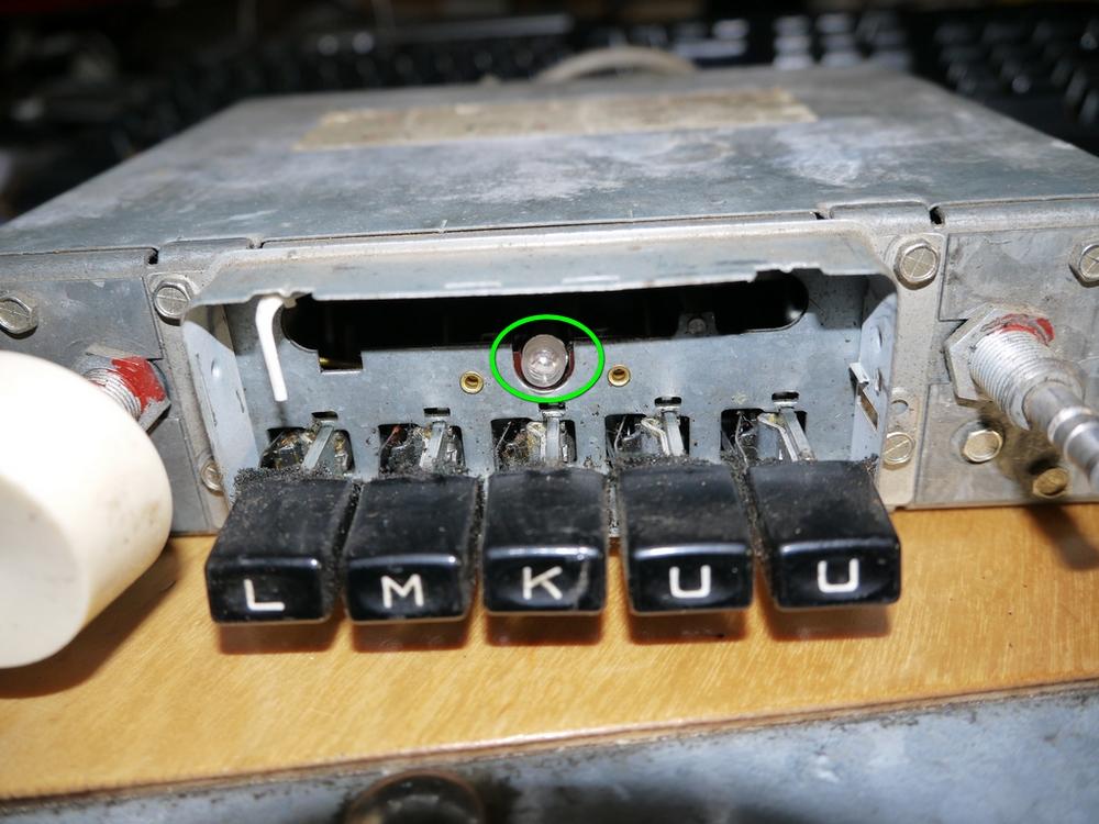

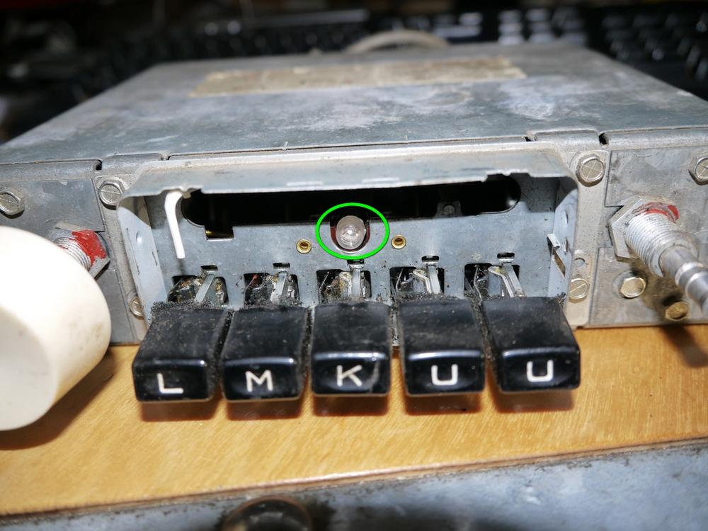

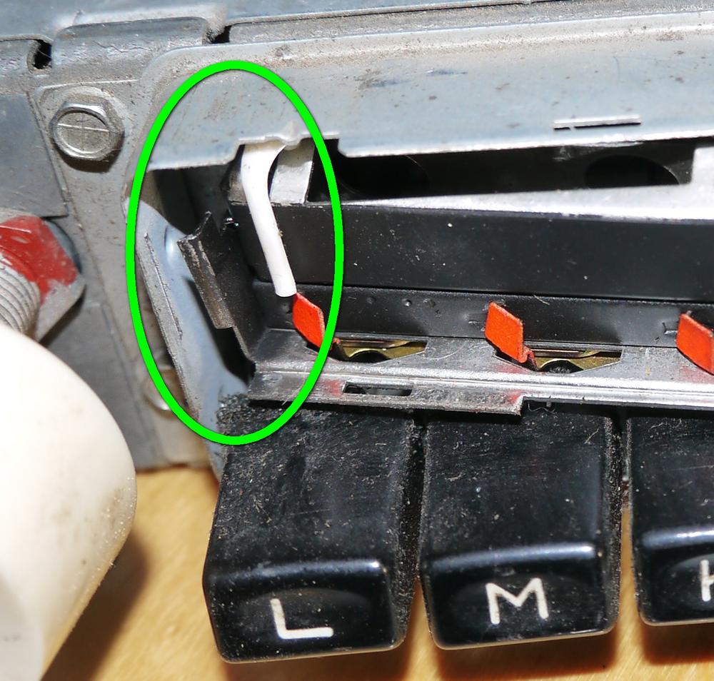

And here is the bulb
The bulb is spring loaded. to remove it just push in and turn a little to the left, for install a new one, push in and turn to the right.
