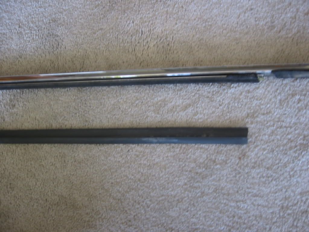

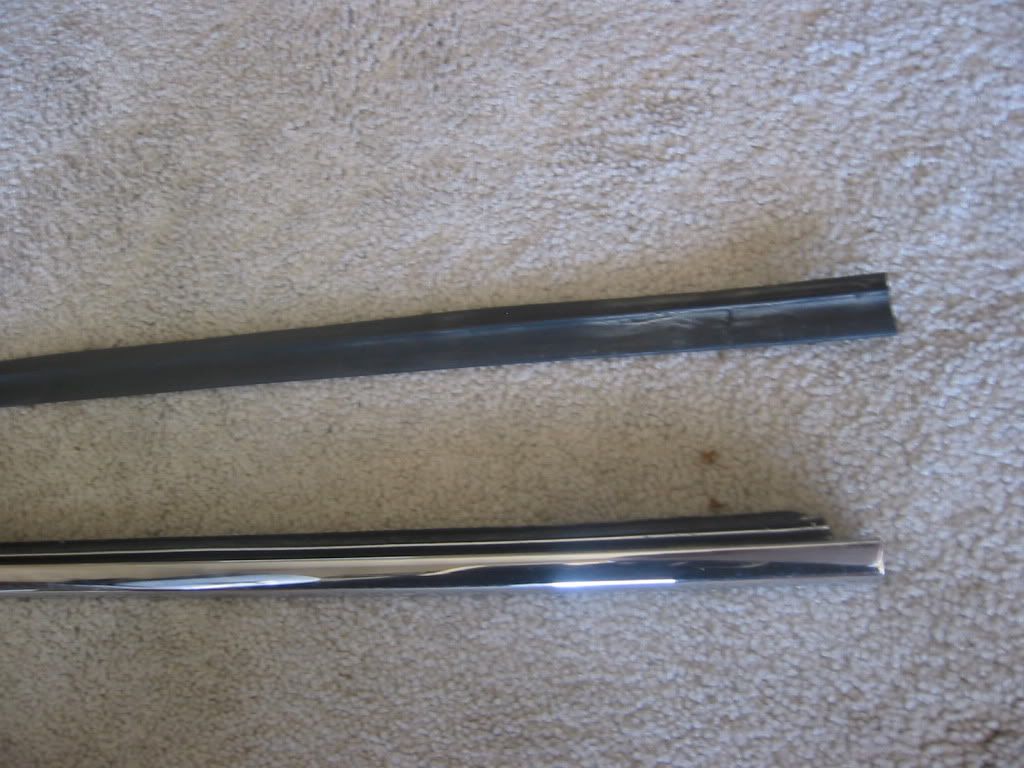

I am struggling with getting the window "wipe" strip into the groove on my chrome piece that mounts on the top/outside of the door (see photo).
It took some effort to get the old strip out, so I shouldn't be surprised that the new one doesn't drop right in. I used a screw driver to gently spring the groove open as I pulled out the old strip out a 1/4" at a time. But, trying that technique to get the new one in doesn't seem to be working. I also tried lubricating the rubber with silicone, and sliding it the length of the metal channel - I can get it 2-3" in, but then it hangs up.
So, how have you solved this problem?
It's been a while but I believe that I actually opened up the slot a bit with a gasket scraper and the gently bent it back a bit. The track is soft metal and it gives easily. Also, sometimes very soapy water will work even better than silicon.
I believe that I actually opened up the slot a bit with a gasket scraper and the gently bent it back a bit. The track is soft metal and it gives easily. Also, sometimes very soapy water will work even better than silicone
OK, I'll try that. Did you use the "poke it down a bit at a time" technique, or the "start it in the groove at the back, and pull it through the length of the channel" technique?
I like the idea of soapy water.
I found that the "poke it down a bit at a time" technique worked for me. I used a little soapy water in the groove, but try to keep it off the rubber piece because it gets slippery. This technique took time and patience and sore fingers, but well worth the outcome. Start from the top of the rubber (pointed side) and work down. I have found that BMW graciously gives you an inch or so of extras rubber on their replacement parts, so if you need to trim the rubber, it will be on the end inside the door.
Soapy water really works!
Remember in the movie "The Graduate", where the older guy comes up to the Dustin Hoffman character and says "I have just two words for you Ben - two words: soapy water". For years, I wondered what the *&^I)%$ the guy meant by that. But, today I figured it out - Ben was trying to install the rubber window scraper into the chrome finish piece on the top of an e9 door. And, the old guy had the secret (as old guys tend to do).
Yea, soapy water made ALL the difference. It worked WAY better than silicone. I even was able to install one scraper by simply starting it in the groove at the back of the metal piece, and pulling it through with a pair of pliers. The second one jammed when it got about halfway down using that technique, so I did it with the "poke it in with a screwdriver" method. The soapy water really helped it to go into the groove in that direction too.
Another big thanks to the collective wisdom of the e9 board!
