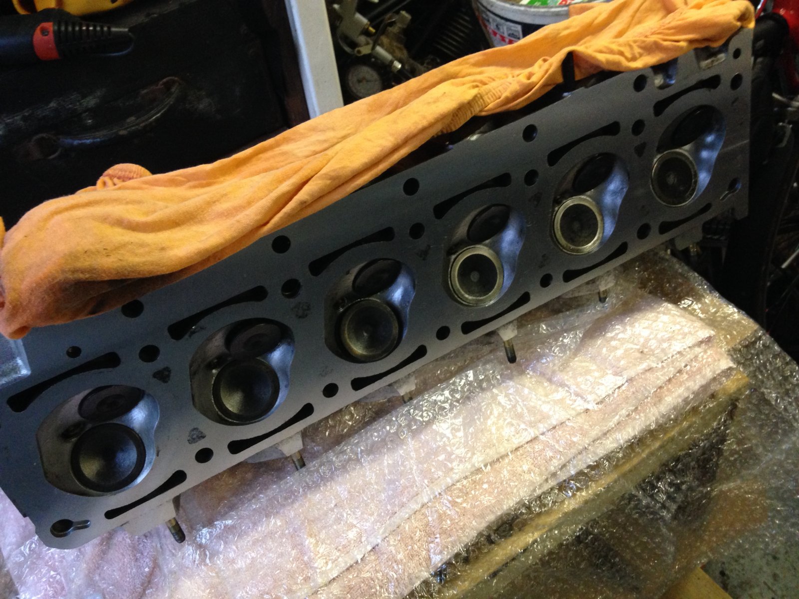

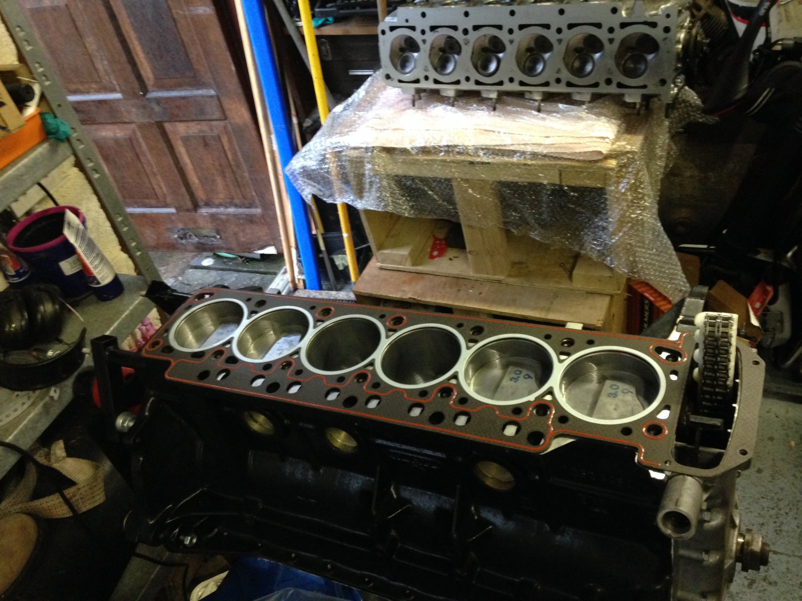

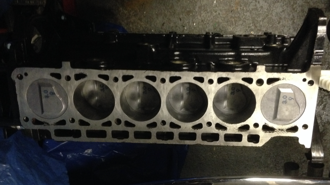

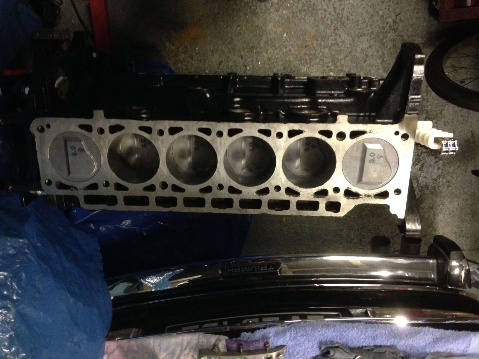

Hi guys
I am looking for a bit of help please.

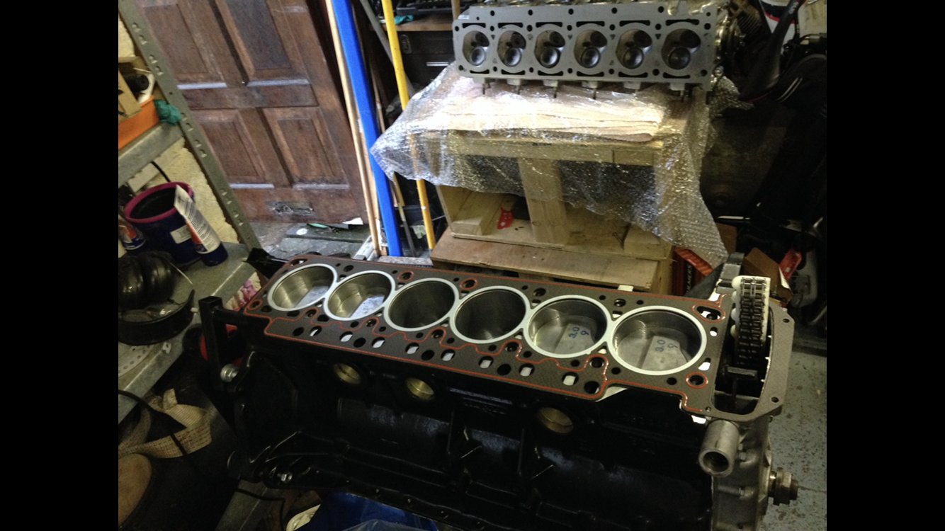

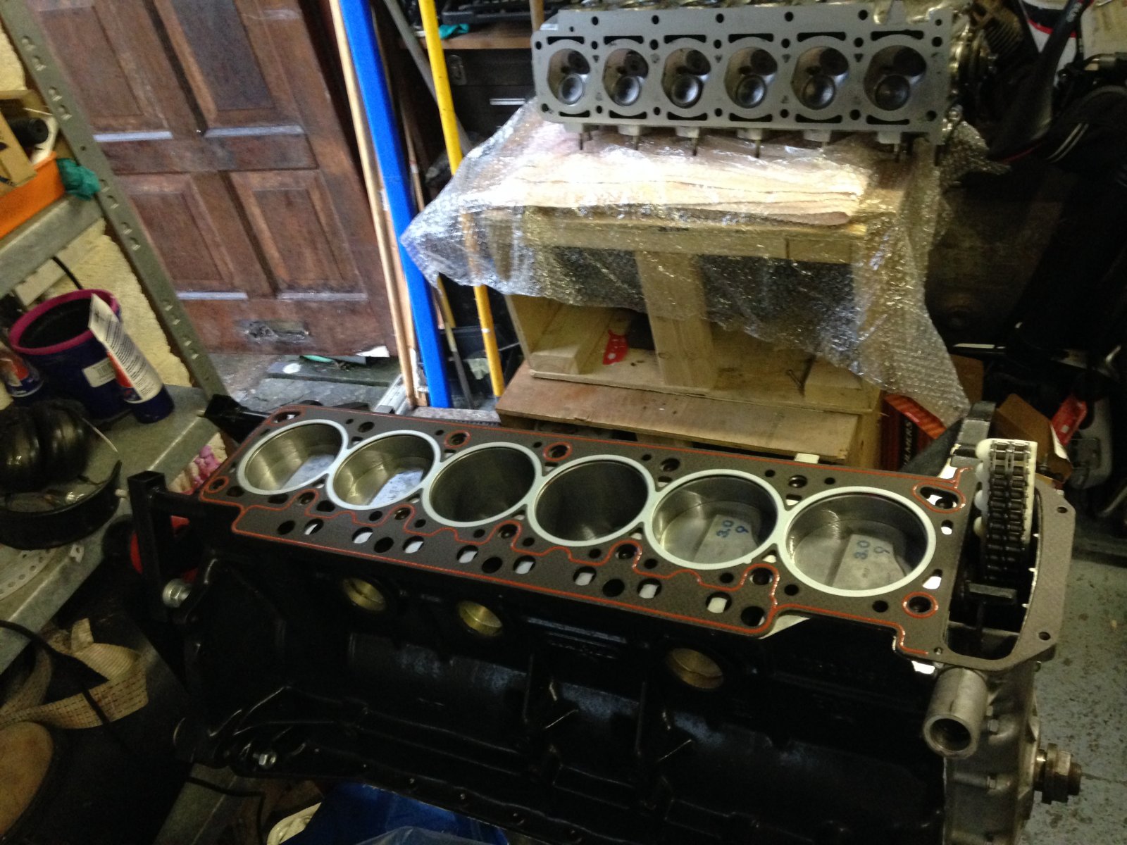

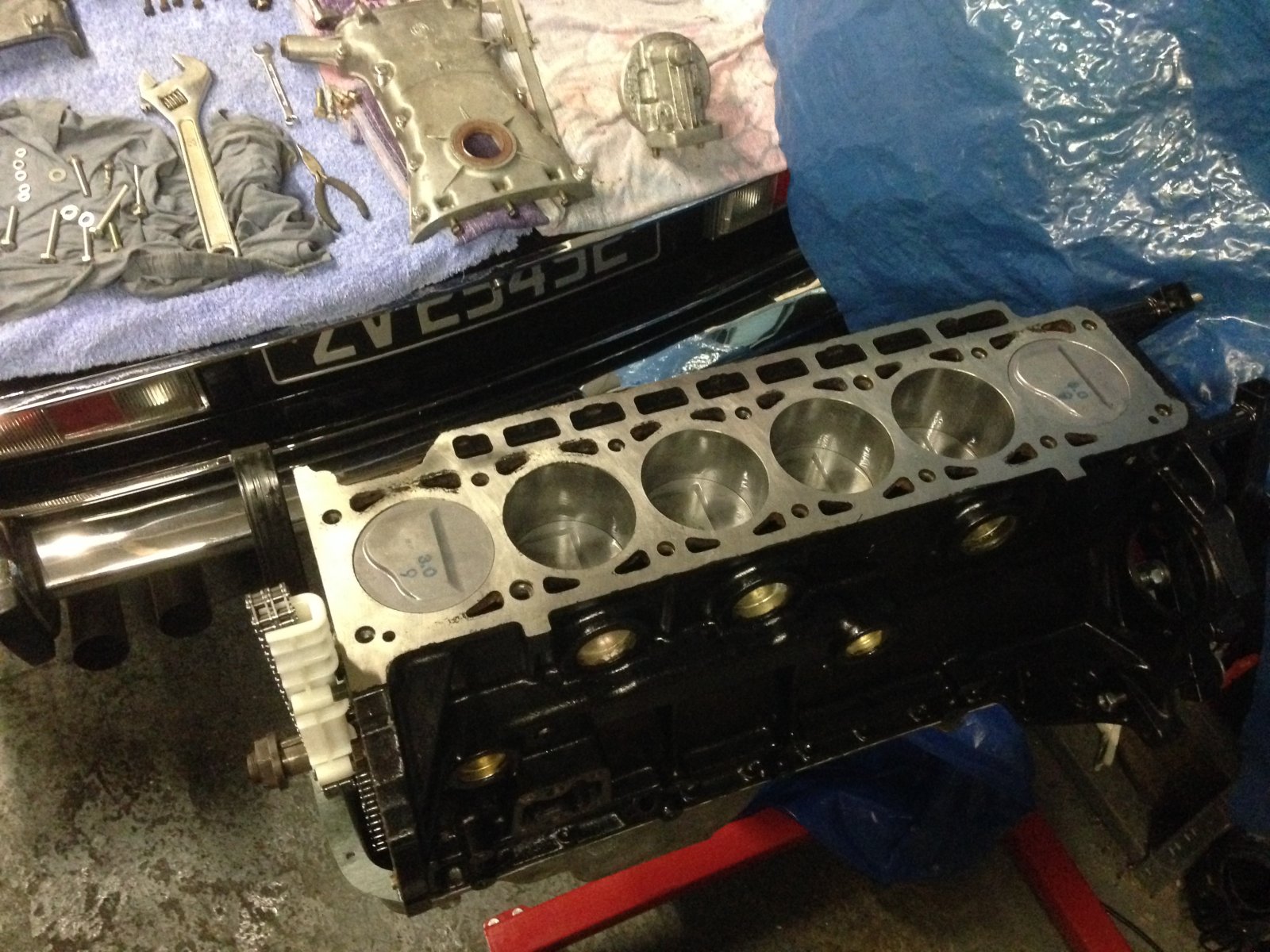

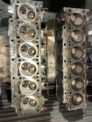

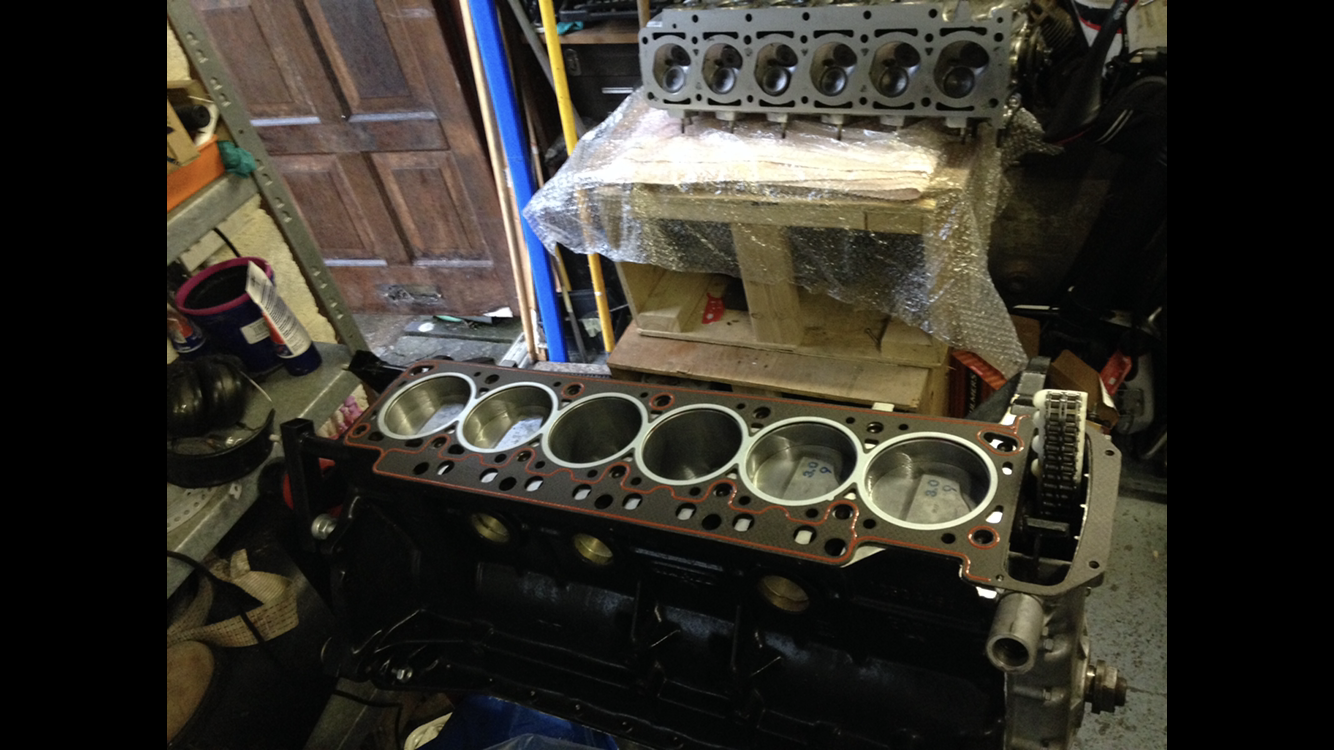

I have done a compression test on all 6 cylinders of my engine and I am getting 182psi in each cylinder.
I am loosing coolant in a BIG way.
I rebuilt the engine 8 years ago and I am only now getting it back in the car.
I got it started for the first time ever since I have owned the car ,
I only ran it for about 5 or 6 seconds when I turned it off and noticed coolant dripping from the camshaft oil drip feed pipe.
I was gutted .
I might have fitted the wrong head gasket perhaps or maybe the head or the block are cracked.
I really hope it is the gasket !!!!
What pressure should I pressure test the coolant system to ?
I am not actually sure if I can build any pressure in the coolant with a test rig as I think I might be just filling the block and radiatior up to the level of the head gasket then I am probably just filling the sump with coolant after that :oops:
But it would be good to know the number anyway.
From memory my engine shop did pressure test the cylinder head , but they did not pressure test the engine block.
Thanks again guys

I had the same issue with my m90 rebuild. In my case solved by using a factory head gasket, the lands were too thick or maybe wrong metal as they were about 5 thou proud of the gasket material when disassembled, allowing water migration to oil galleries. This was before final torque step, didn't want to run it up to temp with the water leak. If you don't want to spend factory money, assuming this is the cause, Elring supply the factory. Best of luck Barry, I feel your pain

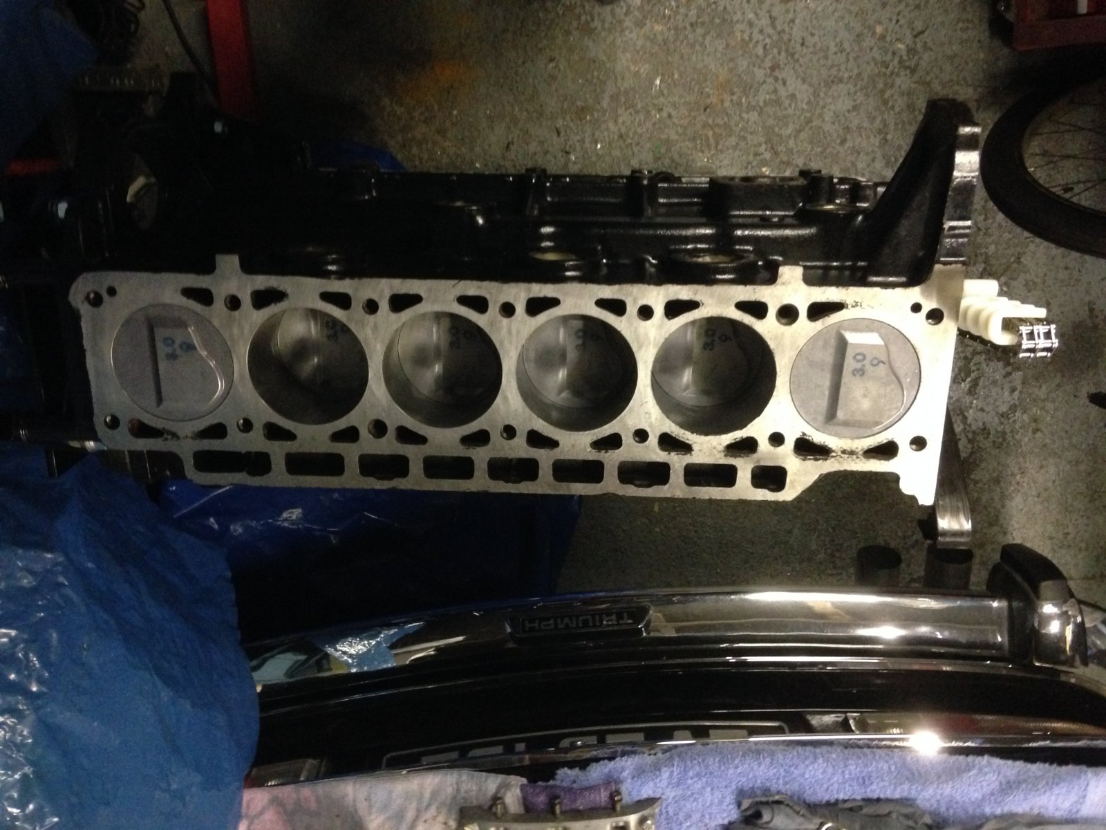

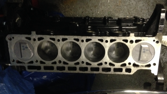

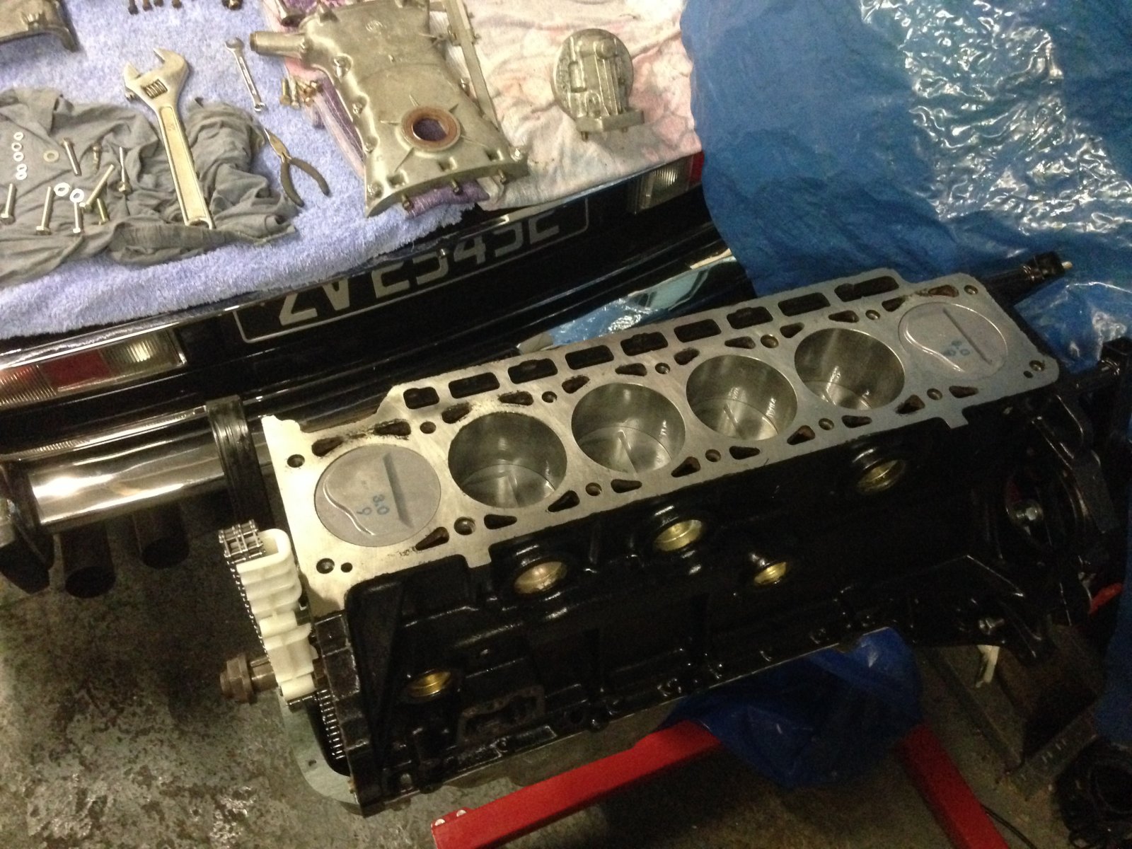

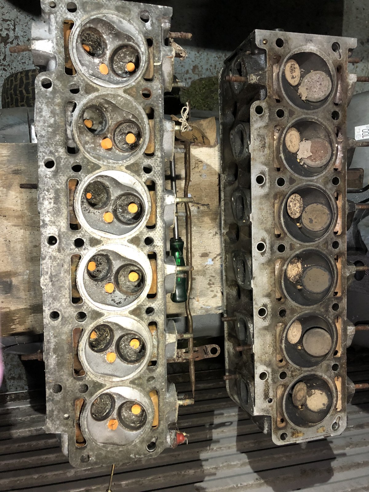

Okay so
I connected my compressor up to my cooling system this evening and I pressurised it to 1 bar.
It didn’t hold the pressure
The pressure did not go into the cylinders as I tested that too by blocking each spark plug hole by hand and no increase in pressure was felt.
I cannot see the leak I can only hear it !
Does anyone know which ports supply the oil under pump pressure to the head
I might have to check each set of chambers in the head
I have already checked the combustion chamber they are all fine .
Then the oil chambers/ runners should be tested
Then the coolant chambers should also be checked
