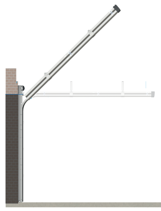

I'm wondering whether it is possible to change the rails to come up with some angle (not perpendicular as it is now), to be able to open it up once car is up on the lift.
Not sure if you know what I mean by that. The roof is not flat so the gate's panels should go along with the shape of the roof.

@Krzysztof , here are a couple of articles, it looks like it has been done.
A buddy of mine had the same issue you have. He acquired a larger curved section that made the 90 degree turn on a longer arc. This longer arc puts the door up about 18" higher.
Thank you so much for the articles. It would be difficult for me to find them and you've just hit the point with the practical realizations of the idea I was thinking of. I need to read all carefully and check how to implement that.

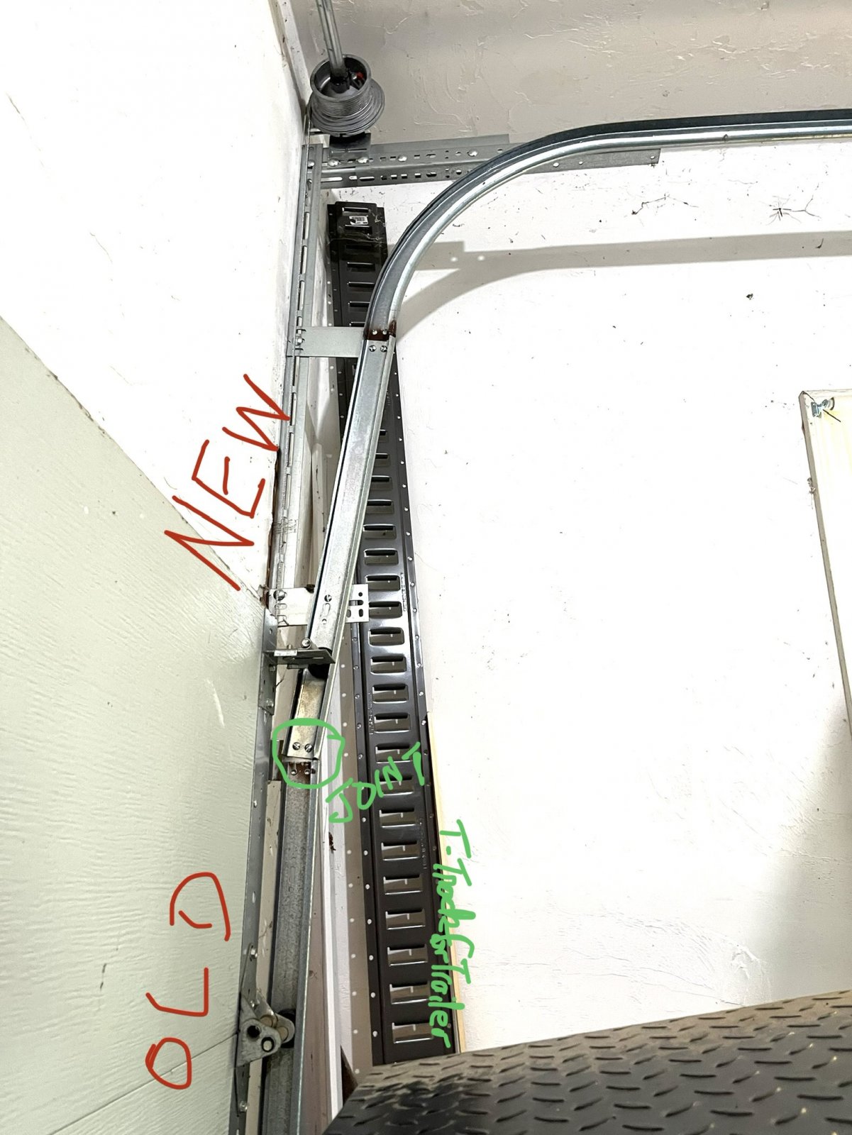

No need for anything fancy. No changes to my existing door. All we did was add a vertical extension to the existing tracks (note wall bracket in pic), which raises the horizontal track to within a few inches of the ceiling. The extension pieces were mounted to give an angle to the setup to clear the roller spring. The track stops are set to keep the bottom of the raised door bottom just below the door opening. For me, this provided significant extra headroom, in my case just enough to store my tallest car (E9) still have 78” underneath for walk around space. This did necessitate removing the power opener. But the adjusted spring makes it quite easy to open/close manually.
The track itself is quite cheap as are the butt joint plates I did have to adjust the roller spring to provide greater lifting tension.
Make sure you know what you are doing if attempting to adjust the roller spring. It can hurt you if you screw up.
Total cost of parts was just a few hundred because I did not have a torsion spring (had linear type). Wig you already have a torsion/roller spring, you can reuse it and the parts cost should be under $100.

Look at my photo.
The bottom of the 90 deg segment was cut to match the angle of the slanted extension piece. Simple track splice plates are used to join the segments (need to drill 2 holes). Everything is also well attached to the wall/ceiling. This modification is consistent with how the original is put together. Note the black rustoleum paint on the cut end of the curved track to prevent corrosion.
And yes, the slanted extension piece could have also been cut (see gap in my driest post), but this section is vertical so the gap is inconsequential.
