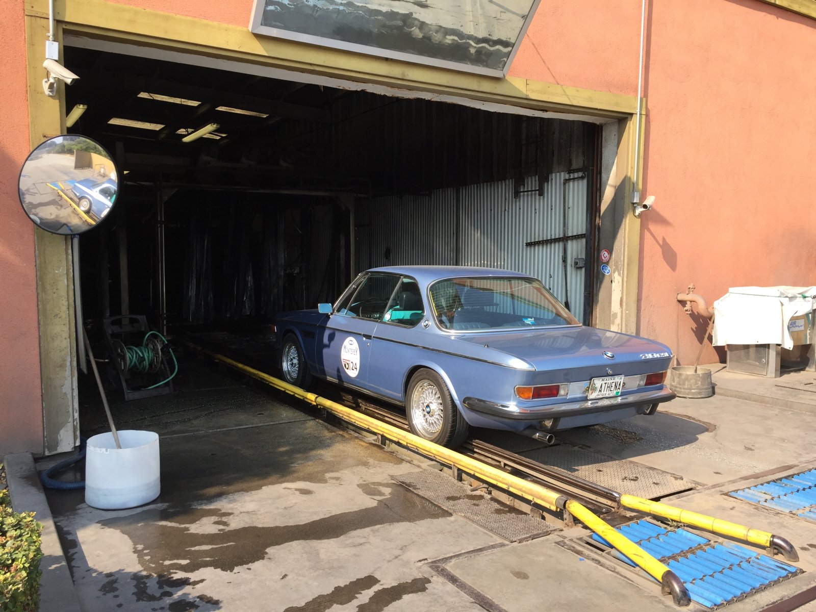

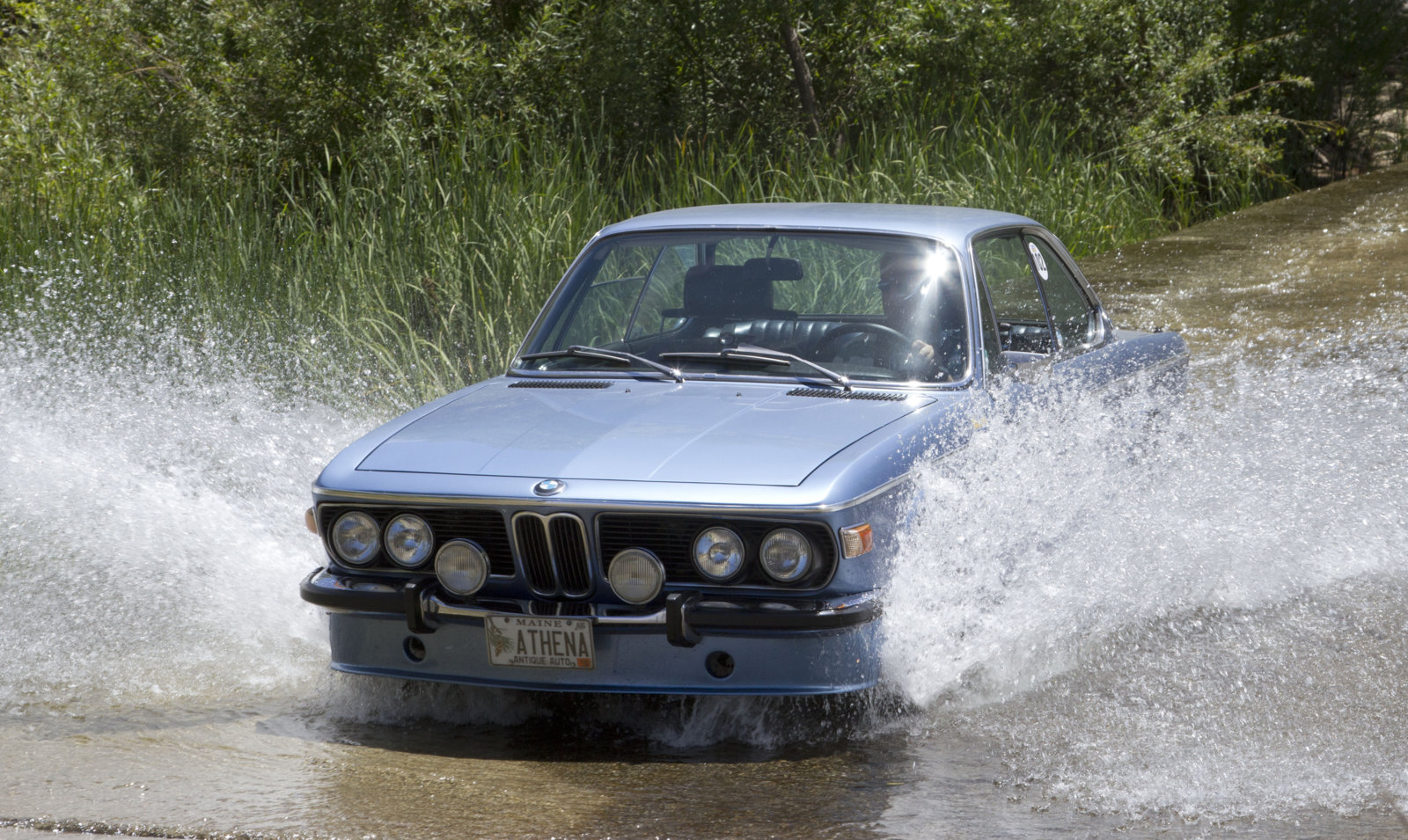

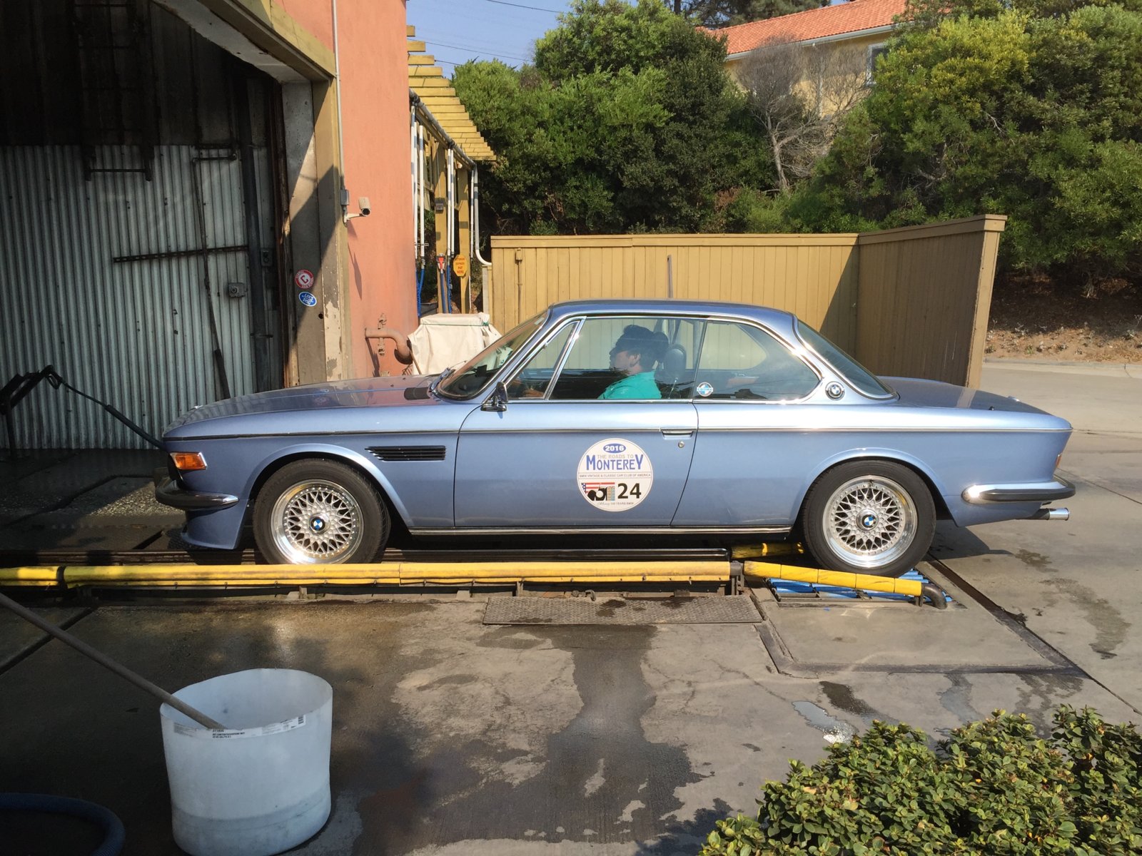

Didn't leak one bit in the Del Ray Oaks Car Wash in California 2016 or on the 2019 Targa CA or in 2020 after the filth inducing dusty dirt road laden New Hampshire Covered Bridge Tour. Sometimes one's confectioner's sugar Coup does need a real bath when waterless cleaners are inadequate.
