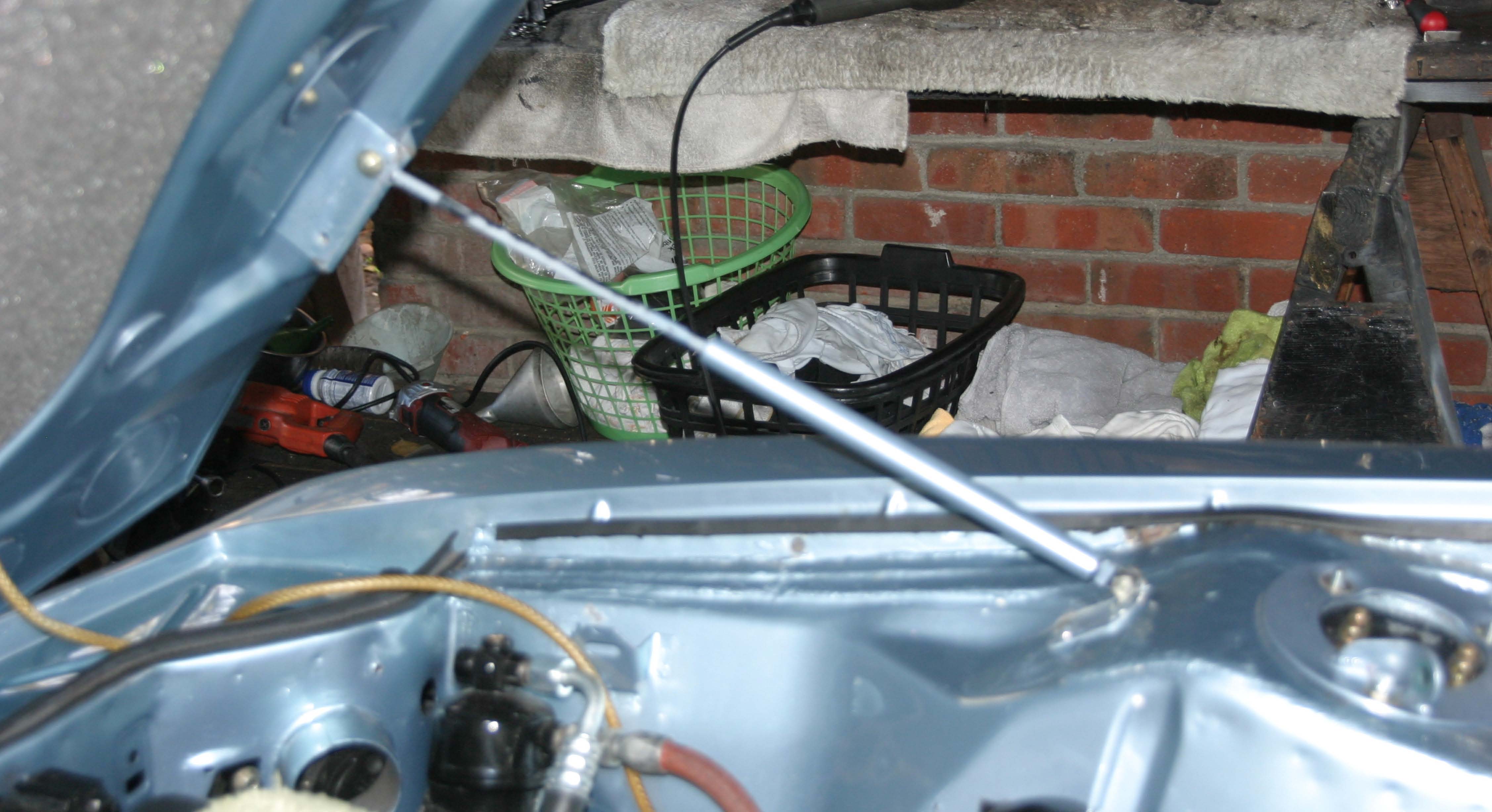

Bavarian workshops 2002 "m2" has a nice custom setup the gas struts are out of the way
That looks really sweet! But I have a hard time imagining that the heavier coupe hood would work with such a system. I'd love see someone try it though!
Any idea where to find these type of gas shocks?
AMAZON HAS HUNDREDS OF THEM
YOU WANT ONE THAT IS ABOUT 20" LONG WITH A PRESSURE OF ABOUT 15 POUNDS
I JUST PUT IT ON THE RIGHT ITS REALLY NOT INTHE WAY
the question becomes - would these interfere on a coupe with AC? it seems like they will interfere with the condensor + fan
