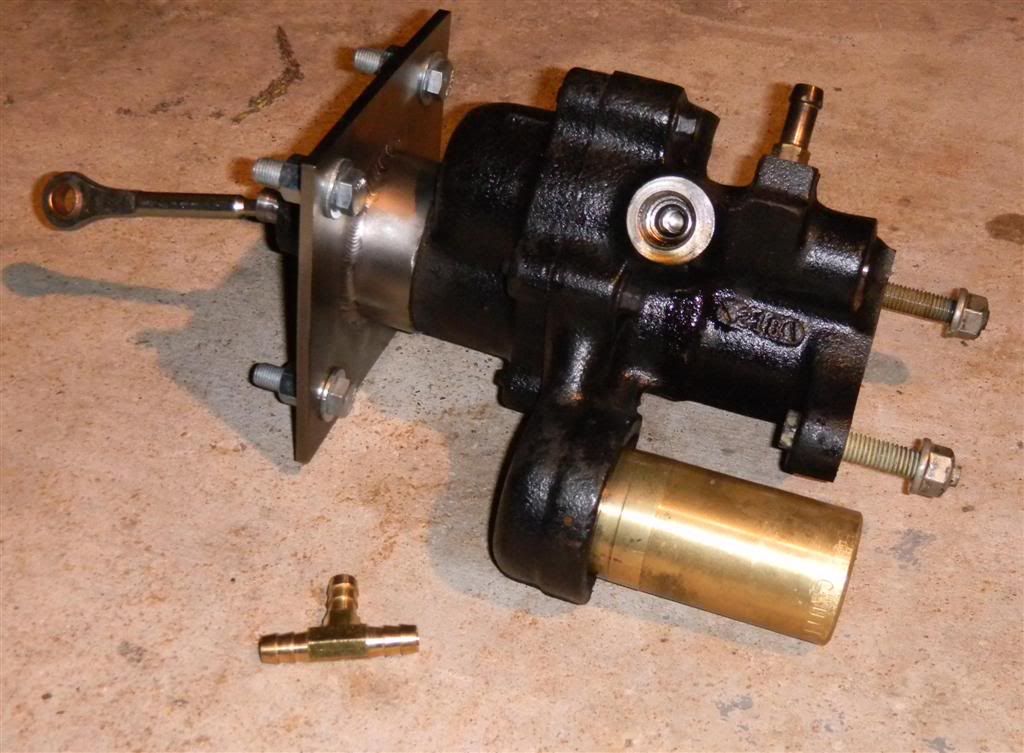

Has anyone considered using a hydroboost system instead of the vacuum booster for the braking on a coupe.
I see these systems in many hot rods and they seem so simple and don't take as much space.
It uses the power steering pump to supply pressure to the booster for brake assistance.
There are many on the market in the $500 range.

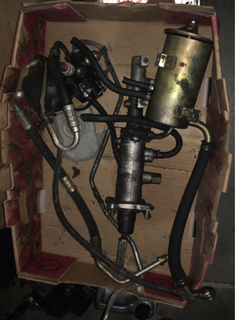

I'm collecting the bits to do the BMW hydro boost conversion right now, will be doing this sometime next year when I do my engine swap.
As my car is a RHD there is a bit more plumbing to be done, so engine out will be much easier.
