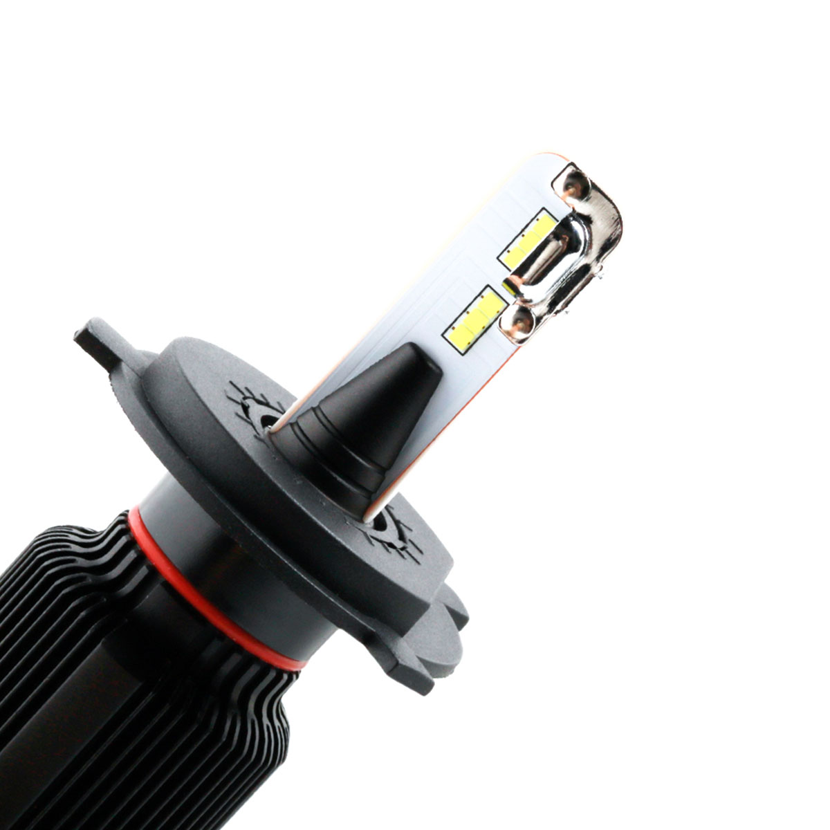

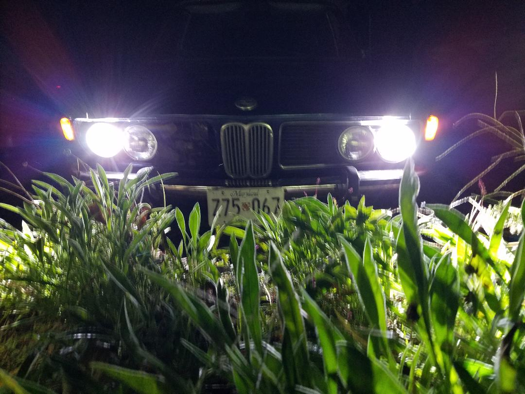

Yesterday I installed my LED headlights, a complete setup. This was a plug and play process. My old headlights were so bad I threw them away. One of the lenses of my old headlight fell off when I removed the headlight. Once I was blind now I can see. I turned the new ones on while it was still daylight and I could see some light on the ground. The light is cast down and to the right. So now I can see people walking in the street (we have no sidewalks) on the right.

Hey Bob, I just replaced the lights that's it no relays or harness less then 30 min work. Take grille out, take two screws out for headlight ring put new lights behind rind plug in connector, put screws back, put grille back, turn on lights, done. LED's draw less current, put out less heat. I also took the time to clean my grilles and light rings.
