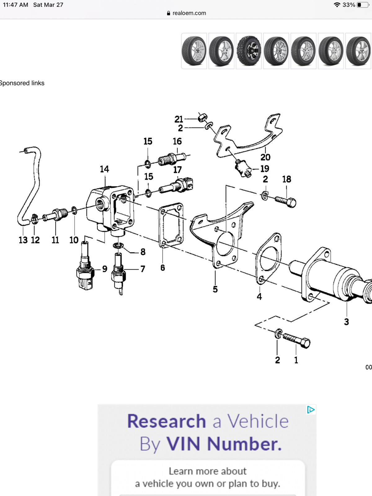

Which sensor are you disconnecting?
At the thermostat or at side of block?
If side of block - which one? #7 or number #9?
If side of block one is cold start sensor

Disconnecting the one on the thermostat housing. The one with the fancy connector and not the single barb one that goes to the gauge - number 8 in the diagram.
TPS part number is the same as what was on the car - 0 280 120 206
Everybody can chastise me for using a rock auto part - I probably deserve it- but I was in a hurry to get it back on the road and I'm on the east coast. So the coolant temp sensor is this one:
https://www.rockauto.com/en/moreinfo.php?pk=40586&cc=1012217&jsn=17&jsn=17 It is exhibiting the same behavior as it was with the old one when I disconnect it.
I just tried to cross reference the part number from real oem - 13621362599 and see that the one I have doesn't match up. So, is that the likely culprit at this point? I should have done my homework. Still a problem all these years later...
Ummmm number 8 is a crush washer in the diagram.

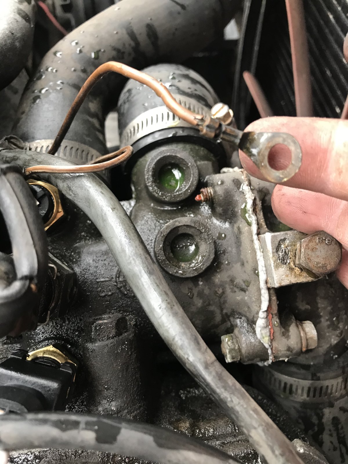

Got a pic?
Sorry. Meant number 9.

I do have a ground that is going to nothing? Pic coming.
Grounds must be connected- especially that one.
The temp sender (black) does not belong in this car.
disconnect number 9- it is making your cold start injector run continuously
