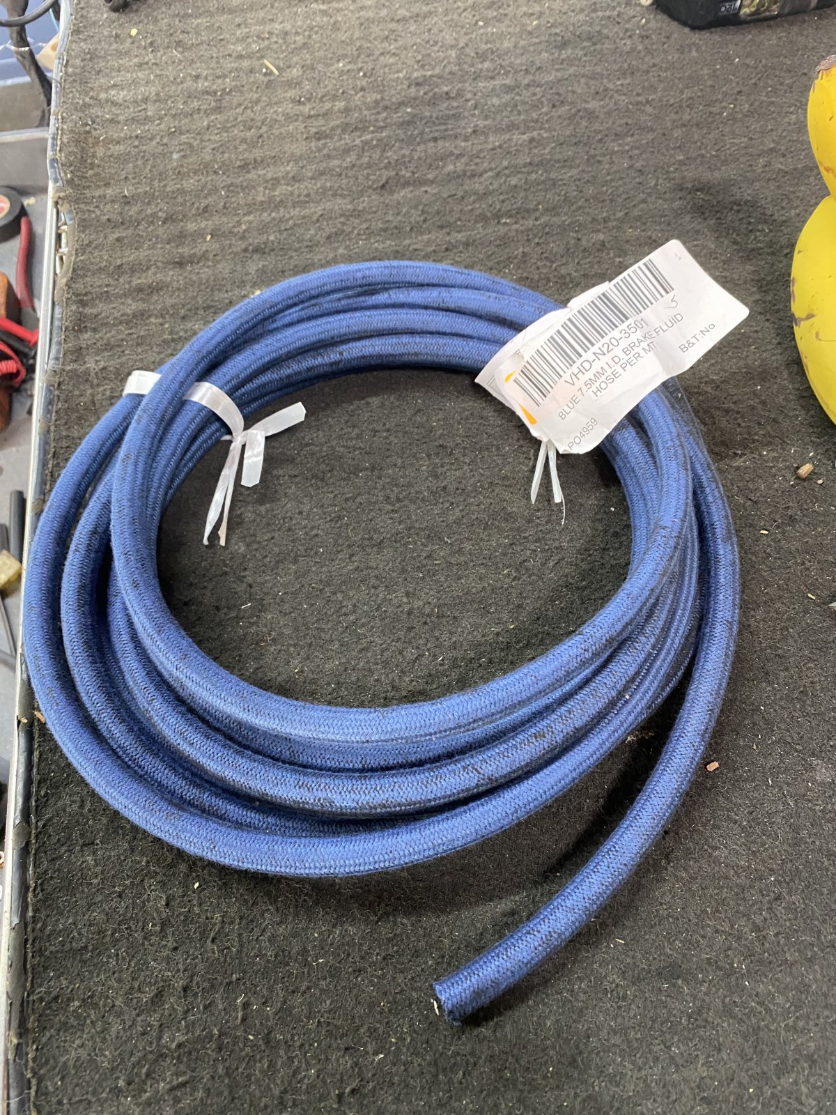

I tried the VHD blue brake hose......
sfdon
10,115
6,957
sfbay area
Don't like it. Wrong color and a PITA to get on the fittings.
I have 20' available for 5.00 foot.
LMK
I tried some tubing that looks just like this sourced from a vw specialist company, advertised as brake fluid hose. The rubber (?) under the cloth was black, and within a month my brake fluid (dot 4) was black also. Did a 2002 as well unfortunately, with the same result. Went back to the w&n hose and it has stayed clean.
