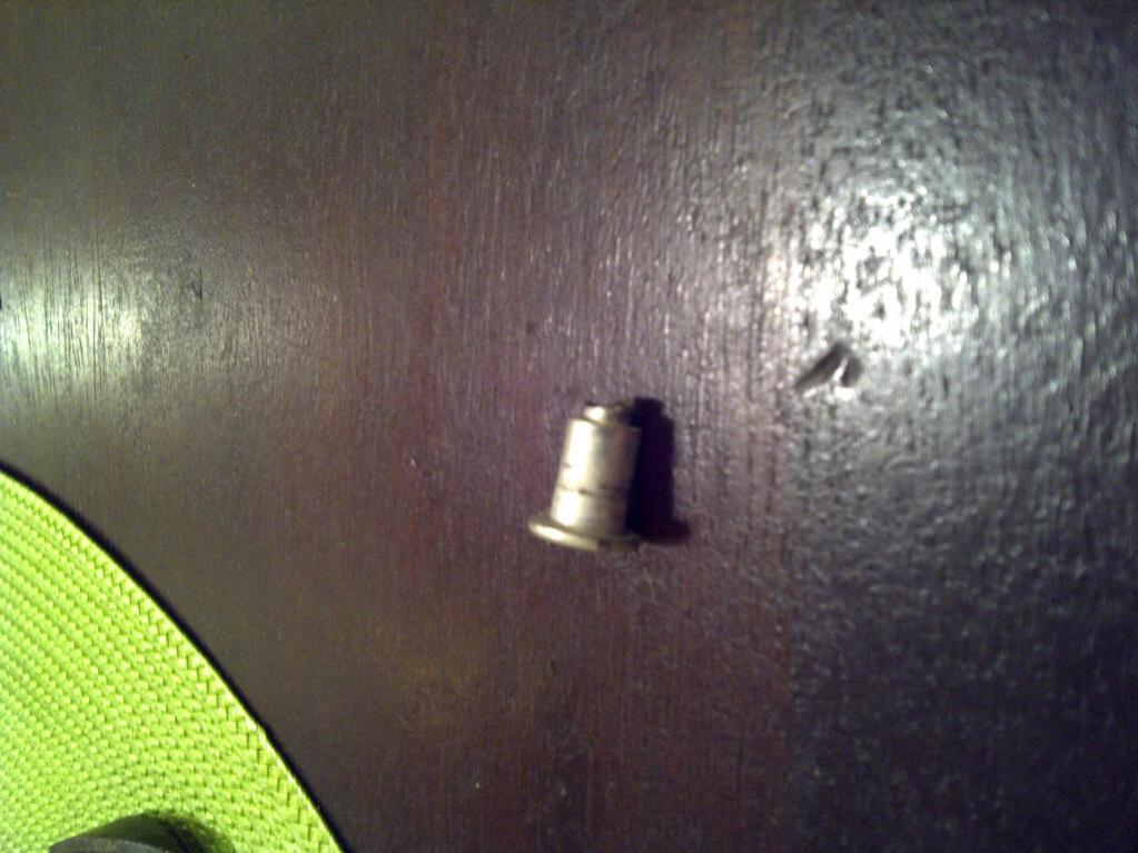

Is there a source for these rivets?
Is there a source for these flat head type rivets/sleeves that act as bearings for the lid supports - they have a flat head which fist flush to the side of the tray and barrel shape for the bearing then a short piece at the end which is crushed to hold it in. What are these called and is there a source for this part? If not what should I use? Also, are the other pop rivets available that hold the hinges together available? Thanks.
