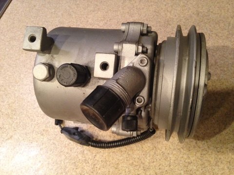

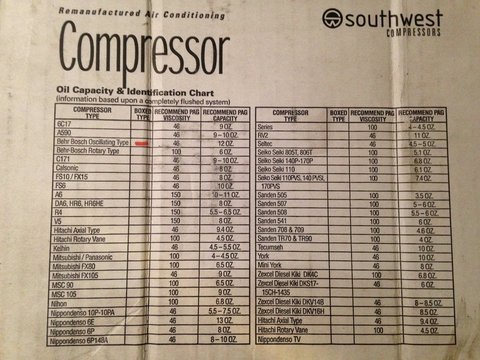

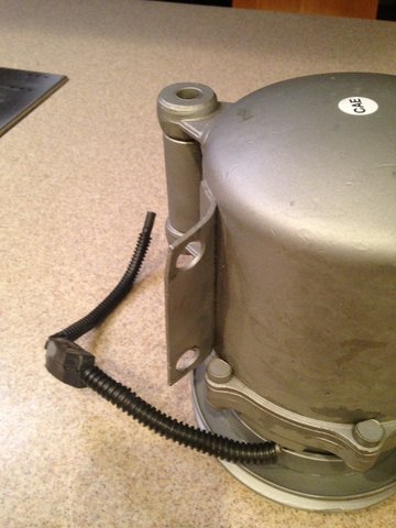

Identity this AC compressor?
twistinglane
677
25
Maryland
Is this compressor of utility for an e9? If so are needed brackets available?
Just started to research this stuff - but a little searching convinced me it is complicated...

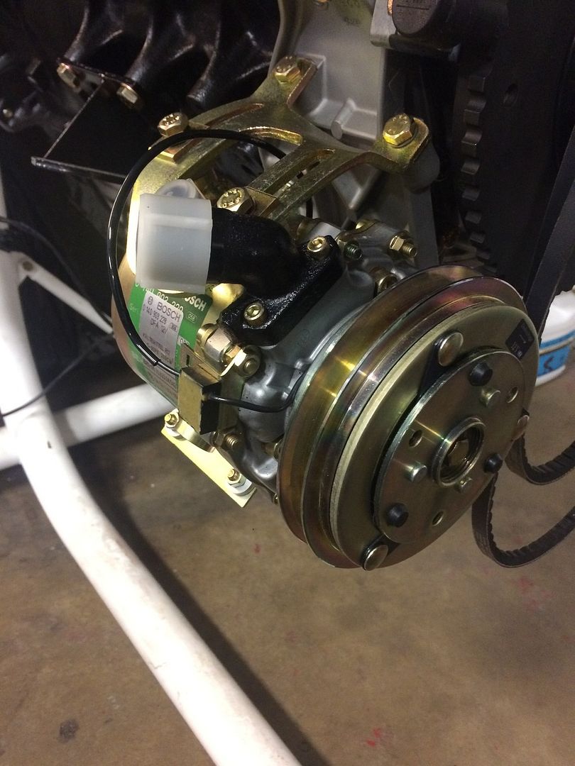

Here is what you need for this compressor:
Bosch compressor (wing w/ square top ears) 64.52.1.374.558
Bracket (bottom e24 633i) 64.52.1.268.277
Bracket (top adj. bar)) 64.52.1.273.925
Support 64.52.1.276.623
Square washers 64.52.1.276.354 (qty 2)
There are sliders for the mounting bracket where the bolts go through. Make sure you have the correct bracket to the block. I believe this set up was found on the '83-'84 533i the 633csi and the 733i. Jim at Mesa Performance knows what parts you will need. They are all available.
