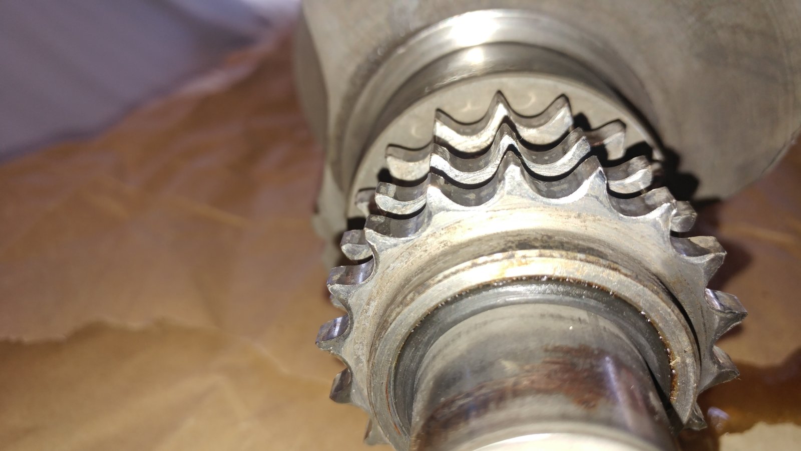

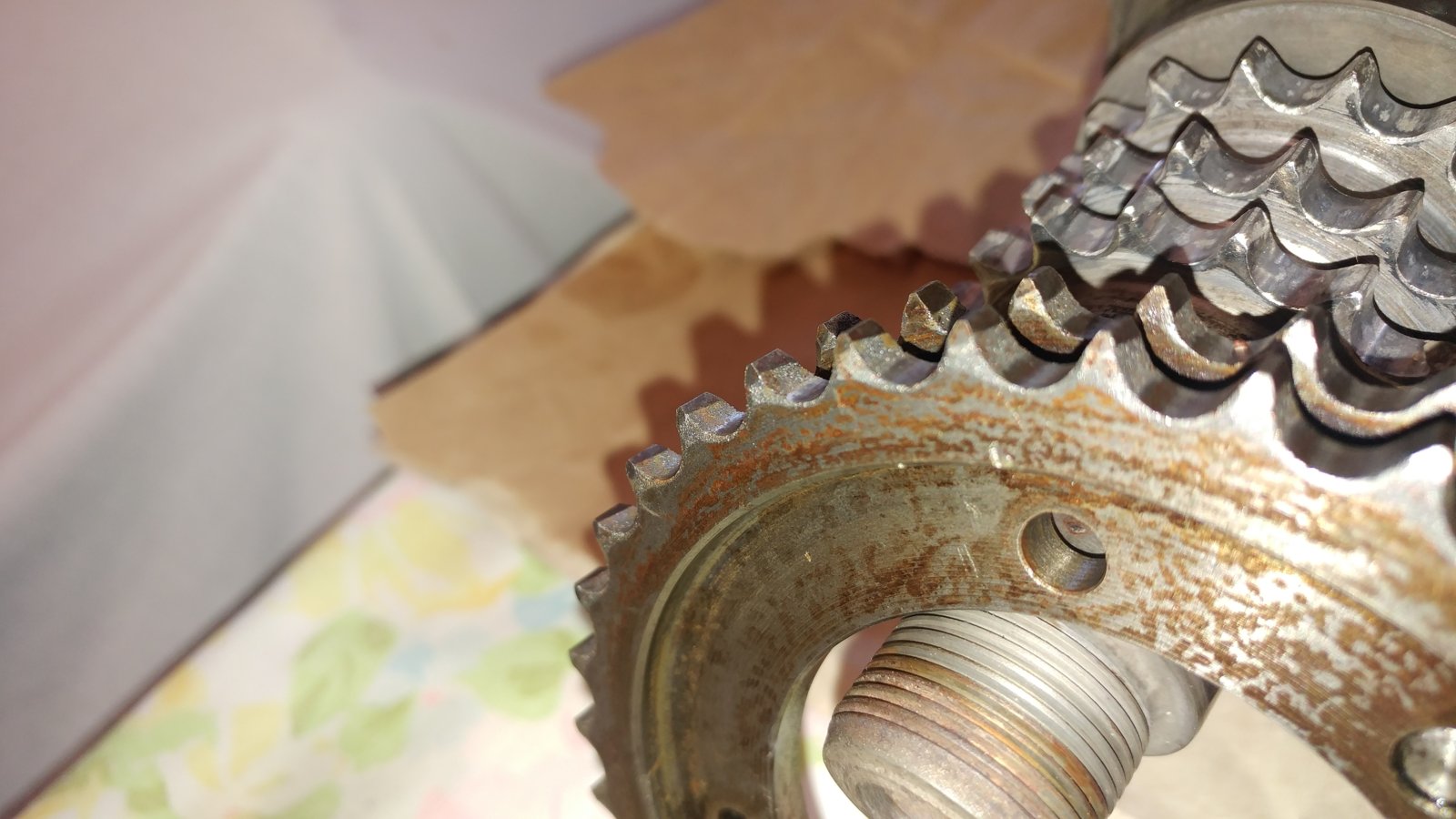

Here are a couple of photos taken today. There are still distinct, albeit small flat spots on the crank sprocket and the same on the cam sprocket. I'm inclinded to say they will be ok. Car will not be driven high more like it was before I got it.
Comments?
Comments?

I would use those without worrying about any problems.
Very little wear.
Thanks for the photos. Definitely takes the subjectivity out of it.
Very little wear.

THANKS for the direction. Yes they don't look bad.
