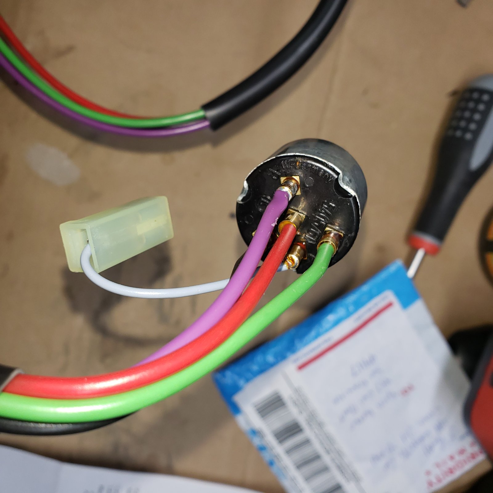

As one pic worth more than thousands words...
Here are some pics of the lock tube and the back of key lock barrel.

This particular part is from E23, but it was the same over decades as far as I know (E3, E9, E21, E28, early E23/E24).
I bought it as I would probably need to replace it (most of locks in my E9 are being damaged or blocked by dirt and rust). :(
To slide the lock barrel off from the metal holder ....
There is s a hole (~2-3mm) about 1/2" from the edge (key side), being in-line with the key surface edge when it is in OFF position.
You need to push it by some pin and gently pull the lock barrel out.
@Wladek also talked about it on one of lock threads.
I'm not sure if it is possible once all installed in the steering column.
Interesting is, you do not need to have the key in the barrel (to pull it out).
Just use the edge of the barrel (fixing the black plastic trim around the lock), grab by finger/nails or flat screwdriver. I would use nails or plastic tool to avoid scratching decorative chrome around the lock.

And be aware that the cam looking disc in this pic needs to sit behind that small hidden post in the lower right corner when reinserting the lock barrel into the cylinder or you can’t get it to engage the starter. I had this problem in my e12 and the parts are identical.
