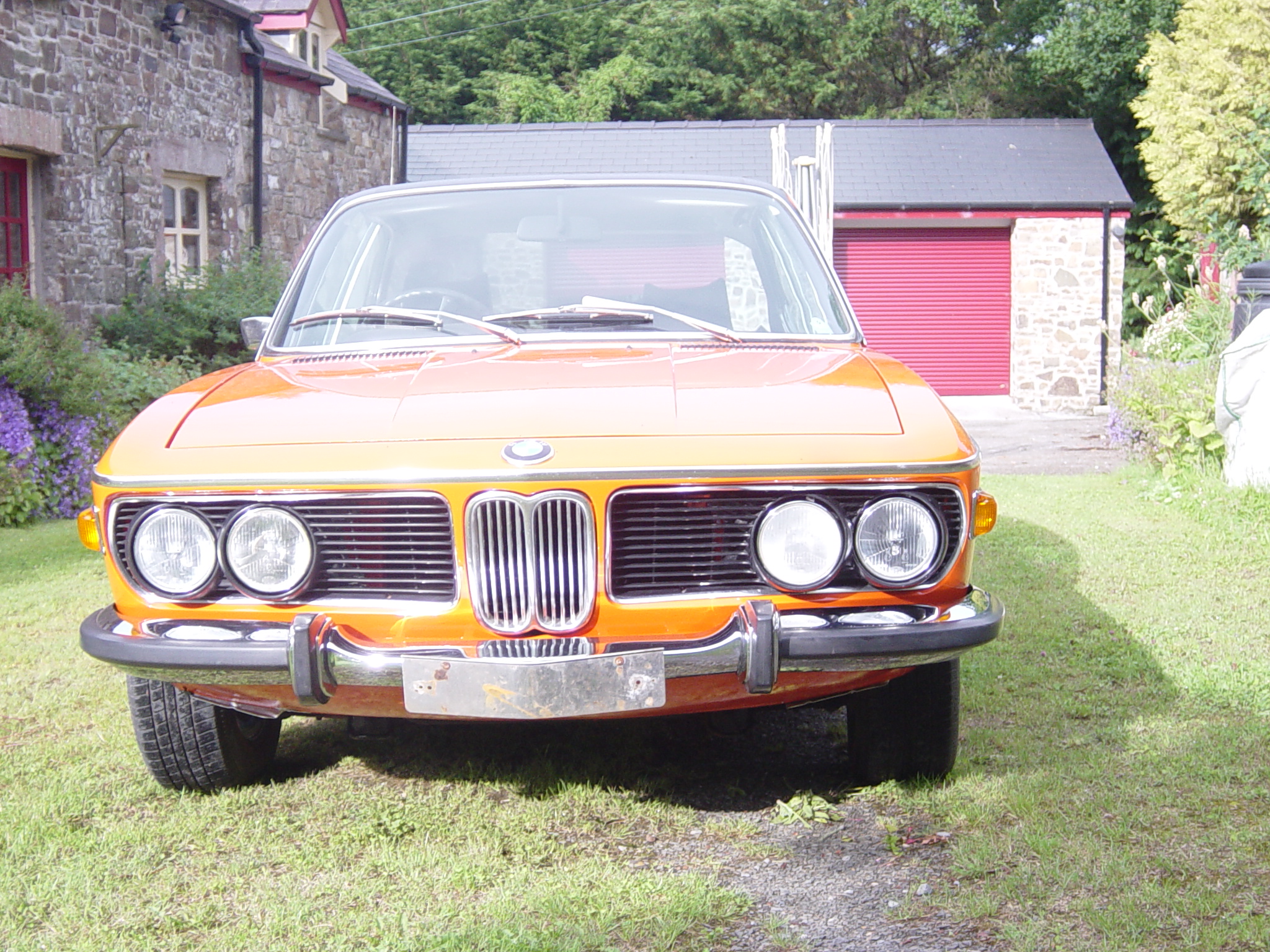

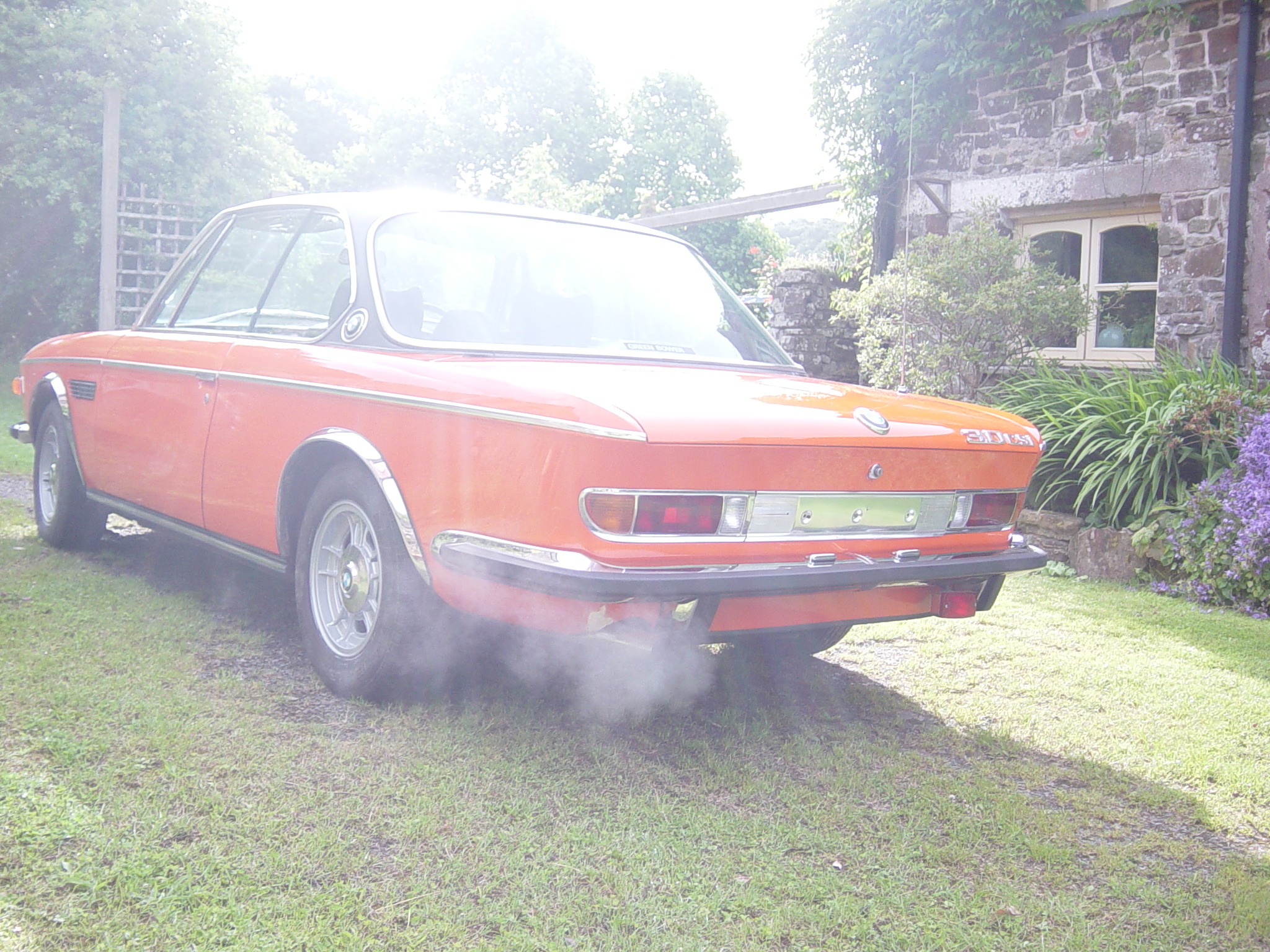

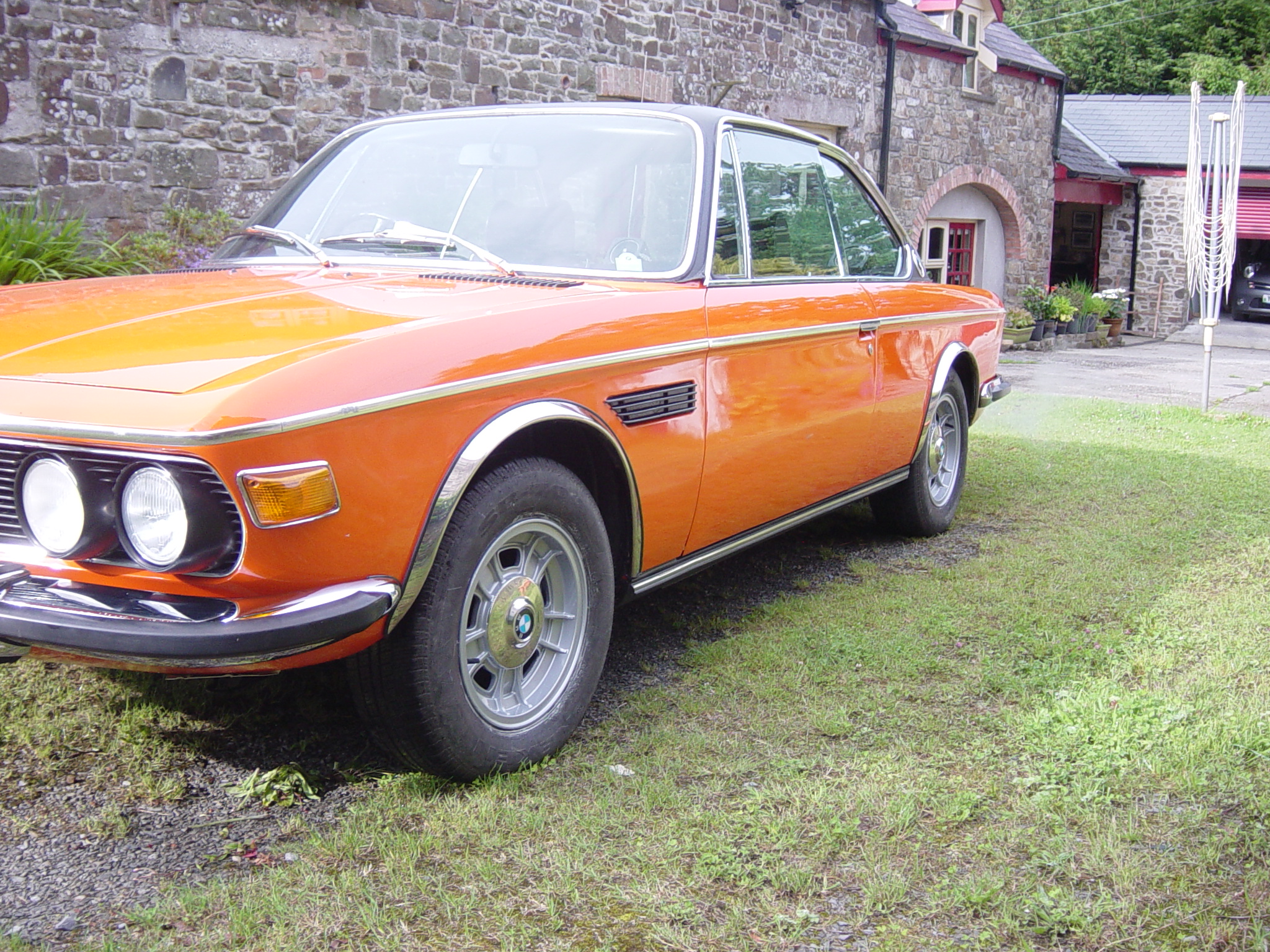

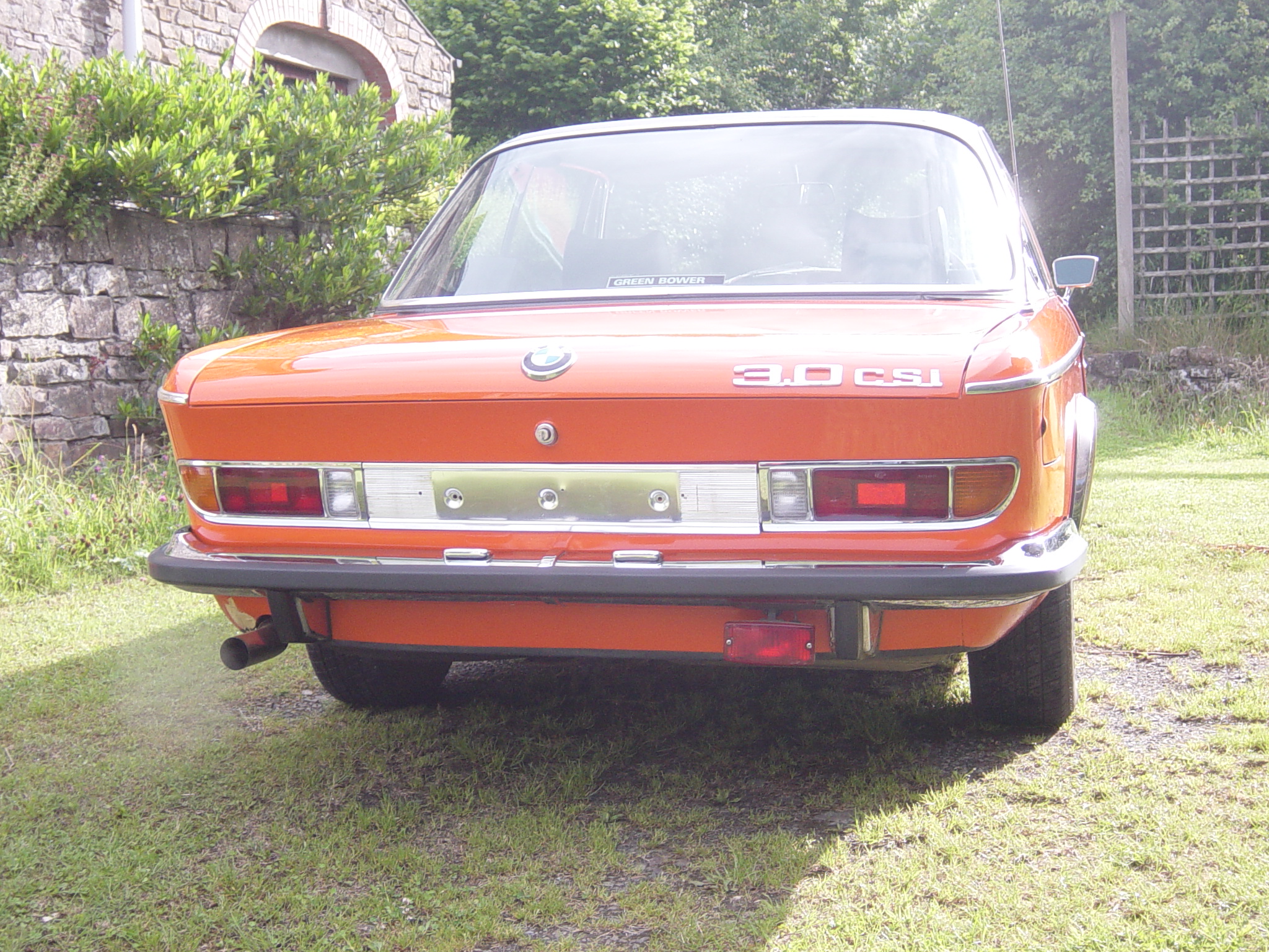

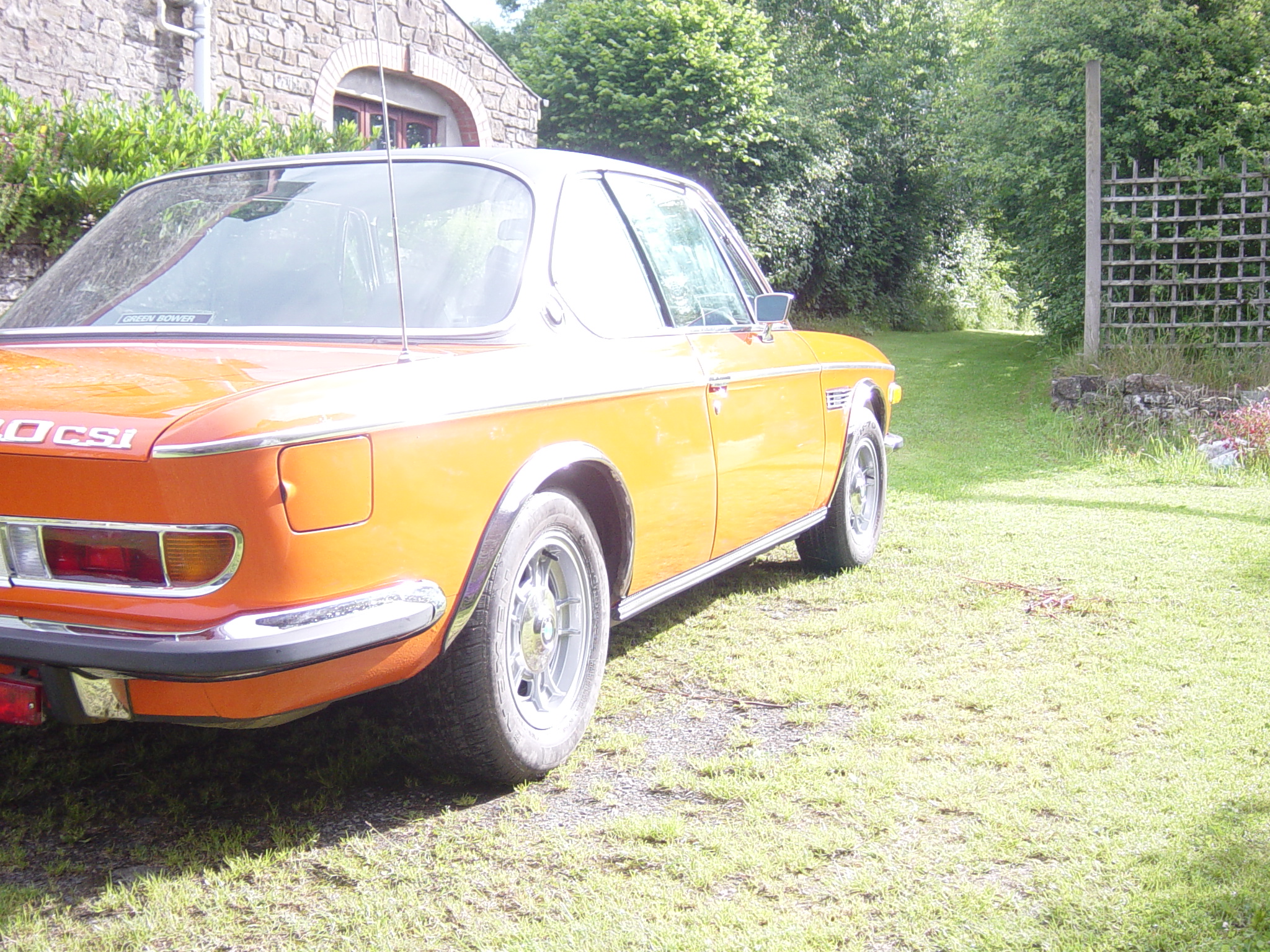

Have added some recent pics. of the car which has covered 49000 miles and has full BMWSH from supplying dealership.
