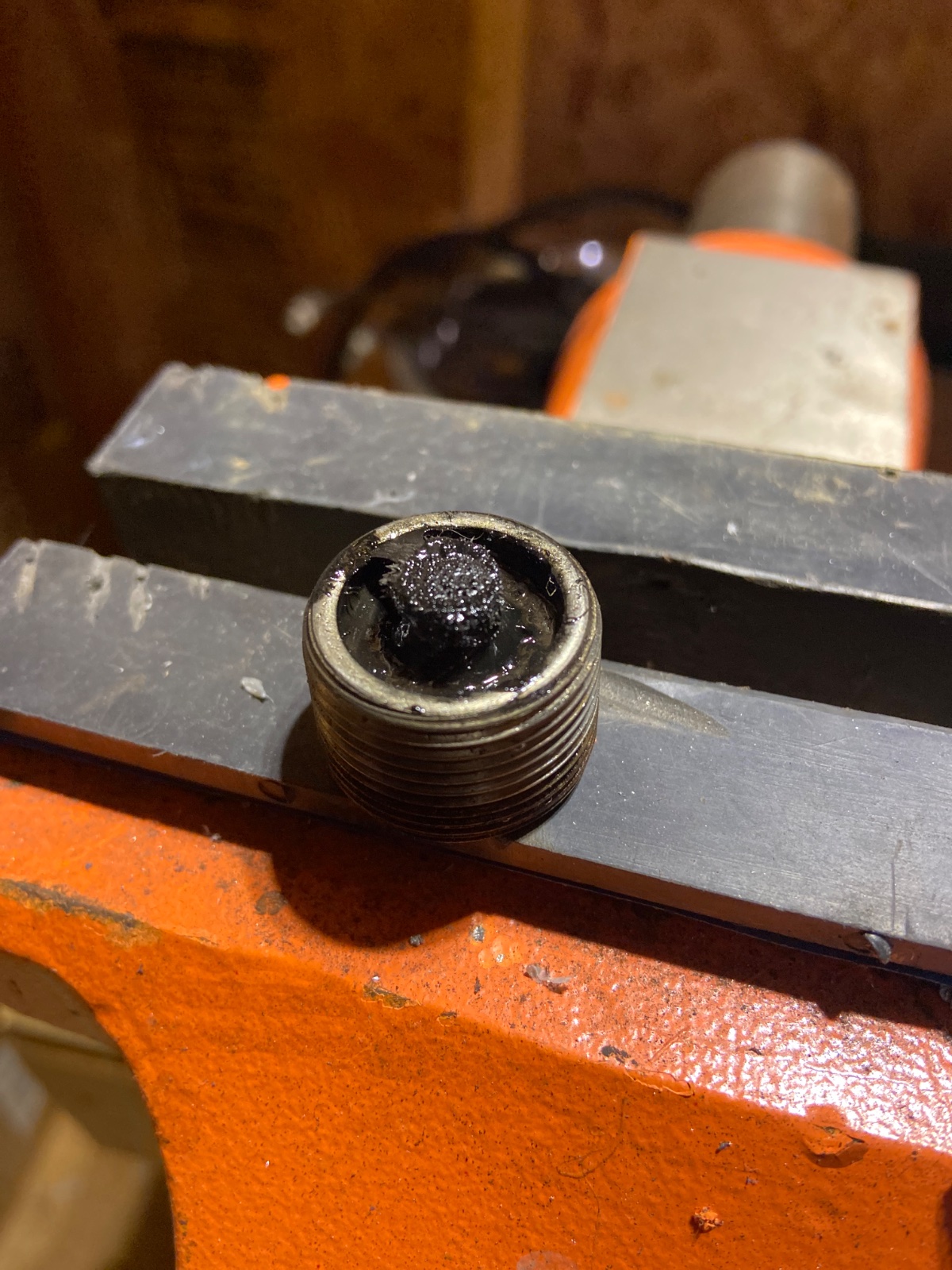

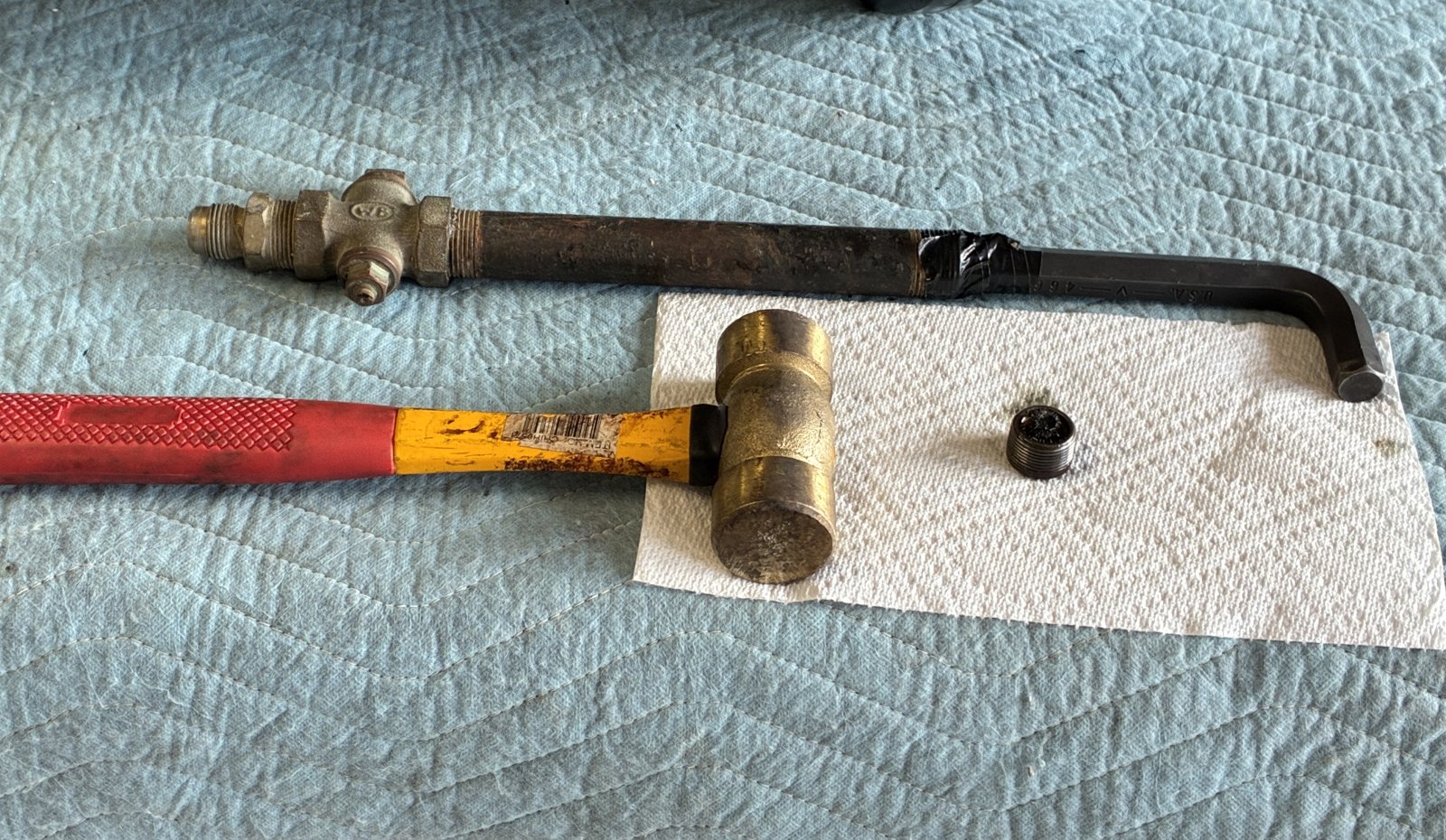

Yesterday, I went about changing the oil fluids (engine, trans, differential) on my new classic car. BMW has had a love affair with Allen keys on their drain plugs for decades. Naturally, the 19mm Allen plugs I needed to loosen were stuck like they were welded on. That tells me the oil hadn't been changed in a long time or someone with Schwarzenegger arms tightened them.
I first used a hammer, difficult as that is when lying on your back under the car with your arms folded and trying to hold the Allen key straight with one hand while swinging a hammer in limited space with the other. Not fun. Then, I used a makeshift pry bar using 3/4" pipe that the Allen key end fit into. After a few tries that finally worked.

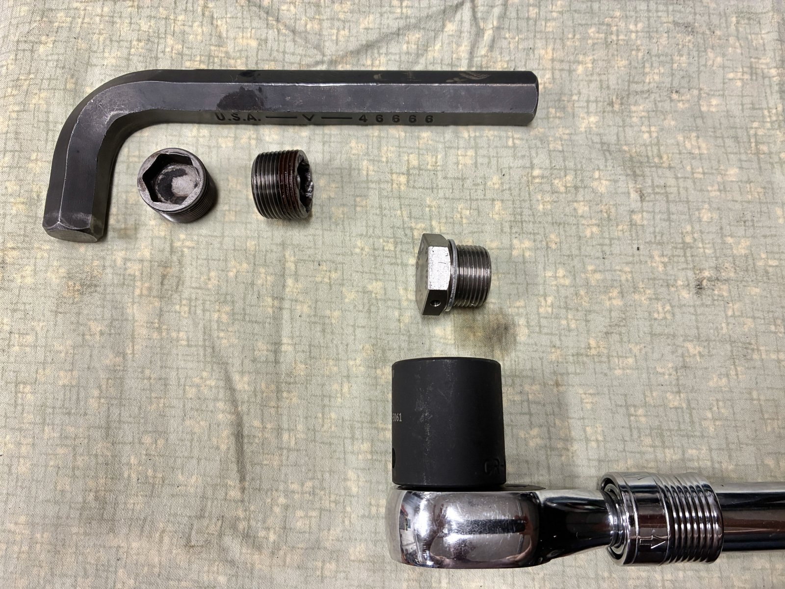

So... Allen key? You're out! Finished! Excommunicated! Deported! Hex head plug... we're lifelong partners.
