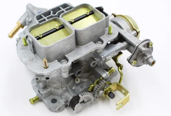

I'm not mechanical in the least but wanted to increase the idle a bit on my 1971 2800cs (upgraded to a 3.5 engine from a 1989 535i). When the engine is warm, it's idling at around 300 and feels like it will stall. It has dua Weber carburetors if that helps. Can anyone provide instructions? I'd like to get it up to 650 rpms in neutral. Thanks in advance.
You’ll need a synchronmeter to make sure both carbs are breathing the same amount of air. Also an rpm gauge, the one in the dash is not reliable or can show small changes.
Basically:
1. Check condition of vacuum hoses and for leaks at the base and distributor if running advance and/or retard.
2. On each carb, screw the mixture screw clockwise until the rpms drop then back it out until the rpm stops increasing. Then out another 1/8 turn. This may end up increasing your idle speed depending on your state of tune.
3. Each carb also has a throttle plate adjustment screw. Get a reading on the synchronmeter for each carb and if the idle rpm is still below 650 (this seems low-do you have an auto transmission?) then turn the throttle screw in on the lower breathing carb till it matches the other and the rpm increases. Repeat this process until both carbs are pulling the same air at the desired rpm. If pulling same amount of air but still too low (high) on rpm then increase (decrease) them equally.
4. Final adjustments are made with the mixture screw adjustments repeating step 2. If this results in a higher or lower desired rpm then repeat steps 3 and 4 until finished. Mixture is always the final adjustment.
Found a terrific mechanic in my new home state of Colorado who adjusted the carburetors for me last Sunday. Great guy if anyone is looking for a mechanic in the Denver metropolitan area.
