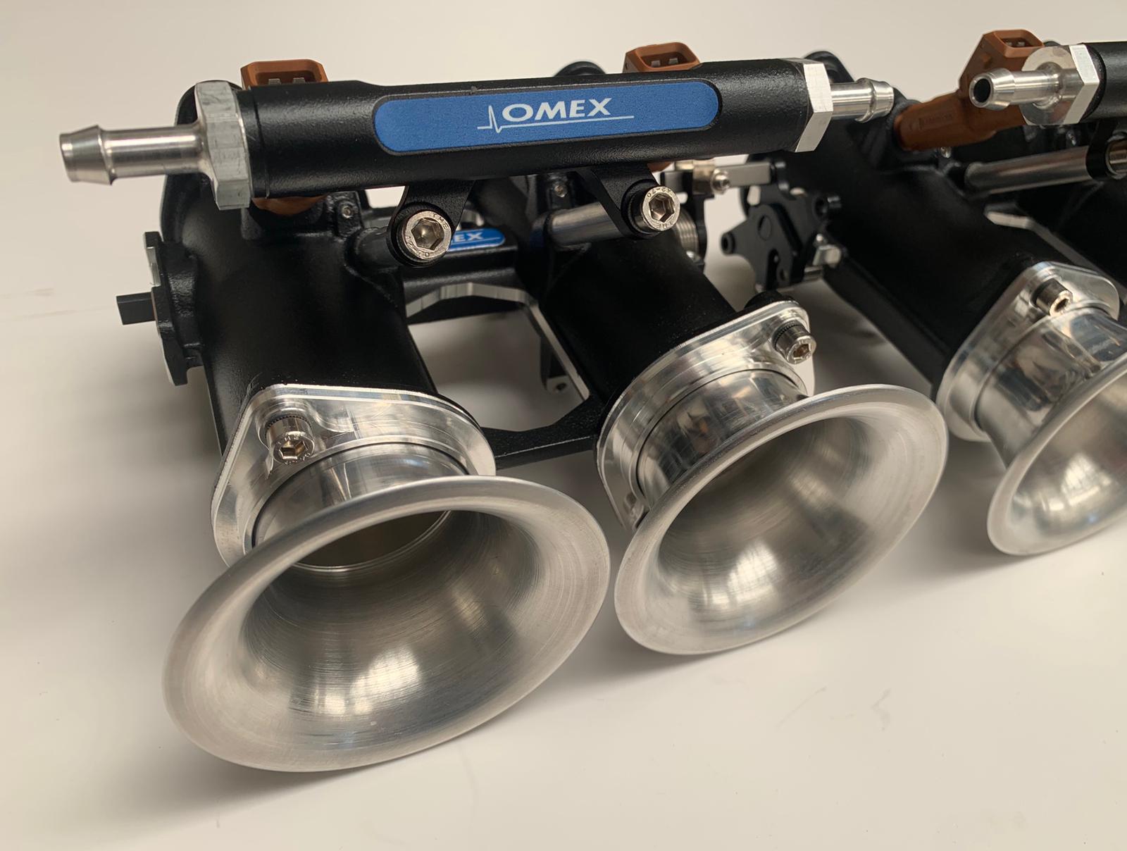

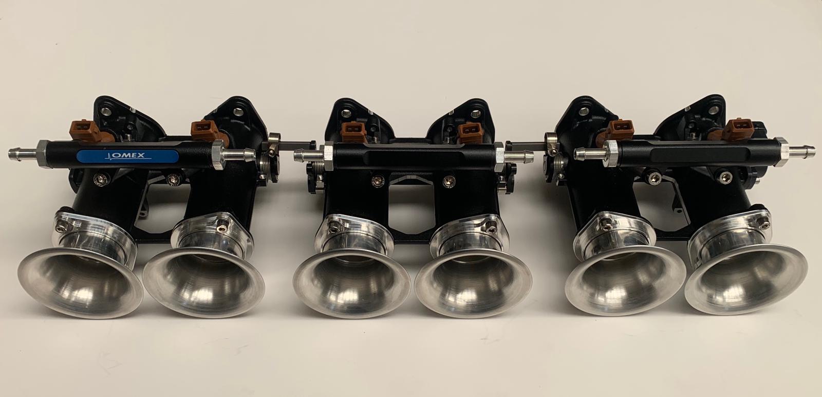

Those look real sexy, what engine are you fitting them to?

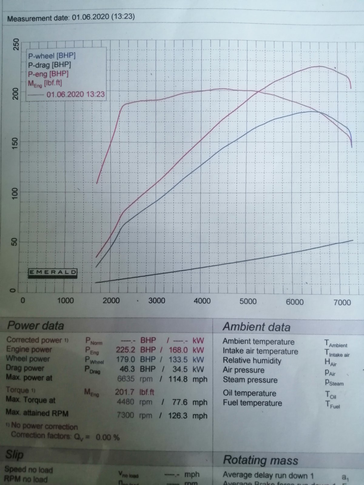

My throttle bodies are actually 2 2nd hand sets from a Triumph 959 motorcycle. They (used to) go for peanuts on Ebay, the 2 sets cost me around £90. I had to have an adapter plate made up to fit them to the engine. The engine management system I bought is an emerald M3D. Its a nice ecu with lots of features one of which is that is is possible to have 3 different maps so I have chosen to have a full power map an economy map and a valet map which limits rpm to 3000 should I ever need to leave the car with someone.
The economy map got me home 168 miles at an average of 32.2 mpg at 60 mph so I'm well pleased with that as it means going on trips or to shows won't be such a big hit in the wallet.

It’s the original engine for my CSL, Just building it backup, Cylinder head has been CNC ported,New Pistons, Cam etc etc
