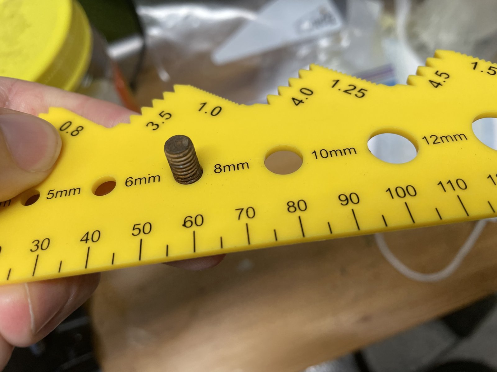

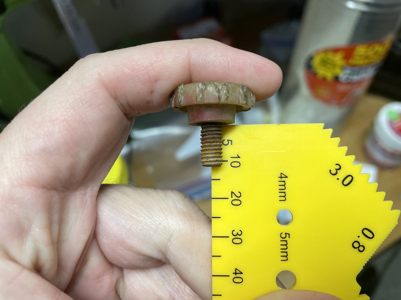

BTW ... Does anyone know the length (underneath the plastic knob) and thread size of the screws?

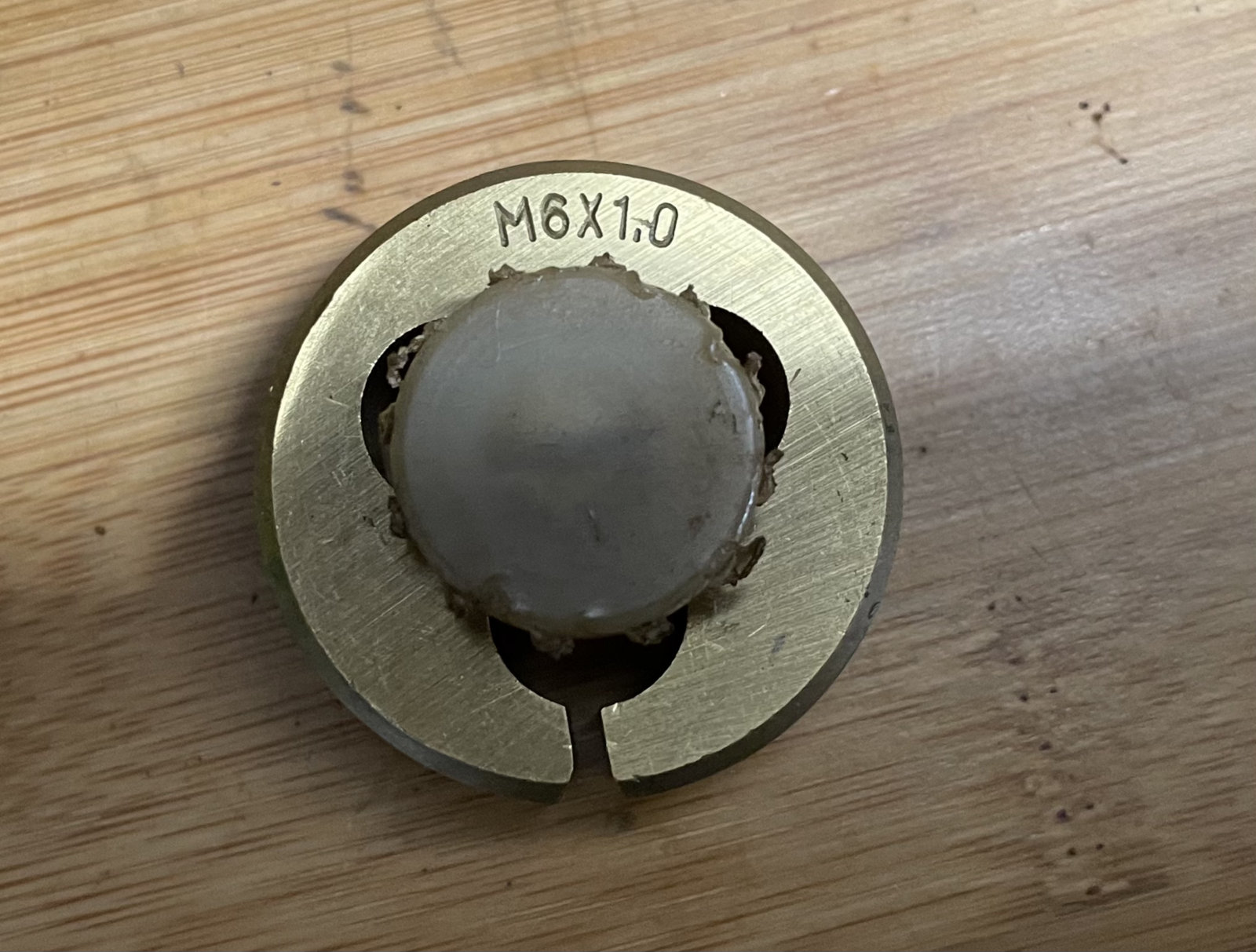

Cant really use the thread gauge when the screw is that short. I measured 1.25 with my calipers, or at least “not 1.5”...
edit: pitch is 1.0

Getting back to the thumb screws, I struggle with 1.25 pitch in general. 1.0 is obvious as is 1.5. 1.25 looks closer to 1.5 than 1.0. I’ll grab my 1.25 die and ensure that the pitch is correct.
