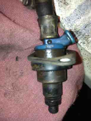

Hi everyone. I am inching toward rebuilding my intake manifold/fuel rail. The intake in question is off a 1975 CSI. The present injectors look like this

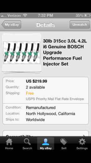

And I am considering purchasing these
What do you folks have to say about that decision?

Rebuild 40 year old injectors?
Never for me. Too fragile, too beat.
Buy re-manufactured injectors from a mystery company in LA? From an ad without a part number?
No.
Did you have another option?
I would definitely try and replace them. I did so last year and from memory you need to get the flow and resistance right as long as the body is the same profile to utilise the existing clamps. I went for slightly higher flow injectors and bought them NOS on ebay.
