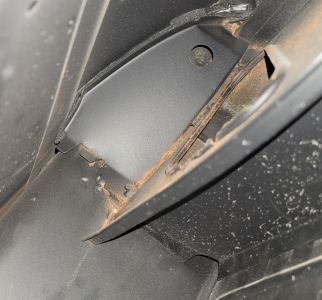

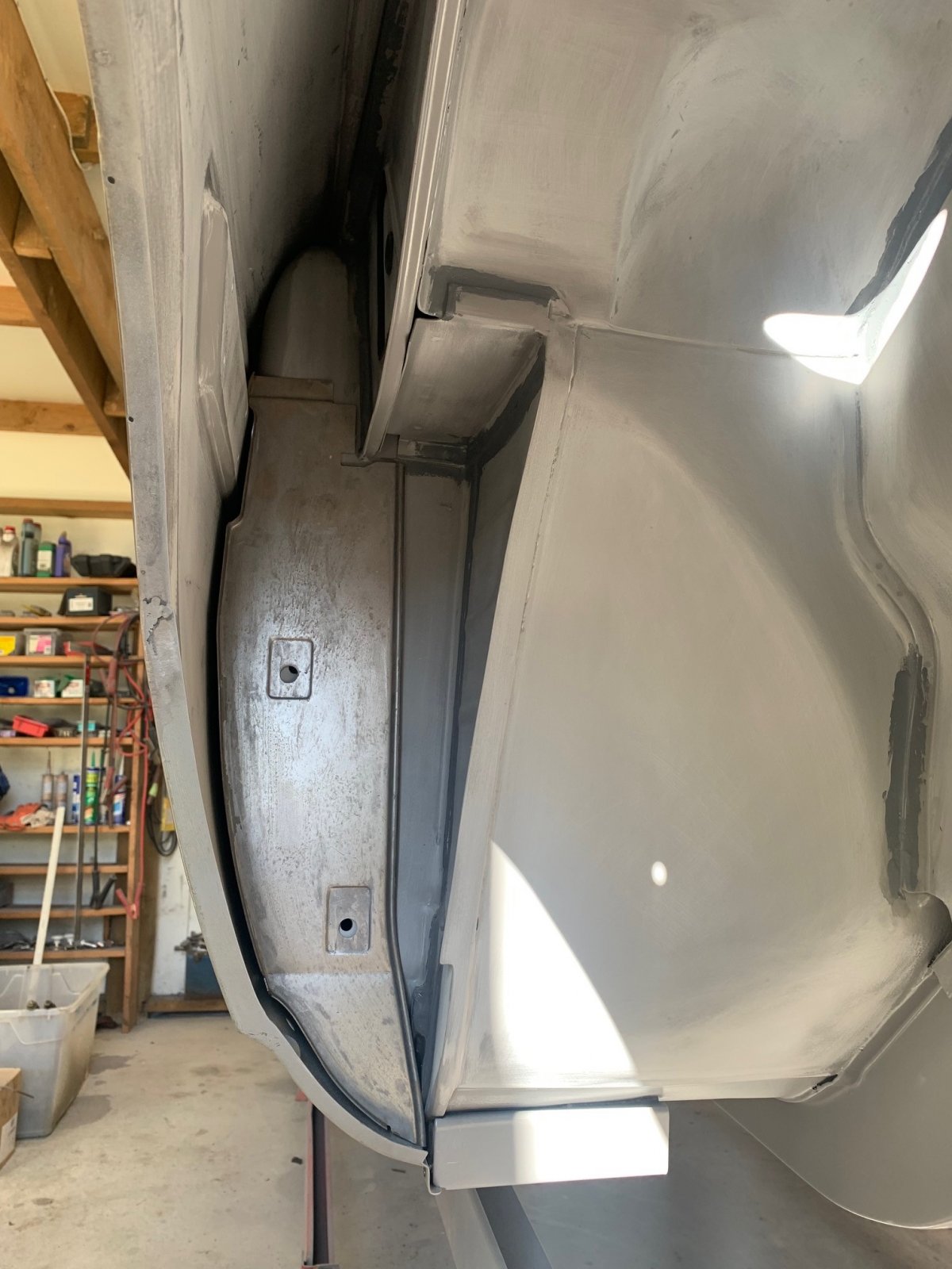

Hi everyone,

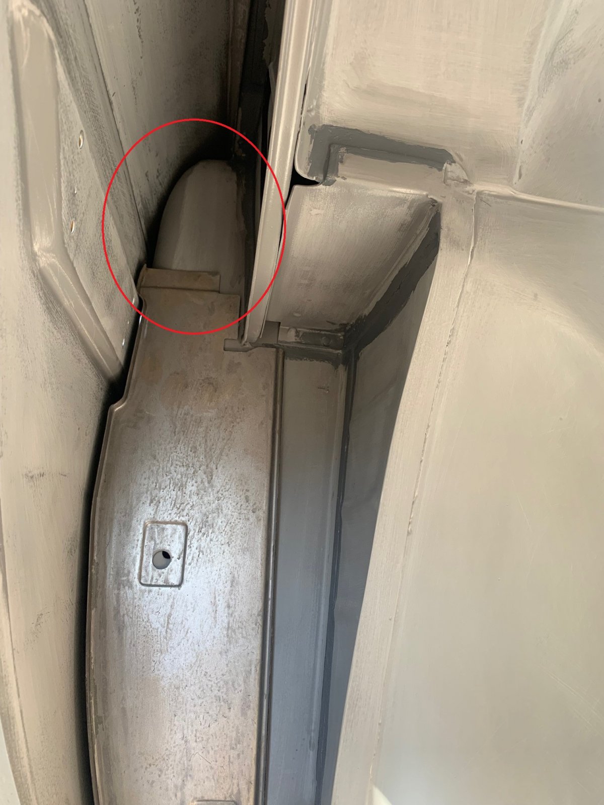

We're about to fit the front wheel arch cover plate, per this photo. However there is an obvious gap above this cover where it appears another cover should be. Otherwise dirt & muck etc will end up in there.
Does anyone have a photo please of how it should look?
Correct. The upper piece is welded in and has the tab for the for the bolt-on piece to slide under.
