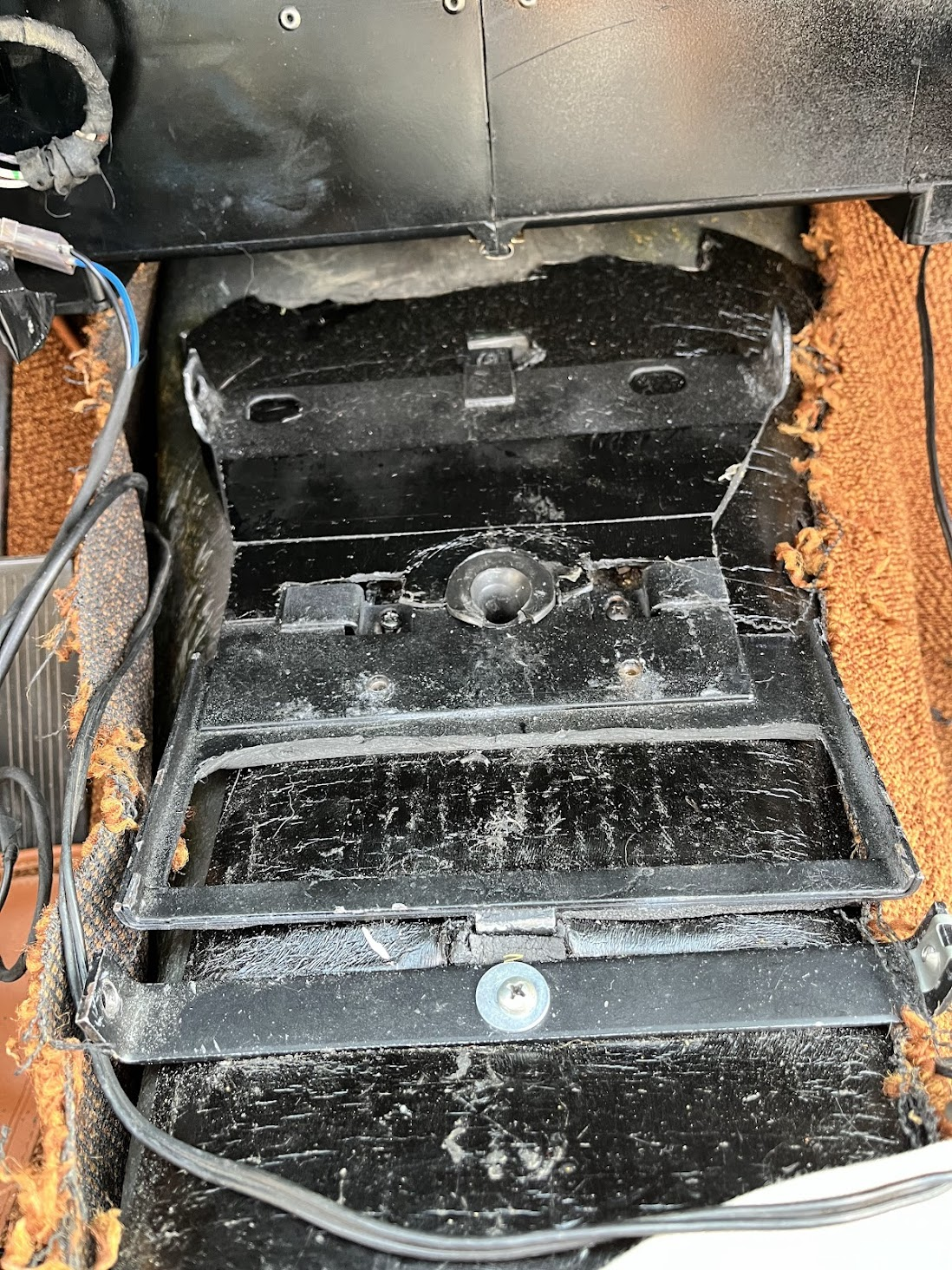

The AC box sits on a base plate bolted to the transmission tunnel.

AC base plate:

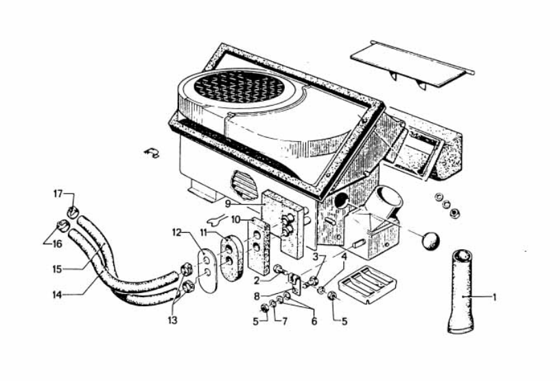

next question, realoem shows 2 pieces of insulation around the heater pipes at the firewall. one is L shaped and the other is rectangular. then there is a racetrack oval shaped piece under the metal cover in the engine compartment. both 9 + 10 have the same part number on realoem ... the orange book shows 2 separate pieces. but here's the weird part - there are 3 #10s in the orange book where realoem shows 1 - perhaps it was a thickness thing. so i imagine i will install the bigger L shaped piece and cut the other piece down to a rectangle ... using the leftover piece to make the oval insulation on the other side of the firewall.
make sense? any thoughts?

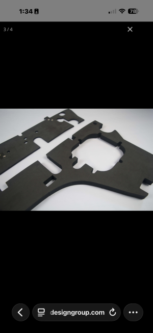

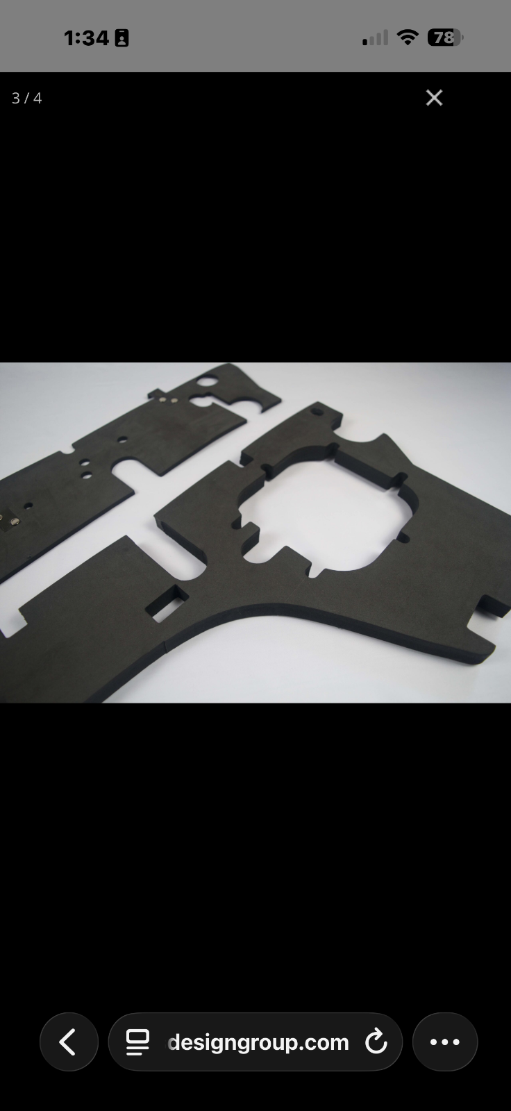

I think part of the answer depends on what you are using for your firewall insulation. I think I used the one from Alprado, which is fairly thick (see photo) and included just an oval-shaped cutout, so I just put a small piece of foam and the metal oval plate. There is no way I could have fit that many layers into the narrow space. If you had a thinner firewall material then you could potentially fit some more thickness in there, I imagine mainly just to insulate the area of most heat exposure.

i think what happens here is - the insulation around the pipes (inside the engine compartment) goes on top of the firewall insulation / under the metal cover - this is the racetrack shape .... it is held tight around the pipes by the heater hoses pushing the metal cover as tight as possible into the firewall. the L shaped and rectangular go inside the car around the pipes (between the firewall and the heater). this helps for heat soak around the drivers feet.

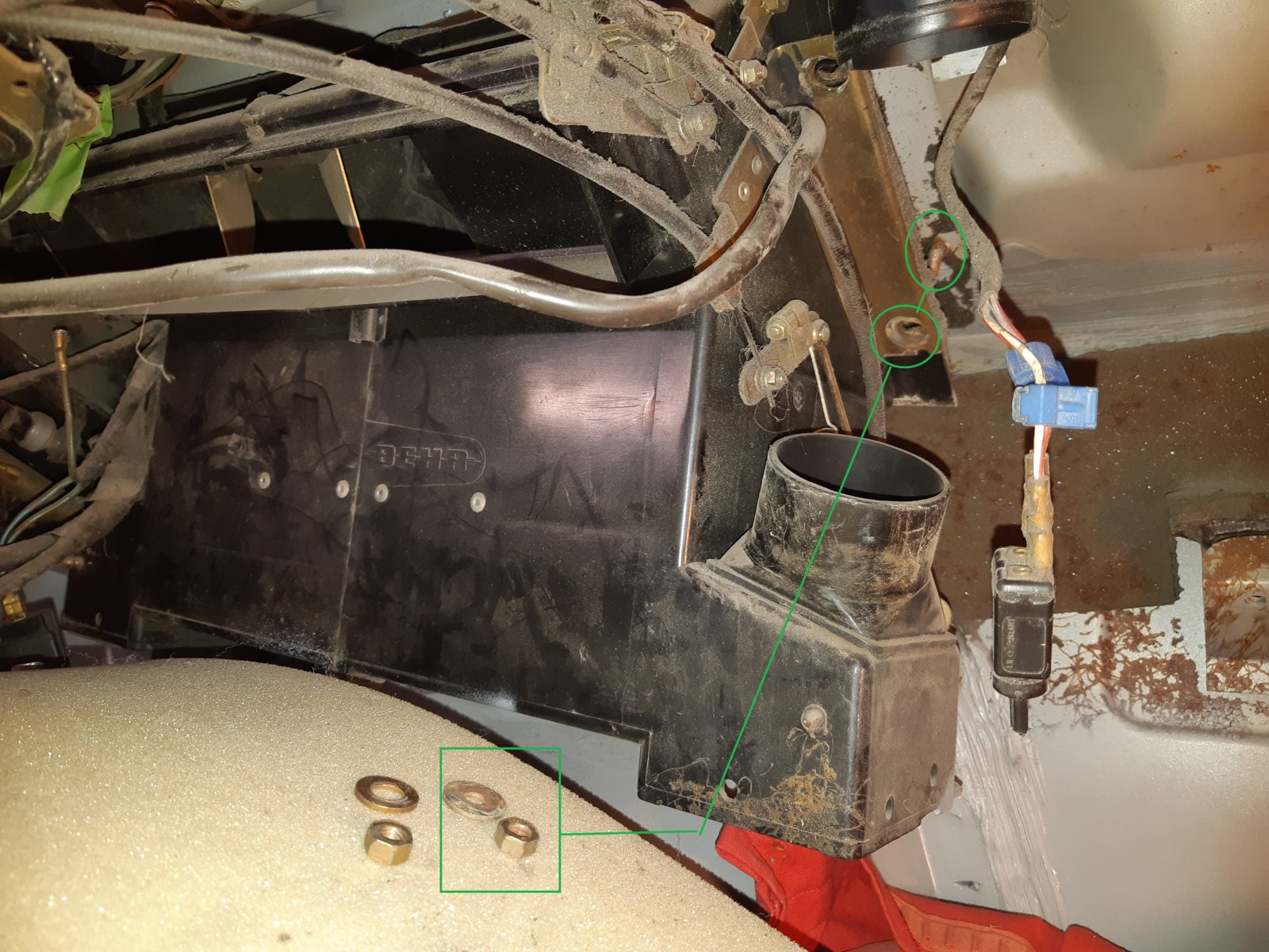

here is a quick update on the initial question - adhesive side up / adhesive side on the heater? i started with it up and the adhesive didn't really keep it there. after it fell while putting the heater into place, i put it on top of the heater ... and i got it on, but i still have to loosen up the heater and push the insulation back into place. i will tell you, getting the heater into place to get the washers / nuts into place ... PITA. i found that having a couple of blocks of wood on top of the tranny tunnel to wedge the heater into place while trying to get the nuts into place. keeping the washers in place while trying to install the nuts is tedious as there isn't a lot of room to manipulate tools / fingers.
Confirmed on all points Scott.
The round small piece goes on the firewall in the engine bay and is held in place by the metal cover and the pipes.
The L-piece sits on the heather box and goes towards the firewall from the inside.
The rectangular frame sits on the upper frame that goes into the upper body cavity with the 4 studs.
